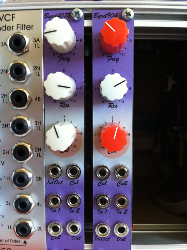

I know this is madness, but I had to squeeze both the 4072 and the Moog Filter into the 4HP Eurorack format:
By the way: It is really easy to achieve a good 1v/oct tracking with the Moog Filter. In self-oscillation you can play beautiful flute-like melodies.
And yes: it's running on +/-12V cheers

PostPosted: Tue Oct 11, 2011 7:54 am    Post subject: Reply with quote  Mark this post and the followings unread
Nice and colorful modules

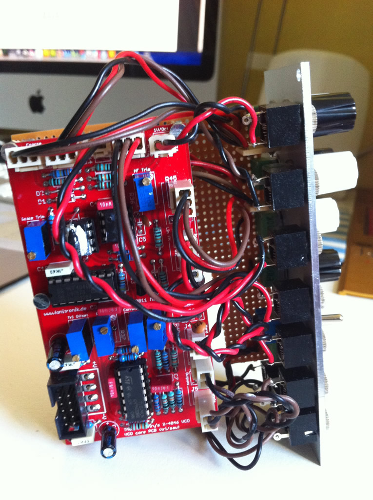

Great job, hv0190! I can't wait to get my kit and my panel.
Let me ask you this: how did you mount the PCBs in 4HP? Would you mind taking a picture of the back?

PostPosted: Tue Oct 11, 2011 11:33 am    Post subject: Reply with quote  Mark this post and the followings unread
Thanks Glitched! Very Happy
As you can imagine it isn't that easy when the panels are not even 1 inch wide, so I simply solder the pots (9mm Alpha) to perfboard and then fix the PCB on the perfboard.
I haven't got any pix of the filters, but this one here shows what I did to the T. Henry/Fonitronik X-4046 VCO ...
Maybe when I am more confident when it comes to working with aluminum I'll try and make some made-to-measure pot brackets Embarassed

Thanks so much for sharing that. I always panel-mount my pots when I do a layout on perfboard, but this time I'm getting a "real" pcb from bridechamber.com, which doesn't have spots for pots, on-board.
I don't have the tools to make brackets, so I was a little confused as to what to do! Anyway, yeah, I like your idea of mounting smaller pots on a perfboard, then mounting the PCB to that. I'll probably end up doing something like that. Thanks for the idea!
