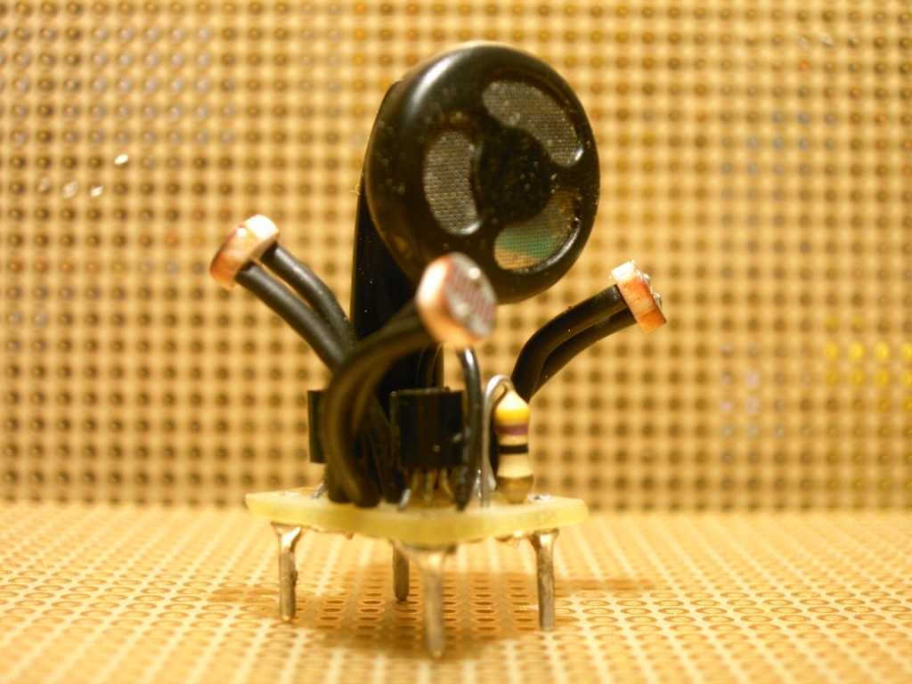

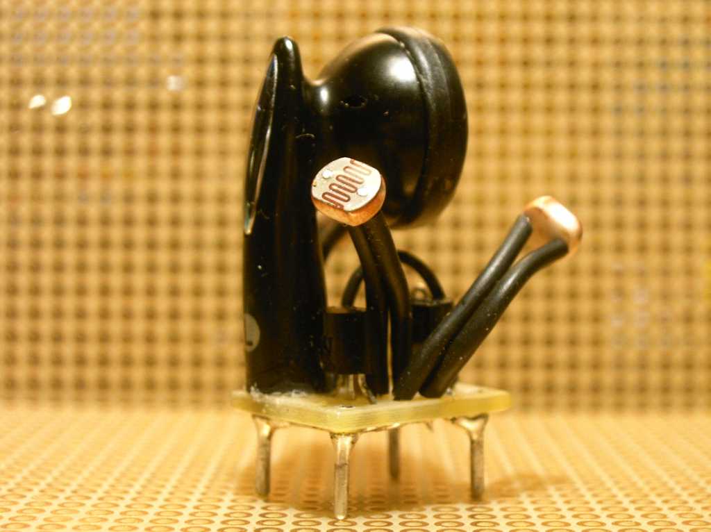

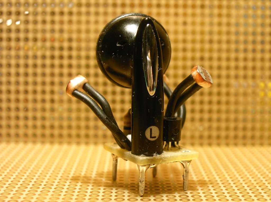

played a bit more with a 2 transistor AMV,
replaced resistors with LDR's, changed the circuit a bit and to my surprise I got it oscillating with 1 capacitor. Very Happy
didn't realize how small 30 holes actually was untill I cut the perf Shocked
the design was a bit trickier then I expected too,
but I managed to get it on there.
the 4 pins it stands on do have a function, 2 are for power, the other 2 are connected together and can be used
as a line out.
nice perferted challenge bubzy! Laughing

Well done! Looks good... like a little bunch of electronic mushrooms. Some sound recording would be nice Wink .
It does pretty much come down to transistors. There isn't room for an IC... unless you want to go opening the cases. Of course there is the option of making your own custom components if that is not cheating.
EDIT: also, there is a distinct advantage with perf. You don't need to sacrifice holes to make a break in the track.

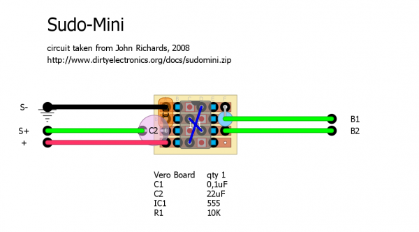

Possibly the ILC (International Lunettic Committee) will reject my entry because
- in two places a hole is used twice (the wires on AA and FB)
- one component (C2) is half-offboard
- the circuit is not my design, it is a Sudo-Mini by John Richards (http://www.dirtyelectronics.org/docs/sudomini.zip)
- I have not built and veryfied it yet.
But as it is about taking part, not about to win, here it is (24 holes): Smile

we may accept it, if you post some sound samples
bubzy (ilc)

No seriously, F*** the ILC! They are all Flat Earthers. Laughing
At 24 holes if you went down the perf route you could add another 4 and fit that cap on could you not? Although part of its charm is the cap hanging over the side.
