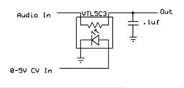

Here's my 'Two Simple Filter'. Parts count: 2. The NSL mp3 uses a NSL-32SR3 and other mp3 is using a VTL5C3. Lacking vactrols you can always use an LED and photocell. You can also put 2 vactrols in series, parallel and of course try different cap values, or use a rotary switch to switch between caps (increases parts count tremendously, though) Laughing
Sorta works like a VCA with no cap at all: Parts Count: 1
I only feed the CV input with positive voltages, like an envelope and haven't blown up a vactrol yet.

Hey Dr. Vague,
NICE! I think you win the prize for Simplest VCF... EVER! Also, they sound pretty good. You might even try putting two or three different units in parallel. Drive them from the same envelope, and due to the slightly different response times (the NSL sounds a little faster and snappier, while the VTL sounds a bit slower and more "vactrol-like"), you would get an interesting sound. I think. Anyway, thanks for sharing that!
Tim (definitely a bit slower) Servo

LOL I challenge anyone to come in with a lower parts count passive VCF! Or should it be "VCF" in quotes? It is a filter and it's technically voltage controlled...
Tim - or anyone -Is there a way to chain these without active buffer stages in between? I was never able to figure out a way. I tried opamp buffers between stages but it didn't sound the same. I do like really passive kinds of filters like this though, and would like to do what you said - somehow figure out how to chain 3 or 4 of them. I have another filter that uses 3 different kinds of vactrols (2 at one time and another one switchable) that takes advantage of different vactrol characteristics, as you touched upon, but that's OT for this thread. Very Happy

I wonder if you could introduce feedback into the circuit via a pot (or even a vactrol???)
Very cool. very cool indeed (not even I have an excuse not to build one!)

Without some of kind of summing, any attempts to introduce feedback would simply short the input and output, yes-no??
Feedback was always the big challenge on the other 3 vactrol filter I was talking about, too, which was an offshoot of Scott Stites Mutant vactrol which was an offshoot of a Buchla design. Off-shooting reigns supreme...
It kinda goes without saying, but of course you can add a standard 2 transistor convertor CV circuit in front of the CV input which works well and evens out the CV response to something resembling an actual filter, and doesn't affect the audio path.
Of course my electronics knowledge fits neatly into a thimble as you can probably tell! Very Happy
Edit: A good variation of this is to use 2 vactrols, putting the LED's in series and the resistive sides in parallel.
yep that would make sense.
A diode in the chain? would that help at all?
