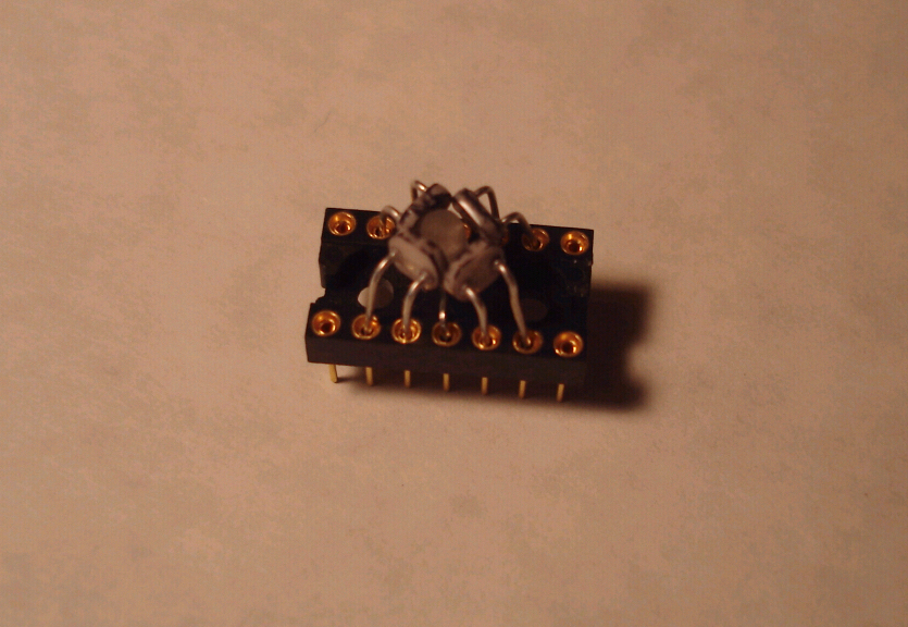

jhaible wrote:
What's your favorite shop in the USA to buy LDRs and incandescent lamps?
I've used the Silonex NSL-6112 from Allied on phasers and univibe-type circuits with great success. See here:
http://www.alliedelec.com/Search/SearchResults.asp?N=0&Ntk=Primary&Ntt=NSL-6112&sid=46E489003D5B617F
Below, that's an LED in the middle of those LDR cells.
Regards,
Joe
 Filesize:  591.49 KB
 Viewed:  835 Time(s)

That looks nice. That's an incandescent inside?
edit; any chance of reposting this? As the actual LDR section is out of focus. (the camera seems to have focussed on the socket instead

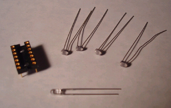

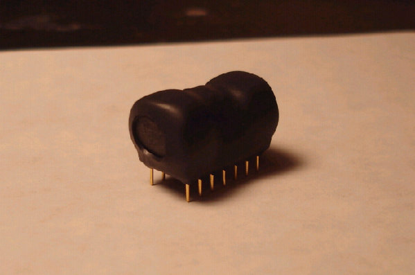

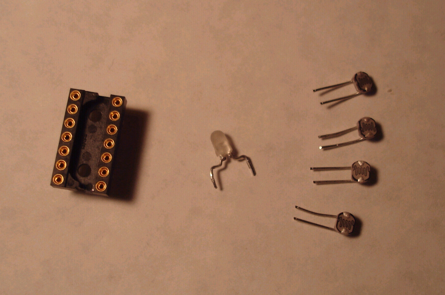

germaniac
Joined: Aug 04, 2006
Posts: 200
Location: California
Audio files: 7
PostPosted: Mon Sep 10, 2007 12:33 pm    Post subject: Reply with quote  Mark this post and the followings unread
Yes, sorry for my lousy photographic skills. These pix were done a long while ago, and by now the little module is all packaged in shrink tube and happily phasing away in a four-stage phaser. FWIW, here are a couple more pix from that build:

v-un-v
Joined: May 16, 2005
Posts: 8932
PostPosted: Mon Sep 10, 2007 12:43 pm    Post subject: Reply with quote  Mark this post and the followings unread
Nice Cool
But that's with an LED. I'm trying to think how we can do this with a filament bulb- which can be replaced if necessary- although apparently the chances of the bulb 'blowing' are remote.

germaniac
Posts: 200
Audio files: 7
PostPosted: Mon Sep 10, 2007 12:59 pm    Post subject: Reply with quote  Mark this post and the followings unread
Right, an LED. For my purpose at the time (a battery-powered stompbox) it was all about keeping current consumption low. But since that's no concern for something mains powered, I'd guess the smoother response of the incandescent bulb is preferable. Or in any case, it's more authentic to the original Schulte design, right? Smile

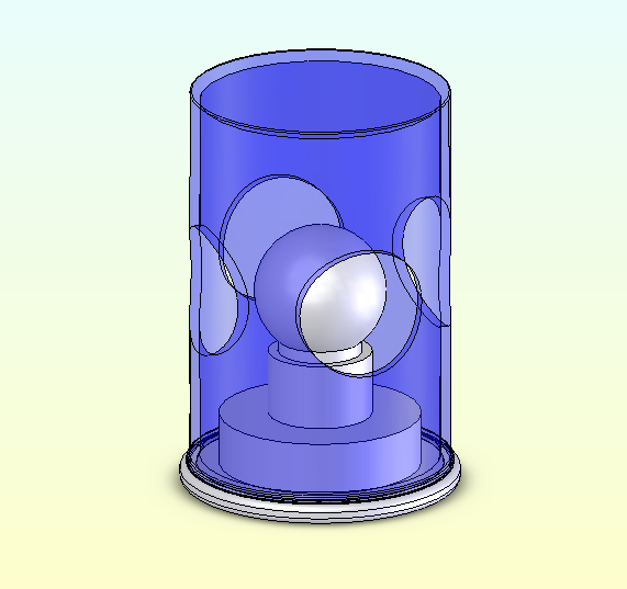

jhaible
Joined: May 25, 2007
Posts: 2014
PostPosted: Mon Sep 10, 2007 2:22 pm    Post subject: Reply with quote  Mark this post and the followings unread
v-un-v wrote:
Nice Cool
It's even easier with an incandescent lamp. Put the sensitive surface of 4 LDRs directly on the glass surface of the bulb (long wires ..). Wrap it with a sturdy black adhesive tape.
JH.

v-un-v
Posts: 8932
PostPosted: Mon Sep 10, 2007 3:14 pm    Post subject: Reply with quote  Mark this post and the followings unread
I just knocked this up in SolidWorks. It shows a film cannister (in blue and transparent- just to help viewing btw) with holes drilled through the sides for the LDR's to fit (also do to exact dimensions for now). Inside is a standard bulb holder and bulb. The idea is that this could be mounted on veroboard with the LDR's surrounding the bulb, through the cannister 'windows' and soldered to the veroboard. With slight modification, this could be adapted so that the bulb could be replaced if needed- ie just by opening up the film cannister. The lid of course is bolted using M2 or M3 bolts- whatever the hole diameter is on the bulb holder.
Any thoughts?
