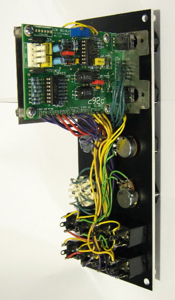

Ok, show and tell time. Just finished my version of the complete bells and whistles version. Based my panel on Thomas Whites design, with several changes.
The back - unlike previous builds, I didn't have to use cable ties this time - the wires all seemed to fall into place on their own.
These images and more are on my flickr page, if you want to see bigger images -
http://www.flickr.com/photos/sduck409/
Thanks Thomas (and team) for the great pcbs! It sounds fantastic!

Ok, I finished putting together all of my pcb's, and put numbers 2 and 3 behind this panel. I've got fast vactrols on the left, slow on the right for some variety.
DRLGfront
I'd like to thank fadedata (Dustin) for inspiring to clean up my behind the scenes wiring - there's still room for improvement, but it's a lot better than previous efforts.
DRLGback

That's a nice looking dual LPG!
