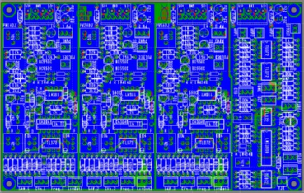

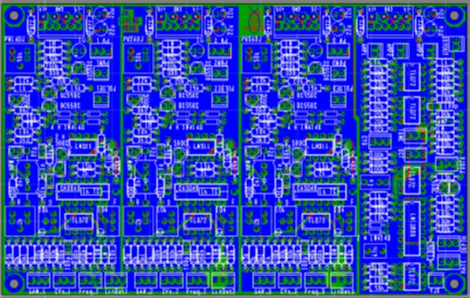

Update - rough version of layout finished!
(checking for errors on Friday)
JH.

b-funk
Joined: Jul 17, 2007
Posts: 193
Location: Berlin
PostPosted: Wed Mar 04, 2009 11:36 pm    Post subject: Reply with quote  Mark this post and the followings unread
Fantastic!!! Very Happy
I have to get more tempcos....

PostPosted: Thu Mar 05, 2009 1:38 pm    Post subject: Reply with quote  Mark this post and the followings unread
Hey Juergen
Am I right in thinking that this board has 4 power inputs?
I’m looking forwards to this one
Paul Darlow
www.krisp1.com
jhaible
Joined: May 25, 2007
Posts: 2014
PostPosted: Thu Mar 05, 2009 2:41 pm    Post subject: Reply with quote  Mark this post and the followings unread
krisp14u wrote:
Hey Juergen
Right.
4 MOTM connectors or 4 Synthesizers.com connectors.
The 4 circuits are completely isolated - they only share a board.
JH.

PostPosted: Fri Mar 06, 2009 5:25 pm    Post subject: Reply with quote  Mark this post and the followings unread
http://www.jhaible.heim.at/living_vcos/jh_living_vcos.html
Gerber files sent to Olimex today.
JH.

PostPosted: Fri Mar 20, 2009 3:52 pm    Post subject: Reply with quote  Mark this post and the followings unread
synthetic wrote:
Looking good. That sure is a big board, though. I hope it fits in my cabinet. I'm assuming I'll need to mount it horizontally on a bracket, and it looks to be 8" deep (200mm).
160mm * 100mm
I assume that daisy-chaining the power is OK? I would probably put in one power jack and hot-wire the four sections together.
I've put 4 connectors there toallow star-wiring.
It will certainly work with daisy-chaning, too.
Wheter there is a tiny difference in terms of absence of interlocking is yet to bee seen.
JH.
