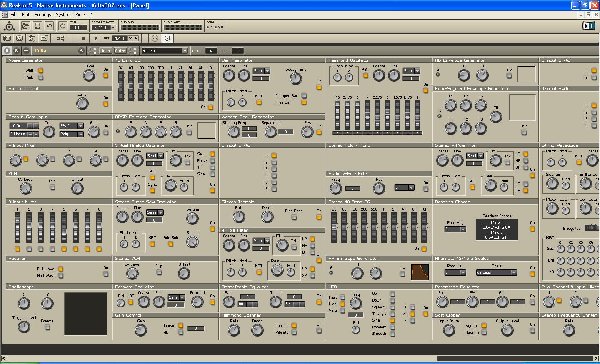

Posted: Tue Oct 13, 2009 9:43 am Post subject:
| buzzr wrote: | Right now I'm using the G2 with Reaktor and having some very good results.
Maybe Reaktor will be updated.......HA! |
Heh, I agree that Reaktor's overdue for an update. But it still has some life in it. I'm building a collection of Reaktor macros right now in an attempt to mimic the style and operation of the G2 modules. I've got another dozen or so modules to finish, and then I'll submit it to the Reaktor user library.
I'd add a picture of it, but I got a message saying "Sorry, you have reached your maximum Upload Quota Limit of 20 MB". |
Joined: Apr 03, 2004 Posts: 24505 Location: The Netherlands, Enschede
Posted: Tue Oct 13, 2009 10:26 am Post subject:
| Chet wrote: | | I got a message saying "Sorry, you have reached your maximum Upload Quota Limit of 20 MB". |
I raised your limit Chet and would love to see the picture  _________________ Jan
Chet
Joined: Nov 19, 2004 Posts: 231 Location: Lititz,PA,USA
Audio files: 7
G2 patch files: 35
dorremifasol
Joined: Sep 28, 2006 Posts: 823 Location: Barcelona, Spain
Audio files: 7
G2 patch files: 49
Posted: Tue Oct 13, 2009 10:38 am Post subject:
Wow, that looks pretty nice  _________________ Cheers,
Albert |
Posted: Tue Oct 13, 2009 10:40 am Post subject:
Thanks! looks good! _________________ Jan

Posted: Tue Oct 13, 2009 10:53 am Post subject:
| Beatless Chords sounds interesting, what does that do then? |
Chet
Audio files: 7
G2 patch files: 35
Posted: Tue Oct 13, 2009 11:18 am Post subject:
| BobTheDog wrote: | | Beatless Chords sounds interesting, what does that do then? |
It makes minor adjustments to pitches, converting equal temperament to just intonation. You choose a root key, and when you play chords some of them (I, IV, V, IIIm, VIm, etc.) do not beat. It’s an unusual sound for those of us accustomed to hearing equal temperament-based music. It’s especially useful for crunching guitars and overdriven organs, because major chords don't sound muddy. |

buzzr
Joined: Dec 13, 2007 Posts: 360 Location: portland
Posted: Tue Oct 13, 2009 4:44 pm Post subject:
Looks nice Chet! You're giving Bantri a run for his money
In the meantime I'm investing in a doepfer... |

Posted: Tue Oct 13, 2009 8:48 pm Post subject:
| buzzr wrote: | Looks nice Chet! You're giving Bantri a run for his money
Oh, I'm not attempting anything as difficult as Bantri is. I'm making an imitation, not a copy. He's actually going to emulate 24-bit integer math in Reaktor (egads!), while I'm content to paste in stock oscillators and filters.  |

Posted: Tue Oct 13, 2009 9:50 pm Post subject:
| Chet wrote: | | Great! Here it is. |
absolutely fantastic, looking forward to it! i'm actually more interested in something like this than what Bantri is doing. we'll see how this works out as far as patching. not sure exactly what it entails, pretty exciting though! _________________ SoundCloud |
