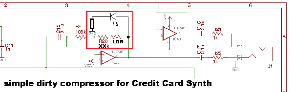

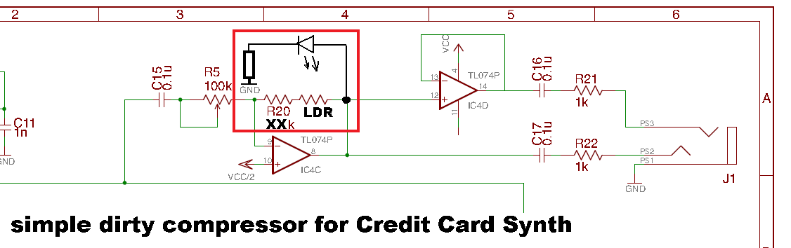

Les, you already had an idea about a compressor , but this is what I meant. It may change the sound as well, clipping the signal asymmetrically with loud sounds. I tend to quite like that usually.

Yes, Mathe, I got what you meant from your previous description. Sounds like a cool idea but there are some mechanical issues. It requires hand assembly and bending of wires and heat shrink or other optical isolation. It's a cool way to go for onesie-twosies, but I tend to design for production.
I was thinking of a diode and resistor in feedback or something, not sure... Or a clamp at the bias of the MN3207, that would do it, just like on the modular KS board.
Well, more thought is needed and we can use such a circuit in our workshop, but for this board I'm not sure if it will be appropriate. Please do keep those ideas flowing, though, my friend!

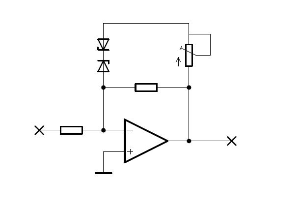

A Ok, I'm interested in this project, so I'm ordering those chips. Ill breadboard it.
About the compressor maybe a ready build Vactrol?
Last night experimenting in the breadboard I found this ultra simple compressor.
It acts as a compressor since do not cut the wave just flatten it.
See picture, Zener value sets the threshold, potentiometer sets ratio/amount of compression that could be a fixed resistor with the desired amount/ratio of compression.

Yes Sound, that is very similar to what I was thinking. With a zener diode implementation you would connect the two diodes in series, and with a diode or LED implementation you would connect the two diodes in parallel. I don't have much of an idea what the resistor value should be.
Les
I was trying with 100K pot and was something within, should be experimented with the synth card I think.
EDIT: In any case in the Zener example, all wave over the Zener threshold will have gain Rf/Rin where Rf is the two feedback resistors in parallel. I think.
