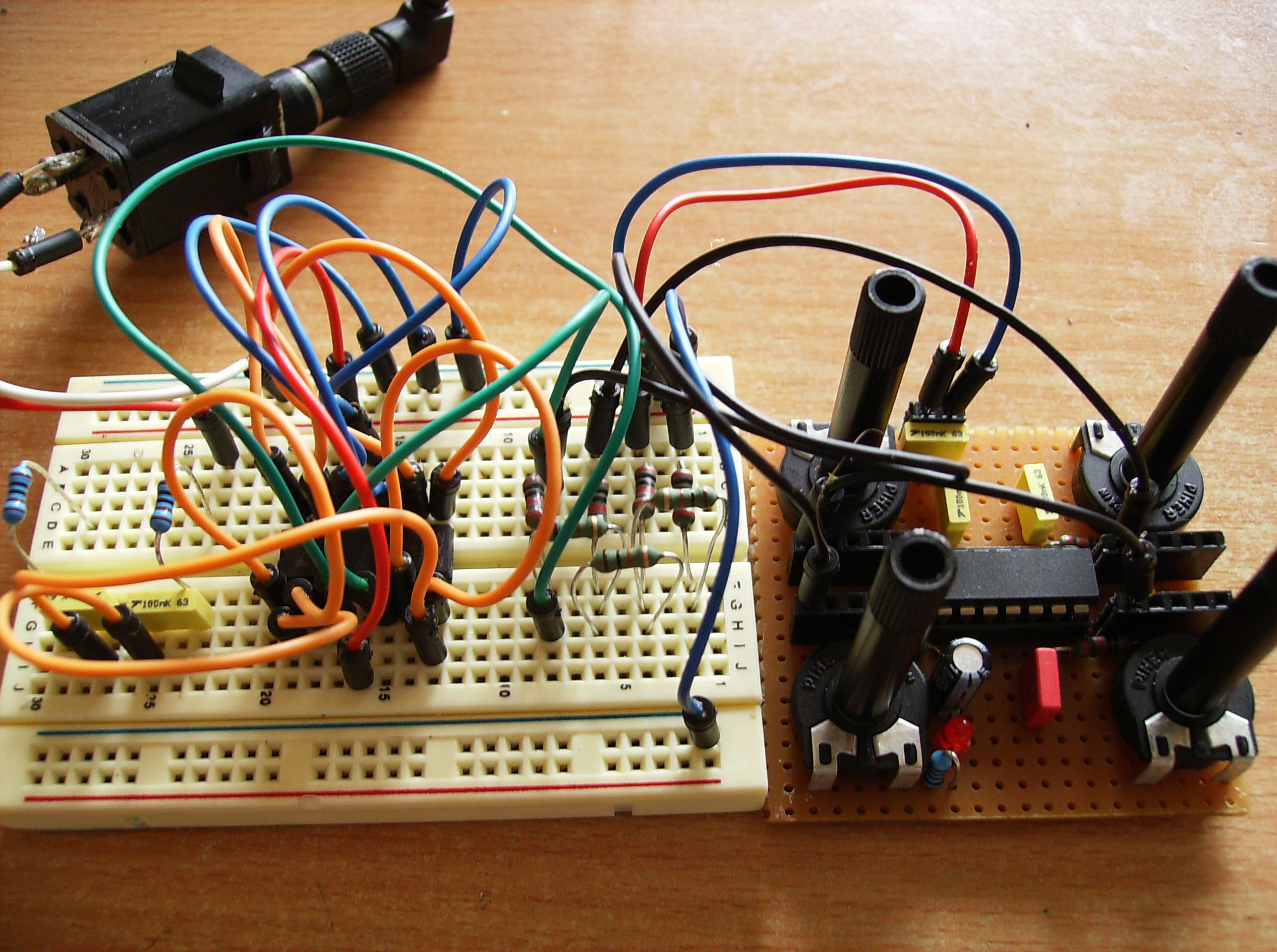

Because this community rocks and the people have been so helpfull I can't help to do something back. This thread is for posting my progress as an absolute beginner into the world of lunetta's, for beginner info I suggest starting here: http://electro-music.com/forum/topic-40243.html Im hoping that by showing other beginners my progress I can inspire them to build their own.
First, a little background info:
I am a fine arts student with a background in mechanics and a passion for music and tinkering. After messing around with computers and midi stuff I decided It's time to make my own sounds. I've done some circuitbending and built the Weird Sound Generator by ray wilson, link:http://www.musicfromouterspace.com/analogsynth/YOUR_FIRST_SYNTH/WSG_Reborn/WEIRDSOUNDGENERATORREBORN.php perfect for beginners.
After a lot of searching and the usual lurking in the shadows of the forum I discovered this thing they call lunetta's. Looked around, loved it and ordered my first set of cmos IC's and other small parts. I want to avoid using expensive frontplate parts and decided I want to build a modular lunetta using droffset/electri-fire's perfboard design: http://electro-music.com/forum/topic-30479-150.html, and it just looks really cool Cool .
I built my first module yesterday. It's a quad oscilator using a 40106 based on the attached pdf, really basic but absolutely neccesary for further experiments. I found it really usefull to breadboard the whole thing first and double check everything before making the final perfboard version. Learning how to breadboard a schematic is a must have skill for lunetta building, start out easy and you'll get the hang of it in notime. I've attached a top and bottom view of the module. I know my solderingskills are a little shabby, but I hope it's usefull to others to see how the connections are layed out.
Today I messed around with a r2r ladder and a tl074 op-amp, copying the other part of the quadosc schematic, see attachment. It worked real nice, but im going to try some other mixer/amp combinations to see wich works best. Suggestions about this are very welcome because im getting a little confused with all the different op-amp schematics.

Tjookum - your soldering looks absolutely fine for early in your experiences! It's nice and clean and most of your solder points have a nice shine to them! It's hard to be neat and tidy sometimes on perfboard. In those regards - great job!

Nice soldering! Nothing to be worried about there - or for that matter, your language skills...nearly perfect!

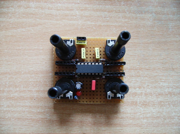

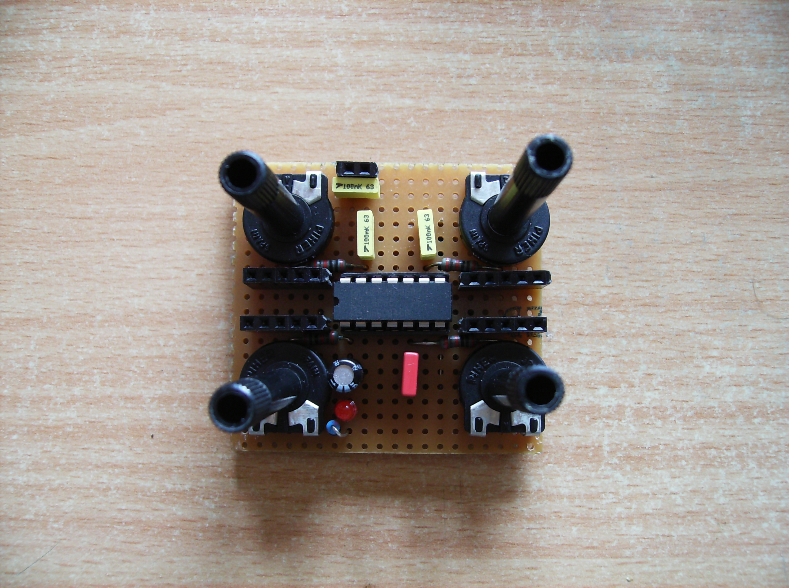

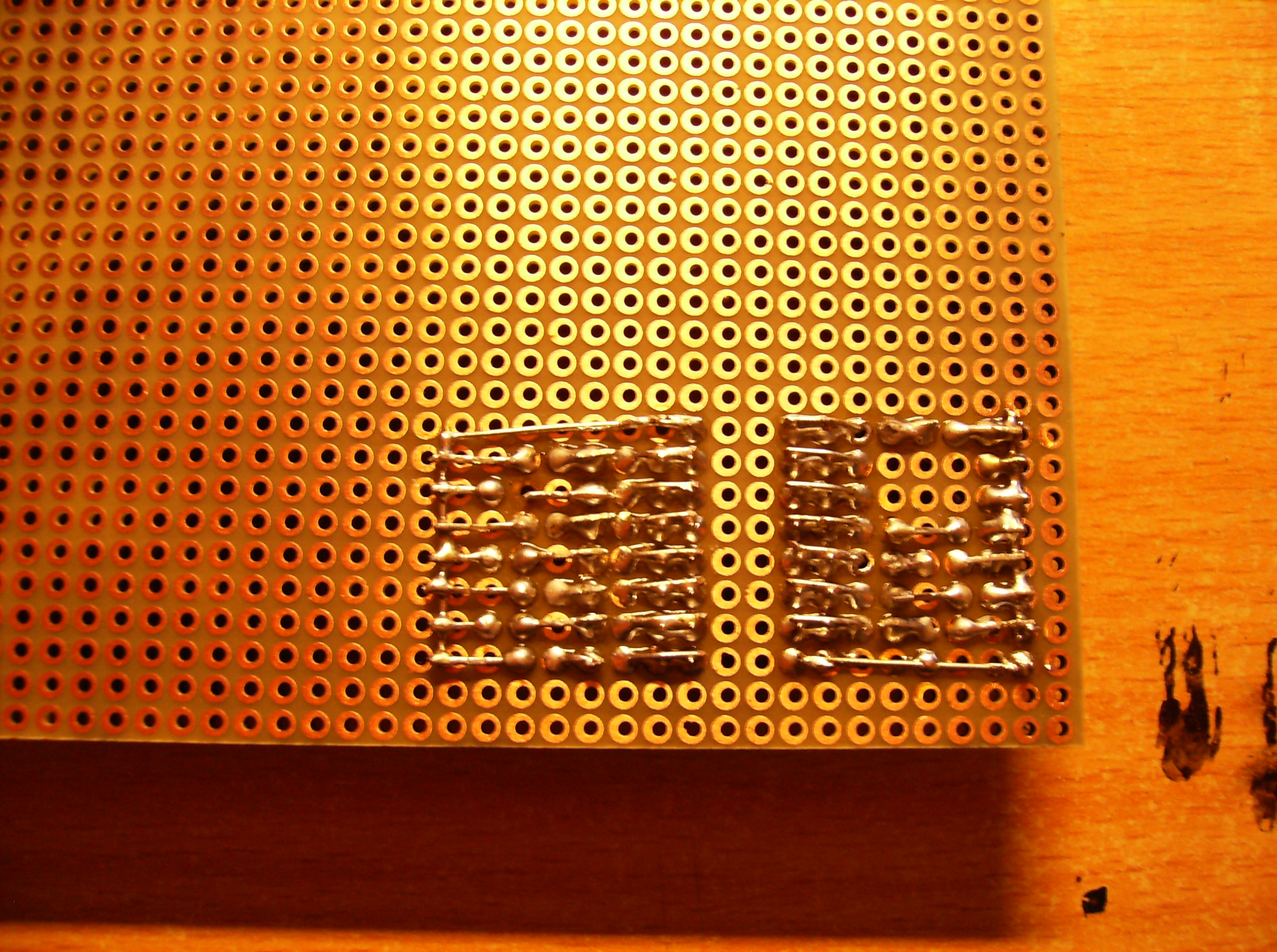

ok, made some progress today, im glad I have some spare time cause the learning and building combined eats up a lot of time. Im using euro-size 100x160mm perfboards and I considder the first one as a prototype to test stuff and see how it works. I painted the perfboard using a marker and it worked really well. I tried paint earlier but that just cloggs up the holes. I first tried a couple of cheap colourmarkers but found out that the only way to get some real coverage was to use one of those thick graffiti markers. Im interested to see how I can use this to improve functionaility as well as looks.
I also got the first chip on the board, a simple and very usefull 4040 divider. I used the Echuck schematics electri-fire posted here: http://electro-music.com/forum/topic-38634.html. Although the 4040 is easily understood from just the datasheet. I tried some different layouts by just hanging the parts in the perfboard to see wich works best. I would like to make it as easy as possible to use, not just by me but also some musically gifted friends. I ended up with using exactly the same design as droffset, I hope it's not considdered stealing but it was so well thought out that I couldn't find any better way of doing it.
Im still looking for some simple single supply modules to make on my experimental board, suggestions are very welcome...

Nice perf work man. Top job. Like the way this going to look. Did you use a black marker pen for the topside of board.
The dirt sound comes from putting upto 8volts into the gate of the Envelope/VCA. Usually 0 to 5v is gate signal but this has given it the buzz saw sound. Especially if you raise the attack and have release nearly full up. The whole setup runs on 9v so i can push the lm358 a bit harder. I have eq'ed the output to add more bass but the distortion is still there. Very Happy Very Happy

The black marker on the perfboard looks absolutely stunning! Shocked Very Happy

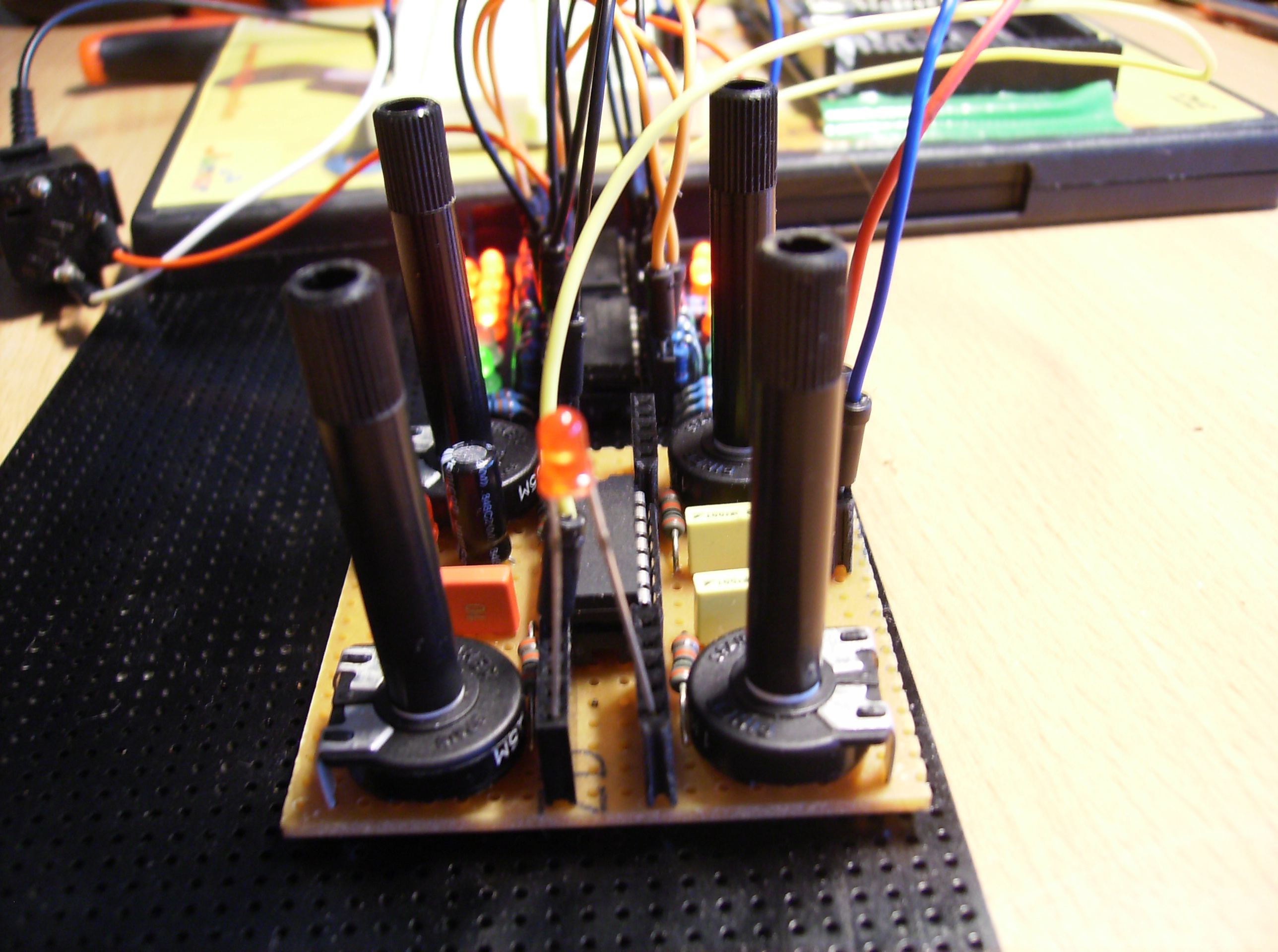

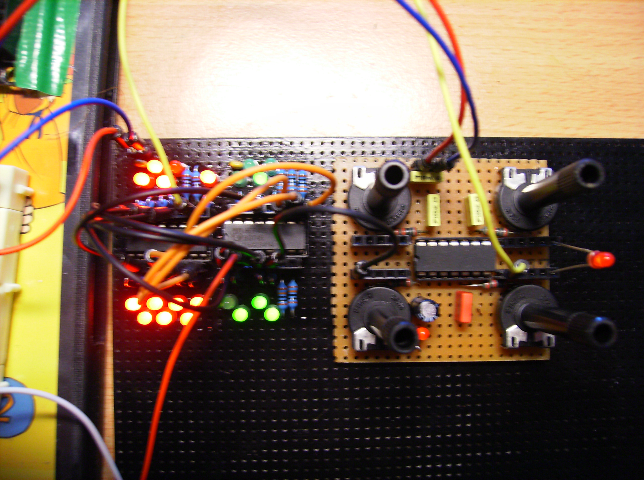

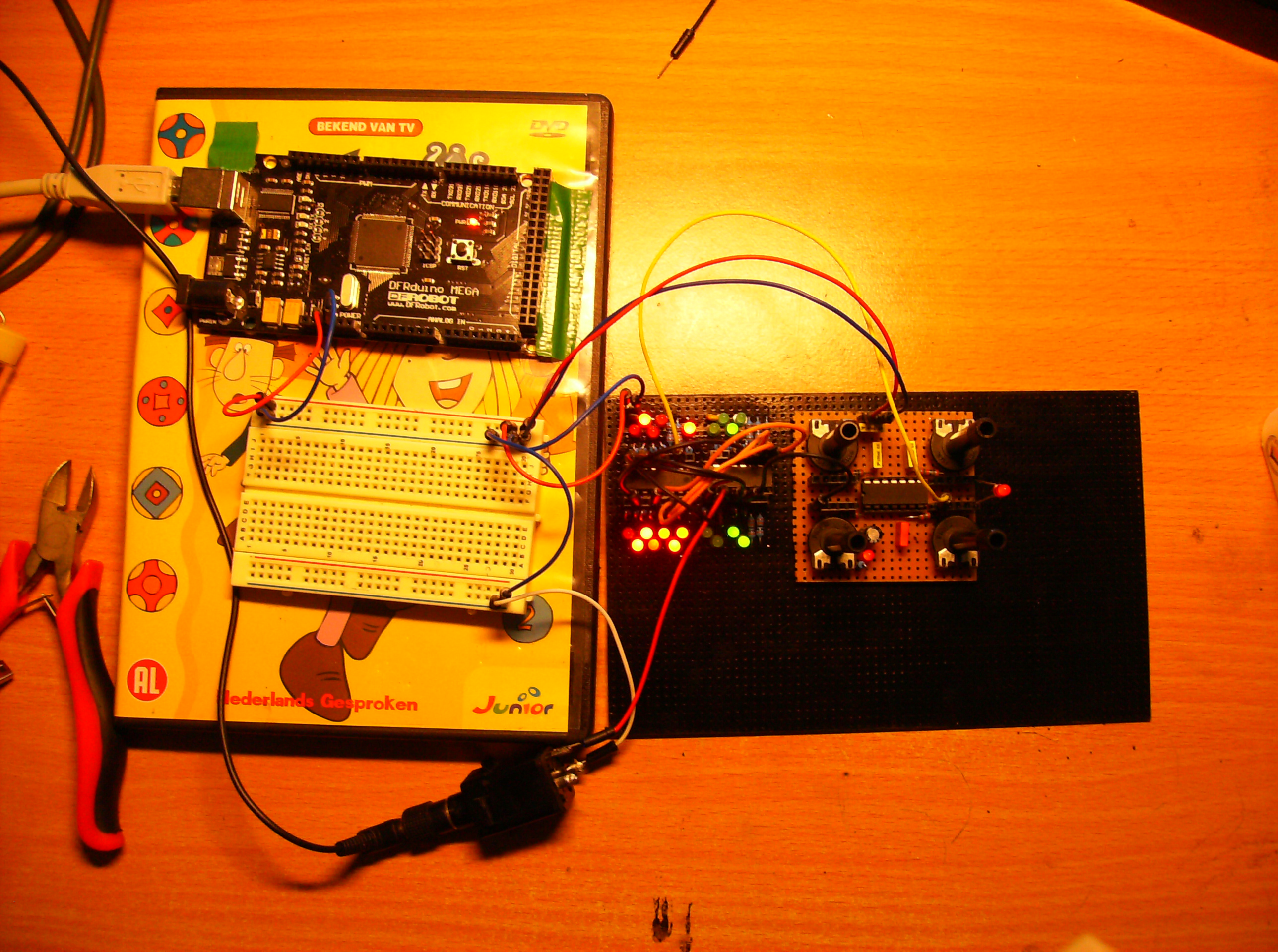

Back to to today's experiments and build. I found out that I forgot to add the bypass cap and didn't connect the groundlines on opposite side of the 4040, Surprised . This kind of stuff happens all the time, I guess my brain thinks it's good fun to mess with me sometimes. I also added the 4051 wich I already "dry-boarded"(the placing of components in the holes so as one does not forget) last night. Using the arduino as a 5v supply I flipped the switch and behold, it was spitting out some very cool sounds! I used the quad osc. for the clock signals and gated 2 osc. together with a led(thanks electri-fire!). The led's are also blinking away nicely, I can definately recommend using those. I posted 2 clips on my youtube channel: http://www.youtube.com/user/JvGrieken
Im still struggeling to get the powersupply working as it should. The arduino has 5v and 3v3 outs, does this mean I can use the 3v3 as a dual supply? I know an arduino is overkill in a lunetta but since I have it I might as well use it. Im also running into some problems routing all the different +v and ground connections underneath. How do I place the bypass cap when I use one +v and ground connection for the entire board? How did you tackle this droffset?

the entire current setup

PostPosted: Wed Jun 09, 2010 12:16 pm    Post subject: Reply with quote  Mark this post and the followings unread
Thats sick man. That is coming along fast more vids please. Very Happy Very Happy

I got the 4015 in yesterday, I really wanted a more symmetrical lay-out so I wired pin 1 and 2 to output 9 and 10 and vice versa. It's a usefull addition to the board and the leds make really cool patterns too Very Happy .
For the Shift Registers, if you're not using their individual outputs for driving other things and would like to see / hear some action, build yourself an R-2R Digital to Analog Converter (DAC). Then, pump the DAC's output into a VCO. The more inputs that you have, the greater the variety of (cough cough) 'melodies' that you'll get out of it.
Thanks again! I breadboarded the r2r and also a synthmonger triangle VCO, after some tinkering I got it working and I got some cool melody's. The sound is not really what im looking for(I like things raw, dirty and less predicatable Wink ), but I can see the potential. I've added a vid to my channel: http://www.youtube.com/watch?v=JkSj4drJdkQ
Im planning on using the vco mod for my wsg so I might get some more fun out of this setup.
Im still confused about the use of bypass caps, at the moment I don't use them for the 4051 and 4015 and they seem to work normal.
On the wsg I just put all the bypasscaps next to the power and ground supply, I remember someone saying that it's good enough for these simple circuits and it works just fine.
Power is also something im struggeling with. Im planning on building a seperate board for the mixer and other op-amp related stuff powered by a 2x9v bipolar supply. Can I connect the ground of the 2 boards together and still have the cmos board on single(5-15v) supply?
Also tried a 4011 ringmod today, at 5v it didn't work at all and at 9v it would only spit out some fragmented sound at high frequency's. Anyone have a good schematic for this?

Im still confused about the use of bypass caps, at the moment I don't use them for the 4051 and 4015 and they seem to work normal.On the wsg I just put all the bypasscaps next to the power and ground supply, I remember someone saying that it's good enough for these simple circuits and it works just fine.
The bypass caps are of special importance at you basic oscillator chips where you have your timing capacitors and resistors. In a lot of Lunetta's this means at your 40106 IC's. Voltage drops or oscillations on the powerline directly affect these. I "think" this is less of an issue with IC's that just take in external clocks, like your 4051 and 4015's.
Putting multiple bypass caps near the main power sort of defeats the purpose. Might as well just have one bigger electrolitic there. The small (usually 0.1uF) caps want to go as close to the IC as possible.
That should work. Some opamps are "said" to need bipolar supply, but there's a way to eliminate the need for bipolar supply on opamps. What you do is put half the supply voltage on the other (opposing) input of the opamp. Example: if your sound goes into the + input of the opamp and you run your board on 9V, put 4.5V on the - input of your opamp. Now the -V can be 0V or Ground.
Half the supply voltage can be made with a voltage devider, two equal resistors in series between +V and ground. On the junction of the resistors half the supply voltage is availabe.
Hrmpff, that should not be the case. I think you should either troubleshoot your connections, or use all stabilizing techniques like bypass caps and pullup/down resistors.
