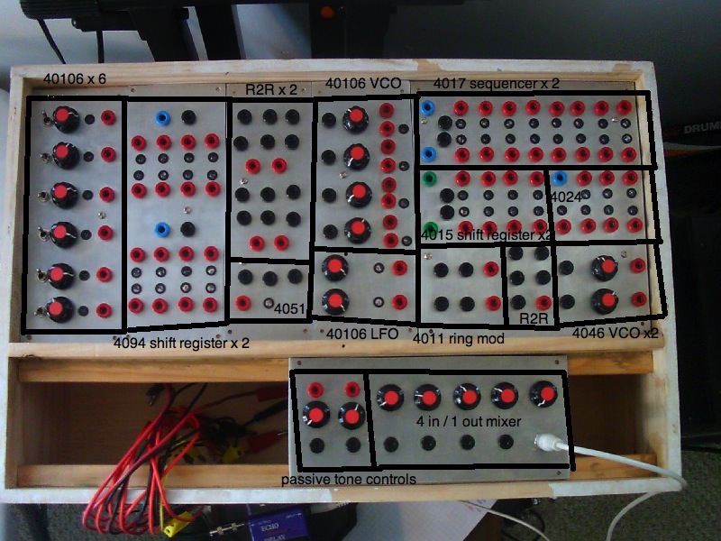

PostPosted: Mon Mar 29, 2010 9:53 am    Post subject: another demo Reply with quote  Mark this post and the followings unread
so far its sounding a bit like this...
about to finish yet another panel (with 9 different modules in it) should have the whole box done in a couple weeks.

PostPosted: Wed Mar 31, 2010 12:23 am    Post subject: Reply with quote  Mark this post and the followings unread
Sounds like a challenge Razz
Here's yet another iteration on the theme. A coat of paint and a new board with 11 more ICs on it
Shift registers
4006
4015
4021
4094
Mux and selectors
4051
4051
4052
4066
FlipFlops and other
4008
4027
4043
OnBoard Lunetta
OnBoard Lunetta Main Boards
Edit: Spelling mistakes.

textual
Joined: Dec 05, 2009
Posts: 78
Location: New York City
PostPosted: Mon Apr 05, 2010 8:04 am    Post subject: so basically finished, minus one panel. SWEET sounds! Reply with quote  Mark this post and the followings unread
http://www.youtube.com/watch?v=aiitYvwXGW4[/code]

PostPosted: Tue Apr 06, 2010 8:59 am    Post subject: Reply with quote  Mark this post and the followings unread
here is a labeling of it so far...
 Filesize:  180.76 KB
 Viewed:  336 Time(s)
