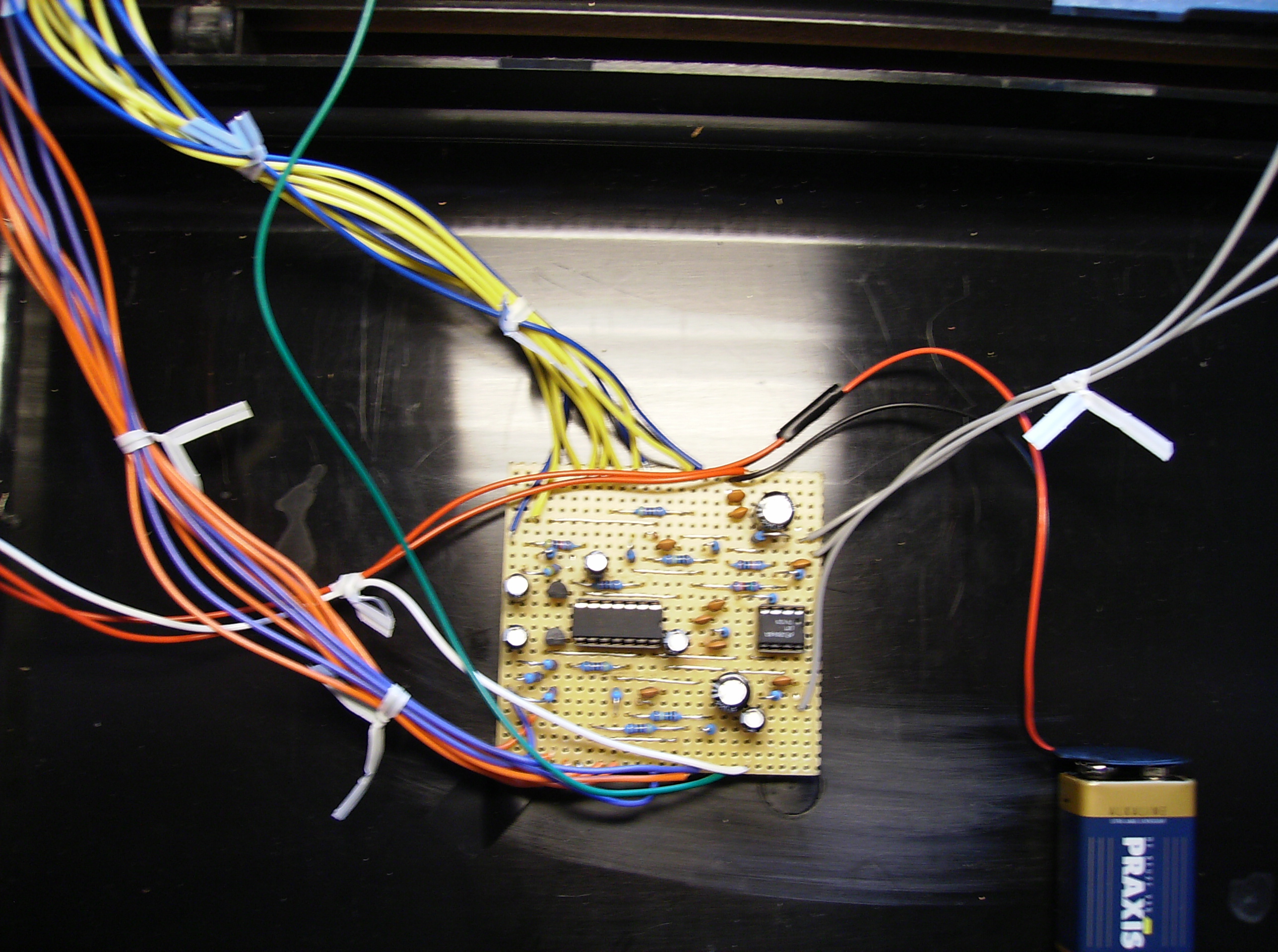

PostPosted: Mon Dec 28, 2009 9:53 am    Post subject: Reply with quote  Mark this post and the followings unread
Thanks for sharing the wsg in stripboard layout cheers
I'm building it...but notice that the bypass caps (c9, c10) are missing.
Can I just solder this caps right next to + and - supply like in the picture?
Sorry I'm no electronics expert Sad
Thanks Very Happy

PostPosted: Wed Dec 30, 2009 6:09 am    Post subject: Reply with quote  Mark this post and the followings unread
Technically, you should put them on the copperside of the board, right underneath each chip. They are for bypassing the chip's supplies and therefore should be located as close as posssible to the chip's supply pins. Really though, in this circuit, it doesn't matter too much. That is the best practice though.

PostPosted: Sun Jan 03, 2010 5:26 am    Post subject: Reply with quote  Mark this post and the followings unread
Thanks.
I put them in the easy way Very Happy
The pcb is finished, moving on to the case Cool

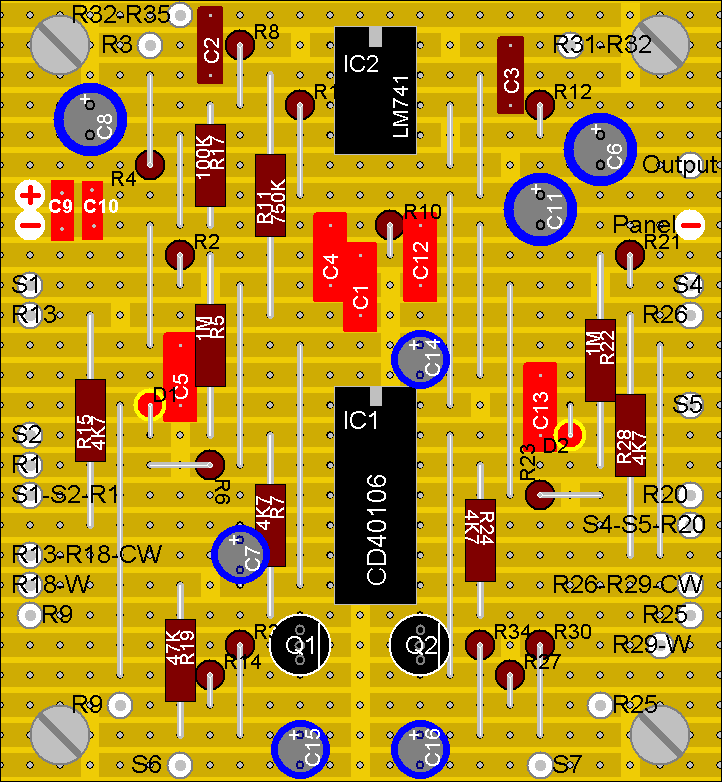

PostPosted: Wed Feb 10, 2010 4:58 pm    Post subject: Reply with quote  Mark this post and the followings unread
Thanks Very Happy
Hi all,
I thought I'd test my rusty skills on this WSG before attempting something more serious, but am confused already.
What is the difference between the layout in Benuron's post (a few prior to this one) and the original Uncle Krunkus post on page 1 of the thread?
They seem to share the same components but I don't know if there are any functional differences between the two. I thought I was following the Uncle Krunkus layout but have accidentally cut my stripboard according to the length of Benuron's, which I have just noticed is a few holes shorter... Embarassed
Thanks Very Happy
Stokes.
PostPosted: Wed Feb 10, 2010 6:54 pm    Post subject: Reply with quote  Mark this post and the followings unread
I just checked Ray's WSG page, and it still shows the original layout I did. The one benuron posted 2-3 posts ago is the new "improved" WSG as a new "improved" stripboard layout. Whichever one you've cut your board for will work fine. The new one has some extra controls and resonance control.
I thought I'd sent the new layout to Ray, but maybe he hasn't updated the webpage with the new layout yet.
PostPosted: Wed Feb 10, 2010 6:58 pm    Post subject: Reply with quote  Mark this post and the followings unread
The new board is 2 holes narrower and 1 hole longer.
Sorry about the confusion.

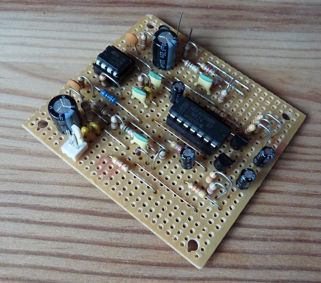

PostPosted: Tue Mar 09, 2010 7:59 am    Post subject: Reply with quote  Mark this post and the followings unread
I've built the WSG (the new version with filter) on eurocard prints.
2 of them.
... and it works...
Sorry if my english isn't correct

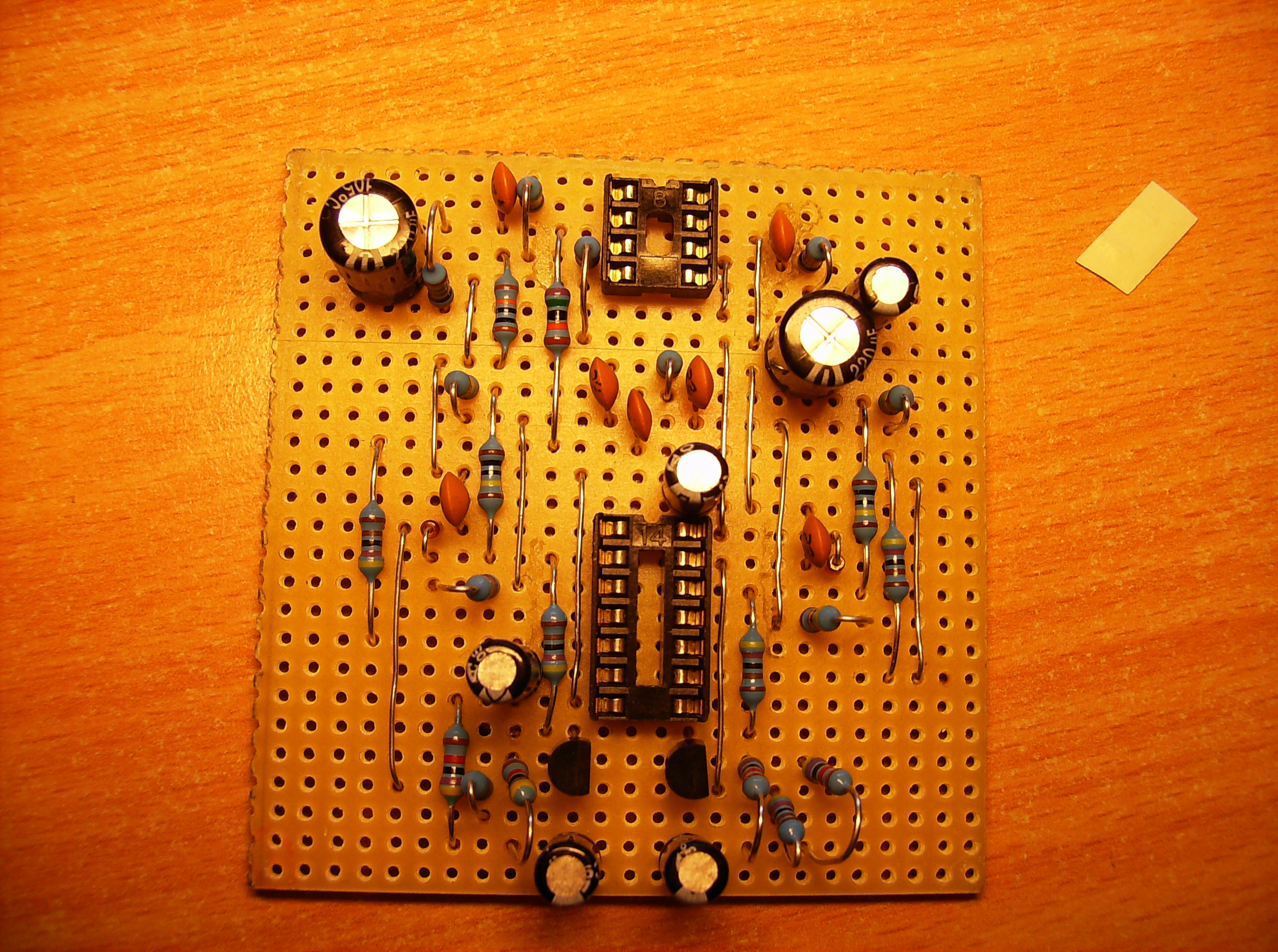

PostPosted: Thu May 27, 2010 5:44 am    Post subject: Reply with quote  Mark this post and the followings unread
hi there,
First time synth diyer here. Ive been building the WSG using the same stripboard lay-out benuron uses, the improved version from ray's website.
Since it's my first build I took my time and did it slow and rechecked everything twice. But when i switched it on it just produced a very faint fading sound, like something slowly discharging over 5 seconds. I was really dissapointed, a lot of time and care went into building it and I was hoping to be making weird sounds by now. Any thoughts on what it might be?
The things i was confused about on the lay-out:
-The direction of the diodes? did i get it right?
-I added C9 and C10 as described by benuron above, is this correct?
Ive added some pictures, hope it helps... otherwise it's going to be a long night of debugging.

PostPosted: Fri May 28, 2010 6:31 am    Post subject: Reply with quote  Mark this post and the followings unread
DOH!
After rechecking all the resistor value's, panel wiring and a good night of sleep I just found out i ordered and placed the wrong caps. 100 pF and 22 pF just wont do...lol. Well, at least I learned to check the value's of all components before soldering Smile .
My new MKS2 caps in correct value's will be arriving tomorrow, hopefully i didn't damage the IC's and everything is still fine. When I finish this badboy I'll post some pictures.
