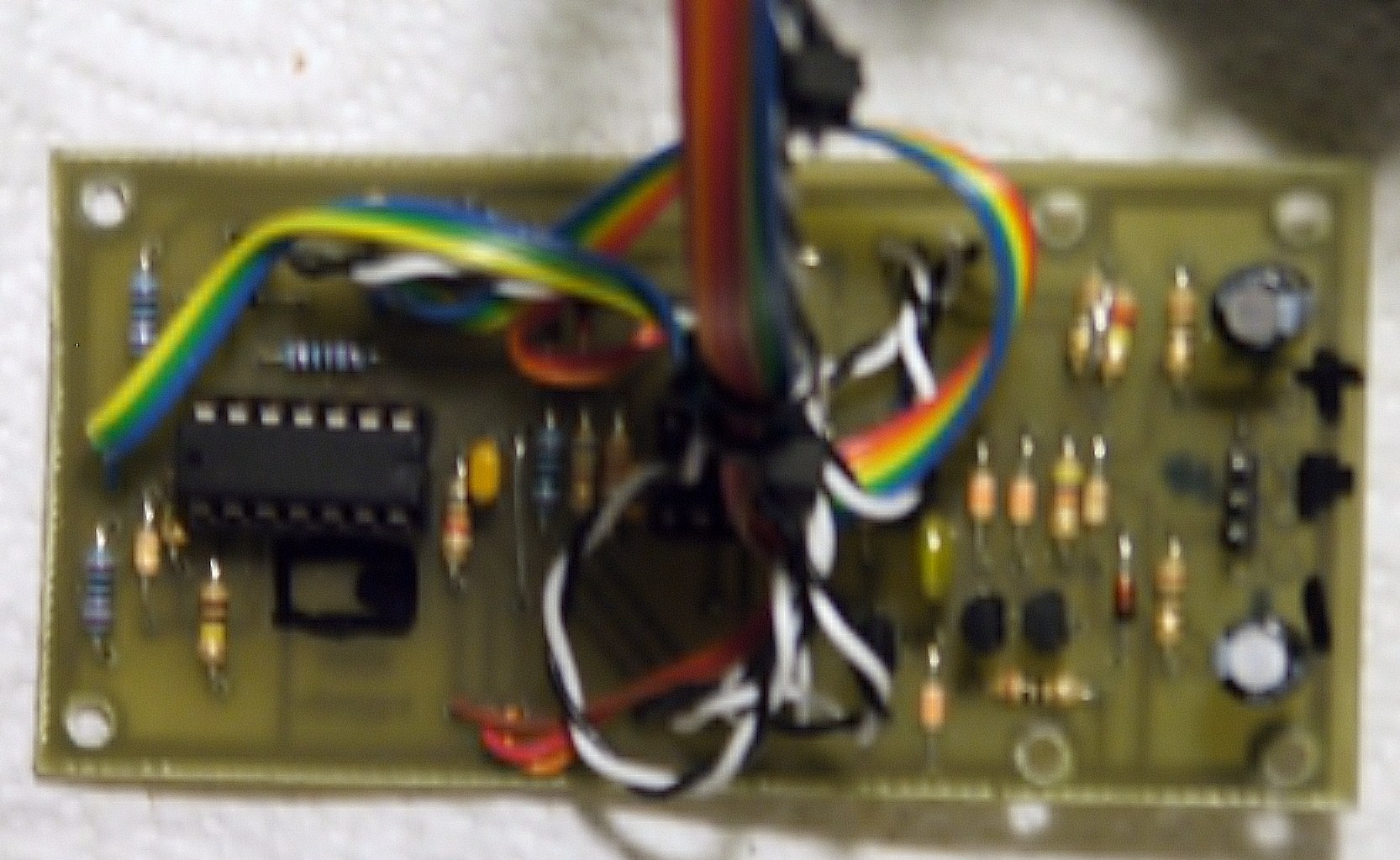

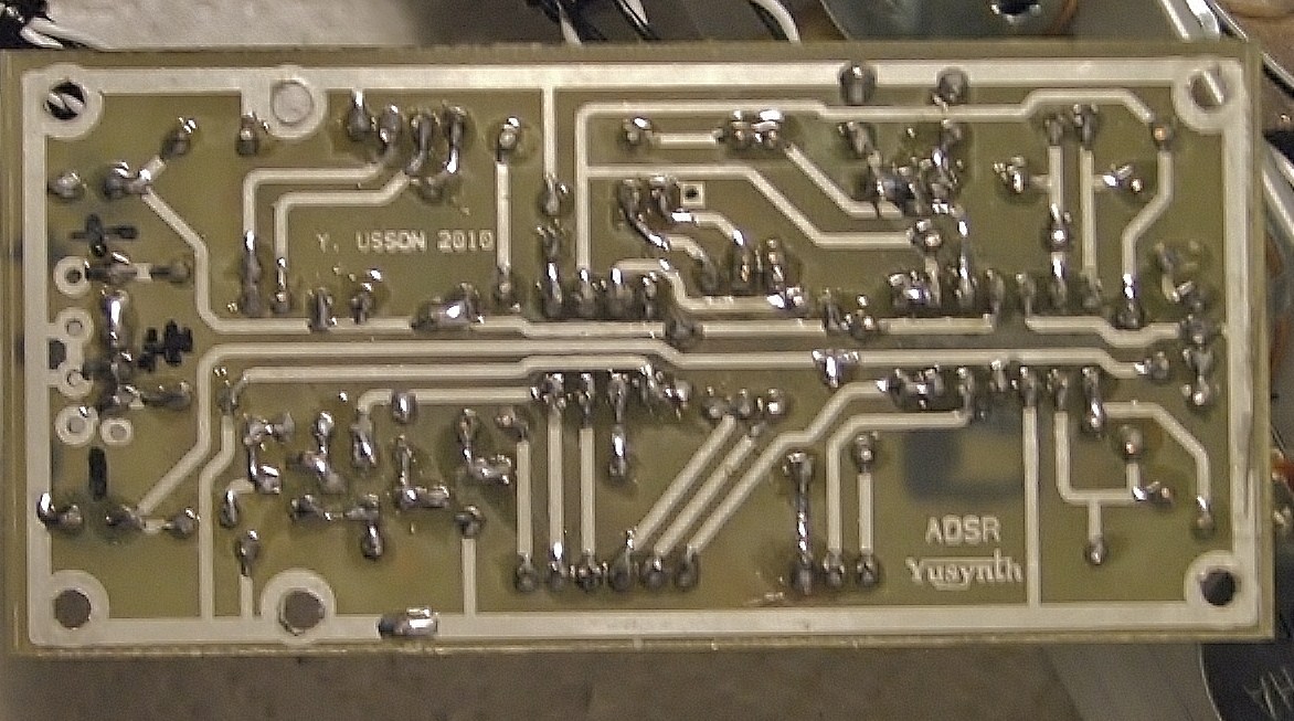

PostPosted: Thu Feb 10, 2011 8:35 am    Post subject: Reply with quote  Mark this post and the followings unread
Awesome!!! It was the older version so I connected the emitters from Q1 and Q2 and it works Very Happy
I have another question Embarassed
I added the DPDT switch to select fast or slow. When I use the gate button everything acts the way I would imagine but when I send a gate signal to the input the decay doesn't start until I've released the gate. Is that normal?
I connected the three fast/slow pads under the tantalum caps but not the 3 to the right of the diodes. Is that correct?
yusynth
Joined: Nov 24, 2005
Posts: 1314
PostPosted: Fri Feb 11, 2011 5:56 am    Post subject: Reply with quote  Mark this post and the followings unread
Can you send a photo of the assembled PCB ?
Yves
JRock
Joined: Mar 05, 2010
Posts: 87
Location: Bucks County, PA
PostPosted: Sat Feb 12, 2011 4:22 pm    Post subject: Reply with quote  Mark this post and the followings unread
Sorry I took so long. I had to get batteries for my camera. I hope I got a good enough photo. Right now I have the Long selection jumpered and I have the DPDT switch hooked up but it isn't doing anything. If I desolder the jumper then it makes a high pitched noise when I have it switched down.
It still stays open as long as the gate is open...
I did my best on the photos Confused If you need better i can try again or if you have any questions for me please don't hesitate.
I really appreciate you taking the time to to take a peek at my build. Thank you Very Happy

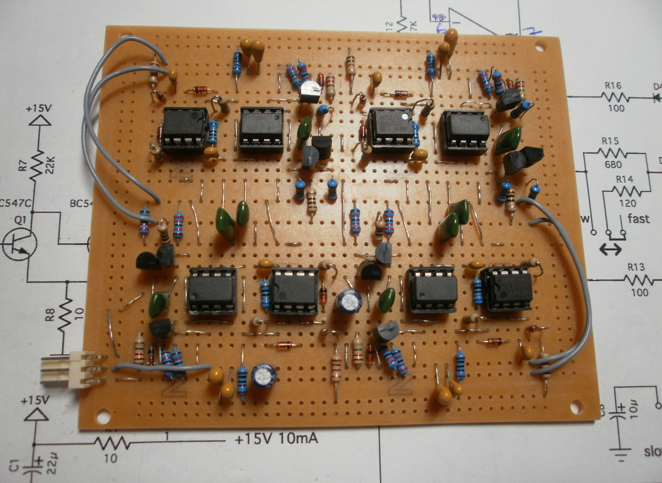

PostPosted: Fri Feb 18, 2011 6:52 am    Post subject: Reply with quote  Mark this post and the followings unread
A while ago I was looking for a relatively simple basic envelope generator and bumped onto this fantastic design. I already had most of the required components and decided to build a quad version on protoboard. The manual gate and inverted output were omitted. A separate quad led driver will be built onto a stripboard, using TL074 which allowed me to use TL072 for output and sustain level buffers for each individual envelope circuit. The transistors BC547C's were substituted with BC548C's, major difference between those being the maximum voltage rating. Short/Long toggle switch will be mounted onto front panel.
Next up is making the panel + wiring. Can't wait to try and start using it!
Attached is the image of the finished board.
 Filesize:  1.94 MB
 Viewed:  657 Time(s)
yusynth
Posts: 1314
PostPosted: Fri Feb 18, 2011 8:02 am    Post subject: Reply with quote  Mark this post and the followings unread
Nice quad ADSR !
Yves
