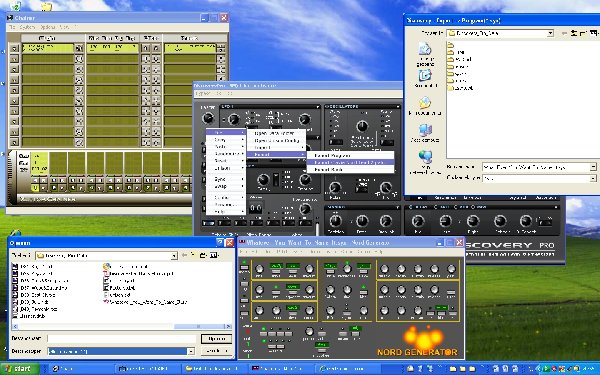

I send a JPG from my computer screen, OS is Windows XP
In the left is Chainer, a VST host, loaded with discoDSP Discovery
In front of it Discovery itself, right clicked on the surface opens File > Export > Export Clavia Nord Lead 2 patch. Left click opens window: Discovery - Export -> Program(*.syx)
I name the file and save.
Then I open NordGen and load the file from the hard disk.
Press Send in NordGen and if the Midi is right the Program is in the NordLead.
Wout
