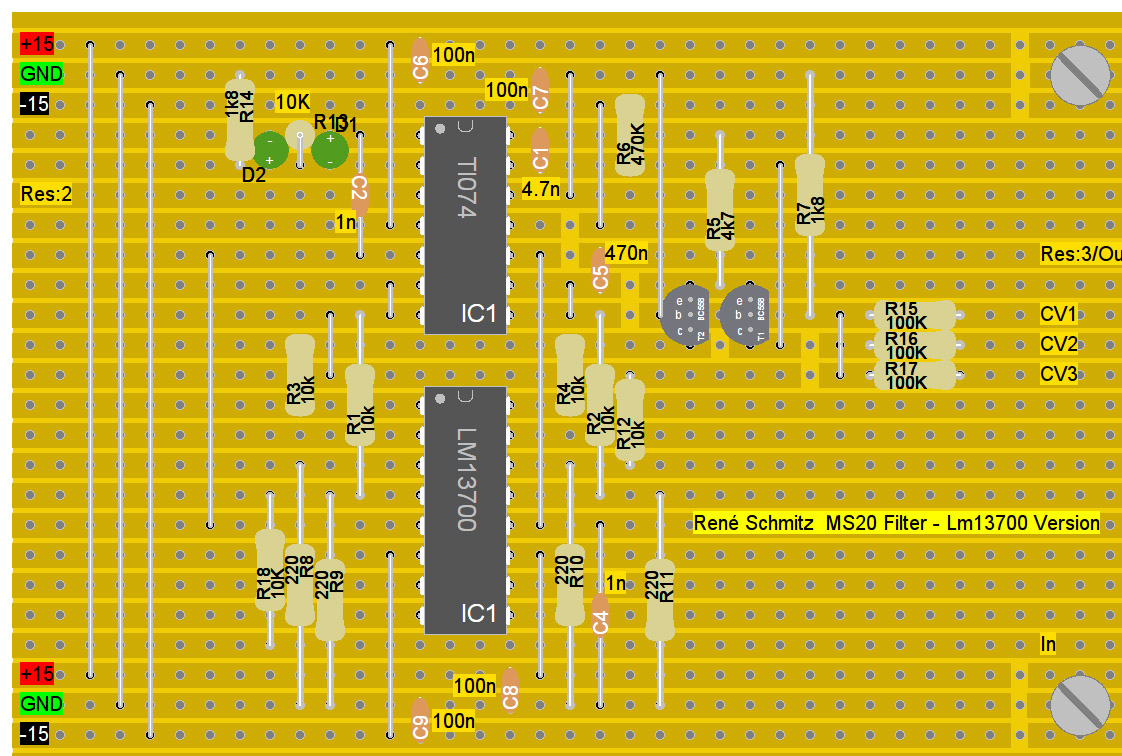

Does anyone here got a veroboard layout for any of these? I've been looking everywhere and I thought I'd ask you kind folks here

Funny I was just working on this one by René Schmitz
http://www.uni-bonn.de/~uzs159/rs20.png
It doesnt have any de-coupling caps and I havnt tested it yet but your welcome to have a go, not everything is labelled but I can get back to you on that -Ben

Sorry if its to late but here it is - still not tested - but I can confirm it soon
Panel Potentiometers
if viewed from the back and lugs counted 1 to 3 connections go like this
Resonance 100K LOG
1 Res:3 - Output jack connect to this lug
2 Res:2
3 GND
Cutoff 4.7K LIN
1 -15
2 -CV1
3 +15
Jacks
Input connects to in
Output connects to pot 1 lug 1
extra cv jacks on CV2 and CV3
a 4,7k potentiometer can be connected across the cv inputs to attenuate it like so
1 - GND
2 - CV1 or 2
3 - CV input jack
Schematic found here http://www.uni-bonn.de/~uzs159/

Cheers! Just hope it works now! D1 and D2 is 0.47uf am I right? |
mark_olson
Joined: Oct 26, 2006 Posts: 177 Location: Lawrence, Kansas
Posted: Thu Nov 04, 2010 6:47 am Post subject:
| Kritical Audio wrote: | | D1 and D2...? |
Green LEDs. |
Clack
Joined: Aug 08, 2005 Posts: 438 Location: Walthamstow - london
Posted: Sat Nov 06, 2010 3:58 pm Post subject:
yes sorry they are green LED's , you can use pretty much any standard signal (1n914, 1n4148 etc) diode though, still trying out how to make lochmaster do clean layouts, might start translating them in illustrator so I can stylize them better. let me know if you get it to work! mine isn't up for soldering for a few weeks as I have to get a vco to work first! -Ben _________________ Clacktronics.co.uk |

| Any confirmation yet? I'm thinking there are meant to be cuts under the three resistors, R15 R16 R17... and one too many solder points on the three hole jumper beside them. |

Should there not be a cut between the two transistors bases as well?

Hey, I've built this with the cuts between the 2 transistors and between the cv resistors, and have also soldered in the base of one of the transistors where on the layout it is floating.
I am wondering if someone who knows can verify these possible errors, if they are?
I've used a charge doubler with 15v regulator and voltage inverter to get +14.55v ground and -14.35v
This should be within range? or does it need to be exactly -15 and +15?
All I get on the output is a quiet whine which gets lower in pitch from when the power is plugged in, then nothing, no output at all, and the leds aren't lighting up either..
Also the pots are connected if looking down on the shaft 1 2 3 L to R
The description says from the back 1 to 3, is that L to R?, and if so have I just reversed the wiring to the pots? It should still work though, in that case? just have opposite control?
Also I've grounded the jacks, but i can't imagine that they should be without grounds?
And can anyone tell me if the power needs to be connected to the board as well as the freq pot?
Have used a TL084 instead of 074, but that shouldn't be a problem afaik.

OK sussed it, funny how the act of asking somehow brings a solution on its own. There is not supposed to be a cut on the layout between pin 11 (TL074) Vee (-15) and the jumper to -15v, which should get the -15 to the chip.
I've used red leds, and the resonance is too much at low settings so I *think* the 10k resistor in the feedback loop needs to be lower? Or I might string 1n4001 diodes to lower clipping level.
Also the BC558's need to be reversed. I've used 2n3906's too which will work orientated the way shown in the layout.
This as well as the cut between the 2 transistor bases and between the cv resistors (just incase for anyone in the same boat as I was building)

Looking at it the LED's are a bit close aren't they!
I will update the layout , how does it sound?

Thanks a lot for the layout clack. I am sure the positon of the two 558- transistors on the stripboard is correct though. It also matches the circuit layout from rene schmitz.
