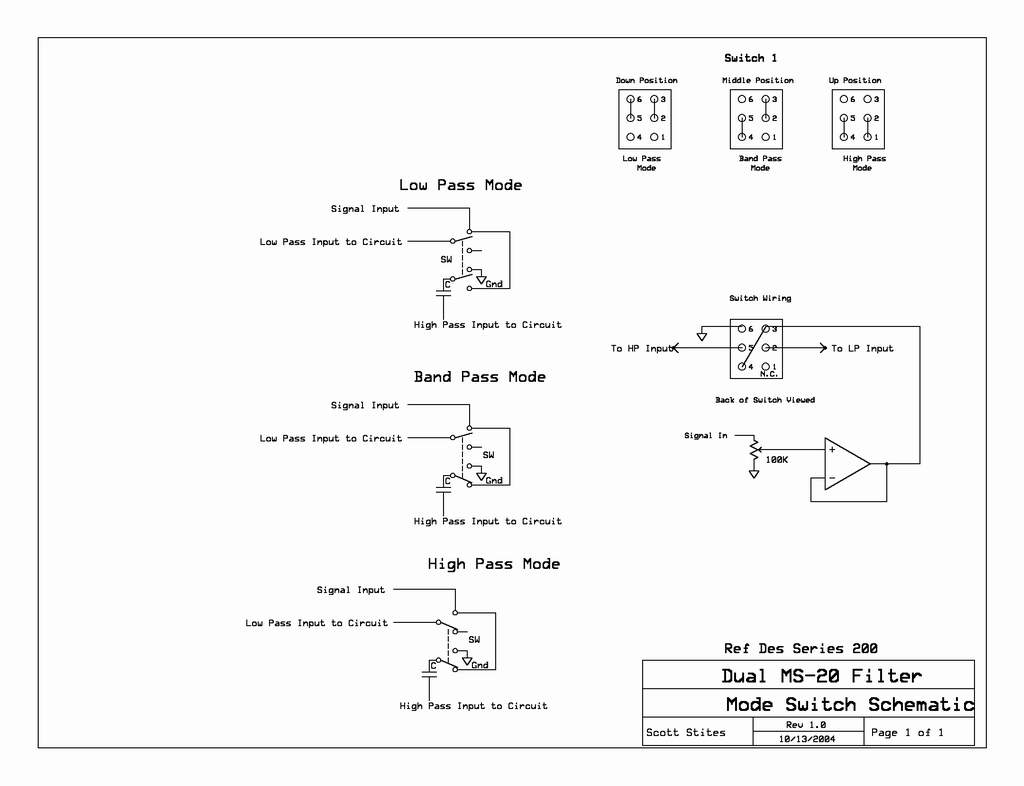

hiya,
I built this and it works great (a few modifications to the layout to get it working) now I would like to add a 3 way switch to change LP HP BP
I have a slide switch (shown below) can anyone translate the wiring diagram for my switch...my brain hurts
cheers.

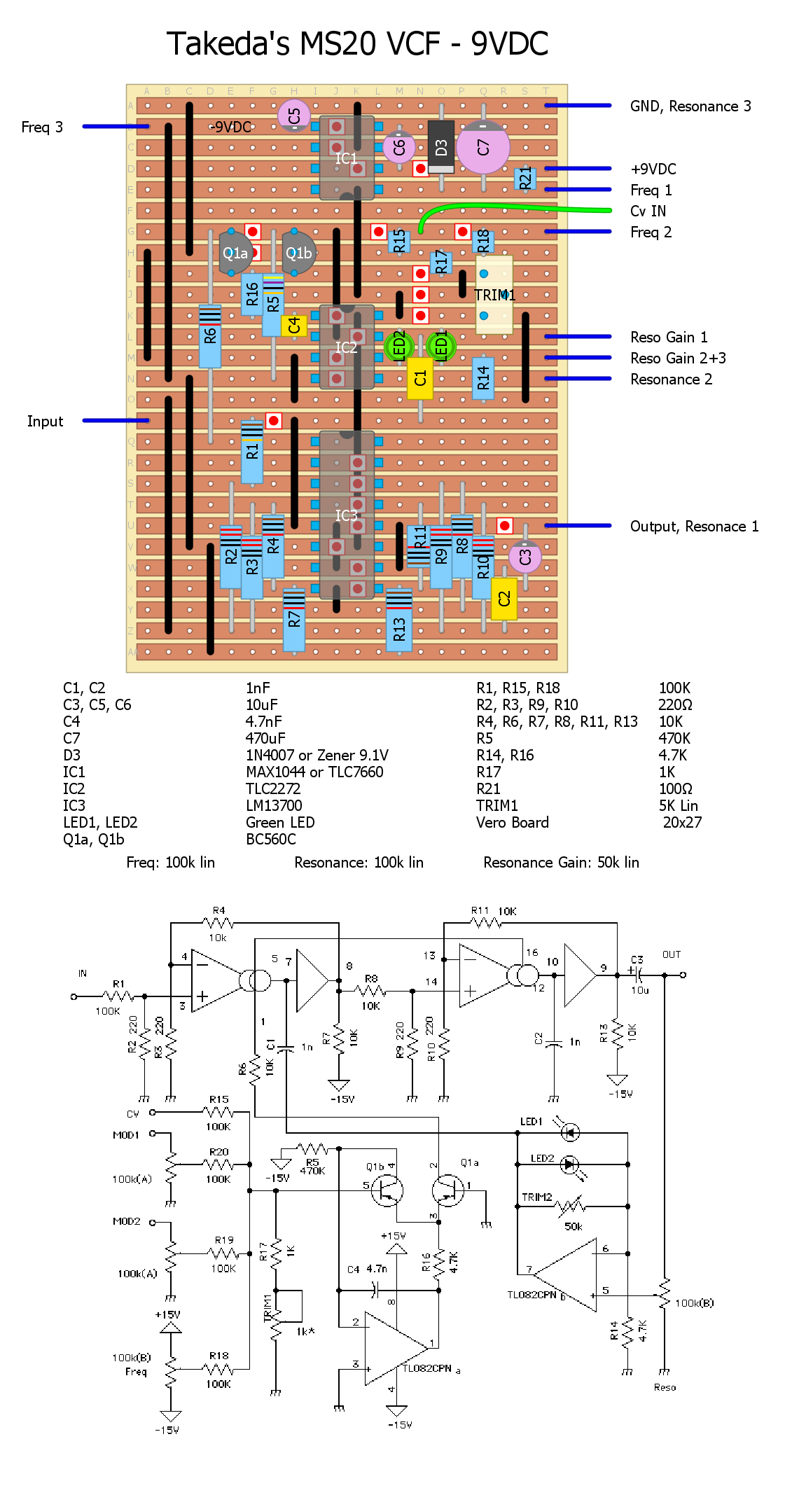

I built a MS20 VCF following this schematic I found on takeda's site:
http://www.aleph.co.jp/~takeda/radio/MS20clone.html
But I have a problem. I used a TLC2272 and a OPA2134 for the dual opamp, transistors are BC560c and I'm powering the circuit with a MAX1044, so that I can get +/-9VDC out of a normal 9V power supply.
I double checked everything and the voltages on the IC seams to be correct but it doesn't work right.
After a while the circuit is powered the sound starts to come out and for a while it works, but after a bit I noticed that with the freq fully turned down, the filter slowly opens! I measured the voltage on the circuit and I found out that on the collector of Q1a (as per takeda's schematic) the voltage slowly arise with the time, resulting in this "self opening" of the filter. Do you have any suggestion what the cause may be?

I found the mistake.. I just forgotten to connect pin2 of the opamp with the 470k resistor going to -15VDC!
Now it works like a charme! I'll post the layout soon.

PostPosted: Fri Feb 07, 2014 3:53 am    Post subject: Reply with quote  Mark this post and the followings unread
here you'll find my layout for Takeda's MS20 VCF. I added a charge pump to use it as a stompbox with a standard 9VDC power supplies (also with -/+9V instead of +/-15V the filter works really well! but you can omit the charge pump part of course).

PostPosted: Sun Feb 23, 2014 4:42 pm    Post subject: Reply with quote  Mark this post and the followings unread
Sorry to resurrect the oldie, but I'm trying to use protoboard for the first time and this seemed like a fairly easy project. I ran into an issue though. trying to read the diagrams on the first page I find a jumper coming off the -15 and I can't figure out what it is for. Can someone explain please?
Also, the schematics are no longer at the link on the initial post. Would anyone have a link?
Thanks much

I'd say that cut to the left of your long rectangle should not be there. If you have already cut this board, you will need to bridge that gap. You could use a piece of resistor leg and solder to the reverse side. Or you could swap R6 and the jumper, then bridge the gap with a three hole horizontal jumper to take the (-)V to pin 11 of the TL074.

The +/- jumpers should be switched on tl074.
Pin 4 to -, pin 12 to +
Google tl074 images
LM13700 is opposite but correct in the last updated layout

I project to make this MS20 filter clone, so I do a new vero layout (smaller, and without the mistakes). I'll post it very soon.
But I don't understand why there are these 100nF (C6 to C9) between +15 -15V and ground, and why put it 2 times ? They are not present in the schematic.
Thanks

Snaper
Joined: Feb 28, 2014
Posts: 217
Location: Hungary
PostPosted: Tue Mar 03, 2015 8:14 pm    Post subject: Reply with quote  Mark this post and the followings unread
I think they are fot stabilizing the power. I usually add 2 10u and 2 100n.

PostPosted: Wed Mar 04, 2015 4:15 pm    Post subject: Reply with quote  Mark this post and the followings unread
Ok thanks snaper.
I finish my layout.
I made 2 versions, one "normal" and one with hoyager's mods.
But I have some questions.
For the "normal" version :
What is the value of C4.1 ?
Switch A1 and A2 are connect to ground, and A3 without connection ?
The DPDT is ON-ON (B1 is Lowpass input, and B3 is Highpass input) ?
For the hoyager version :
Don't understand this : "use an 8.2k resistor from the res3/out to the lug 3 of res pot (as per ms20) " ? (It's a bit confused)
And this : "add a 47k resistor from the hi pass input (gnd end of C4) to gnd ." ? (If I understand, he want to put a 47k in serie with C4 before to go to ground).
I can send you my layouts if you want.
