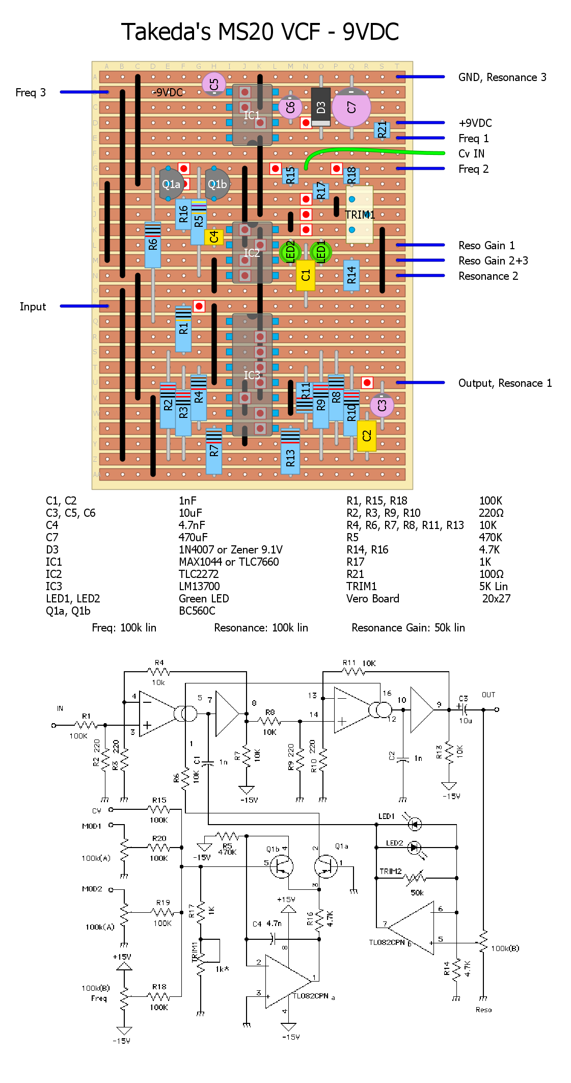

I built a MS20 VCF following this schematic I found on takeda's site:
http://www.aleph.co.jp/~takeda/radio/MS20clone.html
But I have a problem. I used a TLC2272 and a OPA2134 for the dual opamp, transistors are BC560c and I'm powering the circuit with a MAX1044, so that I can get +/-9VDC out of a normal 9V power supply.
I double checked everything and the voltages on the IC seams to be correct but it doesn't work right.
After a while the circuit is powered the sound starts to come out and for a while it works, but after a bit I noticed that with the freq fully turned down, the filter slowly opens! I measured the voltage on the circuit and I found out that on the collector of Q1a (as per takeda's schematic) the voltage slowly arise with the time, resulting in this "self opening" of the filter. Do you have any suggestion what the cause may be?
gila_crisis
Joined: Feb 06, 2014
Posts: 3
Location: Switzerland
PostPosted: Thu Feb 06, 2014 4:07 pm    Post subject: Reply with quote  Mark this post and the followings unread
I found the mistake.. I just forgotten to connect pin2 of the opamp with the 470k resistor going to -15VDC!
Now it works like a charme! I'll post the layout soon.
gila_crisis
Posts: 3
PostPosted: Fri Feb 07, 2014 3:53 am    Post subject: Reply with quote  Mark this post and the followings unread
here you'll find my layout for Takeda's MS20 VCF. I added a charge pump to use it as a stompbox with a standard 9VDC power supplies (also with -/+9V instead of +/-15V the filter works really well! but you can omit the charge pump part of course).

Sorry to resurrect the oldie, but I'm trying to use protoboard for the first time and this seemed like a fairly easy project. I ran into an issue though. trying to read the diagrams on the first page I find a jumper coming off the -15 and I can't figure out what it is for. Can someone explain please?
Also, the schematics are no longer at the link on the initial post. Would anyone have a link?
Thanks much
-minus-
Joined: Oct 26, 2008
Posts: 787
PostPosted: Mon Feb 24, 2014 3:01 pm    Post subject: Reply with quote  Mark this post and the followings unread
I'd say that cut to the left of your long rectangle should not be there. If you have already cut this board, you will need to bridge that gap. You could use a piece of resistor leg and solder to the reverse side. Or you could swap R6 and the jumper, then bridge the gap with a three hole horizontal jumper to take the (-)V to pin 11 of the TL074.
jmcecil
Joined: May 11, 2013
Posts: 20
Location: Prattville, AL
PostPosted: Mon Feb 24, 2014 6:33 pm    Post subject: Reply with quote  Mark this post and the followings unread
hey thanks, that actually makes sense. It's odd because that is the graphic from page 1. If it obviously that wrong, I'm surprised I don't see anyone pointing it out.

I've come across this layout (on page 1) a couple days ago and after fixing a couple things to it the filter is working fine and dandy! If anyone is still interested, here is the redraw.
(Apologies if I've missed this already being posted somewhere, and the spelling mistakes)
A little note just incase you were wondering: I've put in "R13.1" and "R13.2" simply because I liked this exact resistance on the resonance, since it's not too loud now but still you can crank it. You can also fit in a 10K trimpot there if you want.
And this is -12/+12v Very Happy which works perfectly fine.

The +/- jumpers should be switched on tl074.
Pin 4 to -, pin 12 to +
hoyager
Joined: Feb 16, 2010
Posts: 27
PostPosted: Tue Aug 05, 2014 5:24 pm    Post subject: Reply with quote  Mark this post and the followings unread
Google tl074 images
LM13700 is opposite but correct in the last updated layout

Cool, it seems people are starting out building stuff by using this, which I did, so thought it'd better not be misleading
Here's some mods I do on this circuit to keep the res under control, overdrive the input a bit and get the freq pot to behave with a full range.
1. Make R7 2.2k and the link to ground on the opposite transistor, 2.2k as well (as per ms20). So both transistor bases go to ground via a 2.2k.
2. Make the CV resistor from the Freq (cutoff) pot 300k and make R3 and R4, 7.5k (Or don't cut under pins 1 and 16 of LM13700 and use 1 7.5k resistor to both pins).
2a. Use 47n in place of c1 to cut down on some cv bleedthrough (rounds corners of square wav if an lfo is used) - not necessary for manual cutoff control
3. R14 make 2.7k (or 5k trimpot) for self oscillation later in the travel of the res knob and make the res knob 10kb, put a 2.2k resistor across lug 2 + 3, and use an 8.2k resistor from the res3/out to the lug 3 of res pot (as per ms20)
3a. Use 3 1n4148 in series in each direction and 10k in the feedback loop for res opamp (between pins 1 and 2) (as per ms20). I use 1s1555 which are what they used in the original. I think have a different forward voltage curve (going higher than 1n4148 but at a lower rate....) Anyway I think they break up a bit nicer and sound a bit more garbly. This might be due to them being more uneven in forward voltage drop than modern manufactured 1n4148, but again I don't really know.
4. Use a polar 10uf cap for c5 (+ side at - input (pin 9 of TL074))
5. Low pass input resistor R18 make 7.5k for more overdrive and add a 47k resistor from the hi pass input (gnd end of C4) to gnd .This will tie the cap to ground when there is no input, eliminating some switching complexity, although this might require make before break for click-less switching)
6. Lofi opamp like LM348 works well too (along with LF347) can overdrive filter without clipping. I found the TL074 or 072 will shutdown in this situation as buffers if there is too much input (has to be quite a lot, but filter does sound good with quite a lot of input)
7. I use 2.2n's for C2 and C4, and compensate for high freq loss (only very high freq) with 2.2n and 470k in series in feedback loop of an output opamp. If you want a mellower filter just use 2.2n's.
Also in the this last layout, I think the diodes and resistors D1 D2 R13.1+2 are supposed to be 1 line down so they are across pins 1 and 2 of the opamp.

I've recently built 2 of These ms20 VCF's with the lm13700 but the second one didn't want to oscillate properly...
following Rene's schematics i've used the latter suggested design (mostly what Hoyager did) with 2,2n caps instead of 1n, and with the 8,2k and 2,2k resistors placed at the reso-pot.
also i used a 1,8k resistor and 5k trimmpot to the inverting Input of the Feedback stage of the opamp...
the resistor of the summing stage after the freq-pot is 150k and the resistor to gnd at the base of the trannie is 680 ohms instead of 1,8K.
the Output cap is 22uF instead of 0,47 and reso pot is 10k...
Also added is a pot for the Input Signal.
That said my first filter worked very well but the second wont oscillate or just with a minimal effect on Sound when reso is turned fully on...
checked the 2nd one a couple of times but couldn't find the mistake... then compared it with the first one and found that on the first one i accidentally reversed 2 of the Diodes in the Feedback path...
I used the design with 2 rows of 3 diodes...
when you revert one of them in each row you get a very cool sounding effect... just using link instead of 2 diodes in each row didn't work for that...
maybe some of you want to try this "trick" with the diodes it sounds really good...

I project to make this MS20 filter clone, so I do a new vero layout (smaller, and without the mistakes). I'll post it very soon.
But I don't understand why there are these 100nF (C6 to C9) between +15 -15V and ground, and why put it 2 times ? They are not present in the schematic.
Thanks
It's an old post, hope someone follow it yet.
Snaper
Joined: Feb 28, 2014
Posts: 217
Location: Hungary
PostPosted: Tue Mar 03, 2015 8:14 pm    Post subject: Reply with quote  Mark this post and the followings unread
I think they are fot stabilizing the power. I usually add 2 10u and 2 100n.
Thelonious
Joined: Mar 03, 2015
Posts: 5
PostPosted: Wed Mar 04, 2015 4:15 pm    Post subject: Reply with quote  Mark this post and the followings unread
Ok thanks snaper.
I finish my layout.
I made 2 versions, one "normal" and one with hoyager's mods.
But I have some questions.
For the "normal" version :
What is the value of C4.1 ?
Switch A1 and A2 are connect to ground, and A3 without connection ?
The DPDT is ON-ON (B1 is Lowpass input, and B3 is Highpass input) ?
For the hoyager version :
Don't understand this : "use an 8.2k resistor from the res3/out to the lug 3 of res pot (as per ms20) " ? (It's a bit confused)
And this : "add a 47k resistor from the hi pass input (gnd end of C4) to gnd ." ? (If I understand, he want to put a 47k in serie with C4 before to go to ground).
I can send you my layouts if you want.
Thanks
