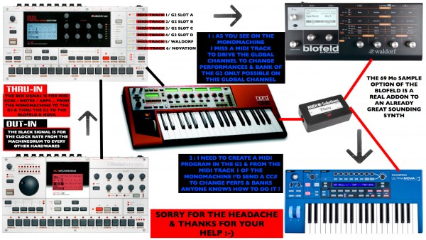

can't make myself clear so see the picture attached ;-)

i browsed many threads about midi in the g2 but i couldn't find an answer to my question ... sorry if it's been asked before
 Filesize:  1.82 MB
 Viewed:  244 Time(s)
Posts: 24500
PostPosted: Thu Dec 01, 2011 2:42 pm    Post subject: Reply with quote  Mark this post and the followings unread
Ah, right - now I do understand the question ... not enough tracks available ...
Hmm .. should not be too hard ... as there is a PC send and a CtrlSend you can chain these modules from the send output to the send input of the next one - this determines the order in which the messages will be sent - when the first one is done the second one in the chain will start.
When you want remote control for what PC and banks select they send you'll need morphs on the Value knob and the Program knob. Then assign a CC value to the morph knobs ...
To trigger when things get sent you probably want to use CtrlRcv module.
Does this help?

thanks a lot ... i've been trying these midi module for few days ... the problem is that i'm stuck every time i try to send midi datas from any slot to the global channel ... weird ... the global channel is active & i have no problem to send a data to any of the 4 slots ... i just have to find the good way to chain the midi modules now you pointed the midi modules as well ... i shure miss a way to connect them properly ... so i go back to the editor & i keep in touch as soon as i sort it out ... thanks to you & electromusic to share such a huge database.
Posts: 24500
PostPosted: Thu Dec 01, 2011 5:56 pm    Post subject: Reply with quote  Mark this post and the followings unread
Right ... starting to understand the problem better now ... maybe Laughing
It is not possible I think to make a patch that changes itself for another one ... I've needed a 2nd G2 to do stuff like that.
Maybe performance mode is not a good idea then ... in patch mode I think you could send program changes and bank selects to the channel associated with the individual patch.
Is that a better idea?

Hmm .. or maybe it is .. with a MIDI merger and a G2 sending MIDI to itself via the hardware/external MIDI connectors .. never tried that Shocked

thanks guys for your help,
so ... everything works on all slots (in a midi module / scroll down menu / channel this & slots A to D works in perf mode) but apparently you can't send any data to a "numerous" midi channel without plugin a midi cable. The midi merger is quite a good idea as i'm kind of familiar with weird midi chaining. The prg change works in patch mode but the bank change doesn't / only in perf mode.
& if i stay in patch mode i'm stuck with only 128 patches when the perf mode loads any patches from any of the 32 banks that's why i'm trying to sort out this perf mode.
i'll try the midi merger or i'll drive a synth from the machinedrum ( no arpegiator ) thru the monomachine to get an extra midi track for the global channel.
