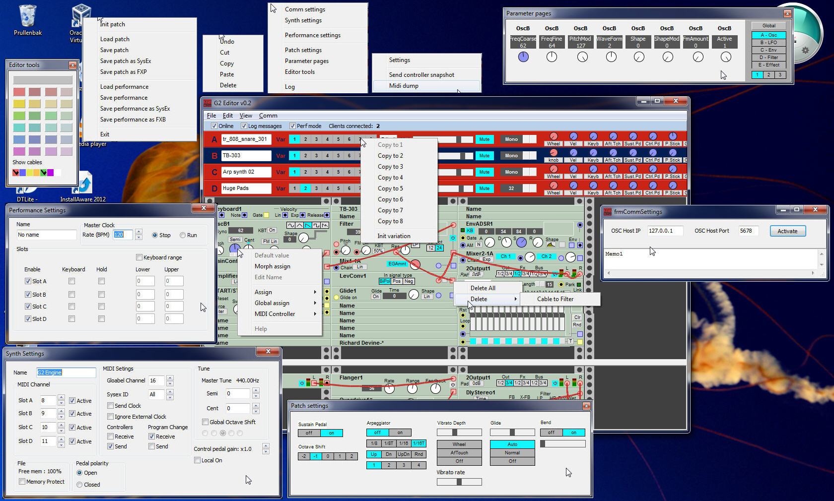

Thanks, I enjoy working on this, I find it very satisfying to find out bits and pieces and putting it in the software and then to see it actually work.
This weekend I did the performance dialog and the global knob assignments. My plan now is to try to put in as much as possible of the missing functionality the coming months. It's surprising to see how much functionality there is, things I've always taken for granted. So this is what's missing at the moment:
Select, cut, copy past part of patches
Undo, redo
Auto assign midi
Sysex functions
Bank/patch manager
Choose module color
Show/hide cables
Edit name of modules/parameters
Module text functions
Module graphic screens
Multiple g2 support
Memory used indicator
Virtual keyboard
Patch adjuster
Patch mutator
I'll do the cut/copy/past stuff first, because that may involve another round of software restructuring.
I'm not going to try the patch mutator. I think that would be very difficult and take too much time. Memory used is also difficult, don't know if I can make that 100% accurate. Multiple g2 support, don't know yet. Undo/redo might be difficult too, don't know yet how this is done with the usb messaging.

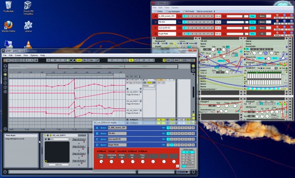

Then there is extra functionality that isn't in the original editor:
a Vst
OSC support
With the vst you can automatically load patches with an ableton project for example. This is done using FXB files, but maybe there are alternative solutions. And with the vst you can automate the parameters. The parameter change messages are send over tcpid to the editor and then over usb to the g2 in stead of using midi.
So I could try to make a translation layer for sending the parameter change messages between vst and editor in osc format. Then you could also communicate with other osc devices with the editor.

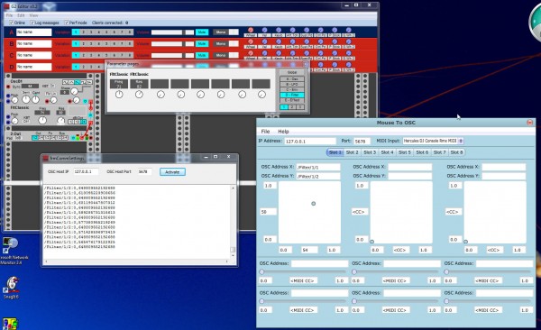

Ok, made a bit of progress with the Osc. I didn't get the tool you suggested to work jk, but found another one "Mouse to Osc" by www.niallmoody.com. And joreg http://opensoundcontrol.org/implementation/delphi-osc already made a port of the osc implementation to Delphi, so that's great.
Here is a screenshot. Maybe someone has a suggestion how to format addresses in the G2? In the example I address the parameter pages as "/<parameter>/<page>/<button>".
The Osc uses the UDP protocol, what I've read about it is that it doesn't guaranty the delivery of the message, so in the editor it can only be used for messages that aren't critical, that's the responseless messages:
- select module parameter
- set module parameter value

Ok Derek, I will keep the TCP-IP connection for the Vst then. That holds a copy of the patch that must be in sync with the editor.
Thought some more about the Osc addressing structure, it should of course be structured so you have access to all functions in the g2 or multiple g2's. You should then be able to create the knobs panel of a g2 on a touch device. Maybe something like
/1/patch/2/var/3/par/A/1/3/set 70
-> set the value of parameter on parameter page A, column 1, knob 3 of variation 3 in patch 2 of g2 synth 1 to value 70 Cool
or
/1/patch/2/var/3/par/A/1/3/morph -20
-> set morph value of the same parameter to -20
and maybe
/2/bank/2/patch/4/load 1
-> load patch 4 of bank 2 in slot 1 of g2 synth 2.
Don't have much experience with Osc, so any suggestions are welcome.

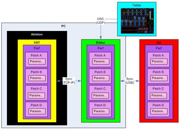

I'm not sure if I fully understand your question, but I made a little picture with the configuration. So on the right is the G2 that holds a performance and in the performance are max 4 patches that hold the parameters.
On the PC is the editor and possibly ableton with one or more Vst's.
The editor and the vst also both keep a copy of the performance and all the patches.
All the copies have to be sychronised, so if you would for example have mapped a Midi CC to a particular parameter, and you turn the knob than the following things happen:
- The G2 receives the Midi message and changes the parameter value
- Then it sends a USB message to the editor
- The editor receives the USB message and also changes the parameter in the appropriate patch (that doesn't have to be the patch that is currently visible in the editor, could be another one)
- The editor then sends on (broadcasts) the parameter change to all the clients (VST's) that are connected to the editor via TCP-IP
- The Vst receives the message and also changes the parameter value in the appropriate patch.
So with the OSC interface you could for example connect a tablet with Touchosc for example. There you make a slider and you want to map the slider to a parameter of a patch in slot B. That doesn't have to be the patch that's currently visible in the editor. The only thing necessary is to provide the editor with enough info so it can find the parameter, for example:
- The slider is mapped to address /1/patch/2/var/3/par/A/1/3/set
- So when you move the slider it sends a OSC message to the editor /1/patch/2/var/3/par/A/1/3/set 70
- The editor receives the message and finds out which parameter is mapped to the knob 3 on parameter page A 1 of Patch in Slot 2
- It sets the value of the parameter to 70 in variation 3
- than it constructs an USB message that looks like [Slot][Location][Module][Param][Variation][Value] and sends it to the G2
- it also broadcasts the same message to alle the Vst clients
Looking at the USB message, it might even be possible to change a parameter of another variation than is currently selected in a patch, although that might not be very usefull.
In any case, for the editor understand the osc messaging, some kind of syntax/structure has to be decided.
What i would like to know for example is how to address a particular slot, should that be /Slot/2/... or /Slot2/... Maybe these OSC devices have some means of constructing adsresses dynamically, for example a slider is mapped to adress /a/b/.. but if you push a button then the slider is mapped to a/c/.. and so on.
If you take for example the knob panel of the G2 Keys, there are 8 knobs that address different parameters depending on wich parameter page you have selected. If you want to recreate that on a touch device, you have to be able to dynamically construct the address.
I hope this makes some things clear?

PostPosted: Wed Jan 04, 2012 6:32 am    Post subject: Reply with quote  Mark this post and the followings unread
Thank you. What I did not understand was the "Patch" in your OSC address path: it may be better to call it "Slot".
If the USB protocol allows edition of parameters in other variations independanlty, then it is useful to reflect this in OSC. But it will be completely useless if you can only edit the current variation...
A typical use of this feature would be to change a parameter value for all variations and not only for the selected one. I really miss this feature on the current editor (or may be I am missing something).

PostPosted: Wed Jan 04, 2012 6:59 am    Post subject: Reply with quote  Mark this post and the followings unread
Ok, yes I undestand your question now. I choose Patch in stead of Slot because a parameter only makes sence in relation to a patch. And a slot can hold a patch or be empty.
I will look tonight if I can change a parameter value in all variations at once with usb messages.

Tested it: when I send 9 messages, one for each variation, the parameter gets updated in all variations.
I also don't know if this is already available somewhere on the g2 or the original editor. If not then it will only be a feature thats available through this editor. The drawback off that is of course that you have to connect a pc/laptop to the g2 to be able to use it.

Here's an update of what I've been up to with the software development. In the editor I've put in that knob to edit all variations at once (Edit all, it just sends 8 parameter changes in stead of one)
Furthermore, the functions to change module color, show/hide cables, a couple of sysex functions: load/save patch/performance as sysex (thanks to Jan's code), command to the g2 to dump a sysex of the current patch or all assigned controllers.
As you can see I've made an overview of all the screens and menu's that are in the editor at the moment.
Now I'm working on the Vst. Initially I had a Vst that represented a slot. You could load a patch into the Vst with an FXP (Vst program) file or a Performance with an FXB (Vst bank) file.
So if you would use 2 slots, you would load two Vst's into the host. But what if you loaded a performance in one and another performance in the other? The last one loaded would just overwrite the first one. What if you would have automated a couple of parameters, and than would mistankenly change the slot the vst was pointing to. So all would lead to error and confusion.
Therefore I thought it would be better that the Vst would represent the whole G2. So for one G2 you only would need one VST. To automate parameters, you have to assign them to the global parameter pages. You can automate 120 parameters that way. In ableton, there seems to be a limit on the number of parameters, when I try to define 4*120 parameters it doesn't accept the vst anymore.
You also load FXB in stead of FxP, so performances in stead of individual patches.
I think this will be better, also the load on the host will be less.
The last couple of days I've put a lot of time in making the code thread save for the vst or multiple vst's, so no global data, but everything tucked away in objects that are created en destroyed within the thread itself and so on.
