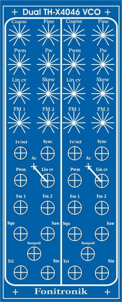

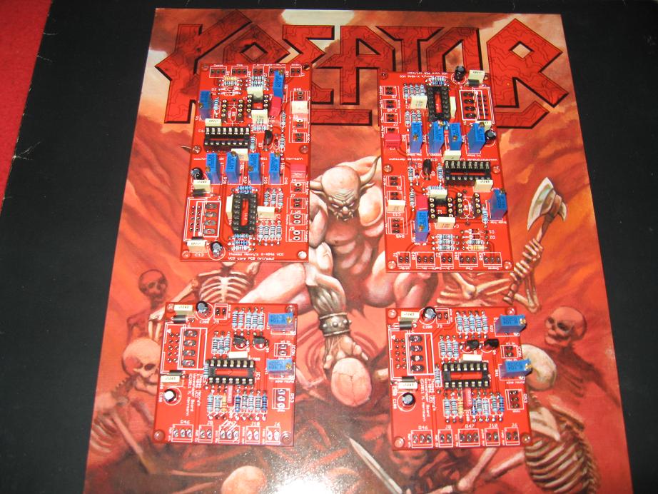

Hi there , im working on 2 sets of pcbs i got posted over from Fonik , ive finished the panel layout (100mm x 250mm) for a dual vco for my modular system.
Finished the populating of components on each board , now ready for wiring Smile , i need to get down to the sign / print shop in town to get the panel vinyl stickers done for this module & some others im building.
 Filesize:  138.27 KB
 Viewed:  733 Time(s)
populated pcbs
 Filesize:  132.84 KB
 Viewed:  744 Time(s)

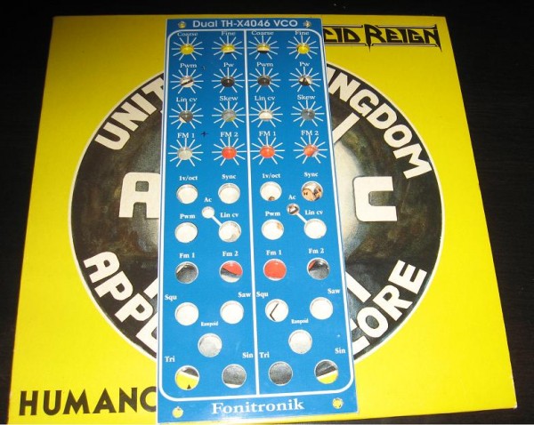

Hi .
Panel drilled at weekend , 3mm thick aluminium 100mm by 250mm , drilled and sticker applied .
The sticker is plain adhesive white vinyl with all the blue bits lazered on at a local sign maker / printers shop.
The aluminium is an offcut i got at a local engineers/machine workshop cut to my size on a big hydraulic guillotine.
Next , decorate with pots & sockets then wire up.
Dave.
 Filesize:  97.46 KB
 Viewed:  721 Time(s)
PostPosted: Tue Aug 21, 2012 1:39 am    Post subject: Reply with quote  Mark this post and the followings unread
i think i will have to try this adhesive vinyl, too... seems to be a great option for DIY.
Posts: 1225
Audio files: 160
PostPosted: Sun Aug 26, 2012 12:14 pm    Post subject: Reply with quote  Mark this post and the followings unread
Hi Matthias , vinyl stickers are easy to use , just peel them off the backing and dab soapy water with a sponge to de-activate the adhesive to allow the sticker to be straightened on the panel, then leave to dry for a day or two , the air bubbles slowly disappear Smile
Dave.

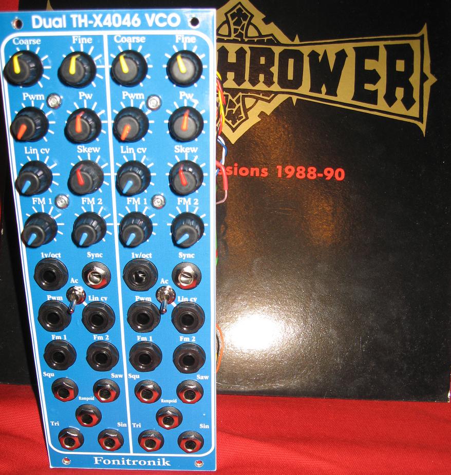

Hi again.
wired up one of 2 vco's , powered up with no problems , cool chips (good sign) Smile , ive set the triangle shape + offset / saw offset & sine shape,
all looking ok on my scope , next job , read the tuning description on Scott Stites birth of a synth pages, handy tuning hints from Scott & Thomas Henry.
pic of dressed panel with one set of pcb's wired up for testing.
more in a week or 2.
Dave.
 Filesize:  170.1 KB
 Viewed:  680 Time(s)
PostPosted: Mon Aug 27, 2012 2:04 am    Post subject: Reply with quote  Mark this post and the followings unread
thumleft
that's how it should be!
