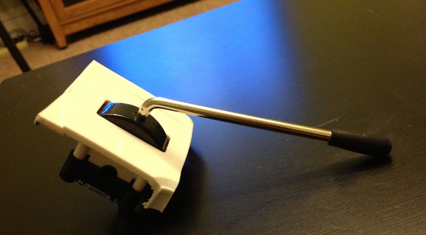

axg20202 wrote:
The tough part of the design will be the volume control - there is no simple solution for this. It's a shame the guy that posted his coloured film button design only stopped by to post that one comment and photo but no details.
I use breath control for volume on these instrument types, but of course that's not going to be common or easy to set up.
I actually liked the simplicity of the volume control on Wendy Carlos's Circon used in "The Shinning"... a simple pot with a lever on it that used a rubber band to return. I was thinking of putting that together and stumbled upon the idea that a device might already be out there (and in abundance) that was designed for this kind of thing. Sort of.
And so I found a reason to actually buy a Guitar Hero controller ($5 at a 2nd hand shop) and wired up the whammy bar's pot to my Moogerfooger CP-250. It worked nicely, as is.
I was surprised how well this controls synths with direct CV modulation...
It seems the orginal volume button on the Martenot was exceptionally responsive, and I don't know how close this comes. It's also no where near as nice as a breath controller. But it was musically effective and smooth, even with very wide modulation (though not shown in the vid).
I think this could well modulate volume/brightness for a Martenot controller.
Here's the short demo vid. I was kind of surprised this works so well.
http://www.youtube.com/watch?v=aqPcIm3v8O8&feature=youtu.be
and some pictures...

PostPosted: Wed Apr 24, 2013 3:00 am    Post subject: Reply with quote  Mark this post and the followings unread
Brilliant!
Edit: ...and so much more fluid than the rack and pinion method I was thinking about.....

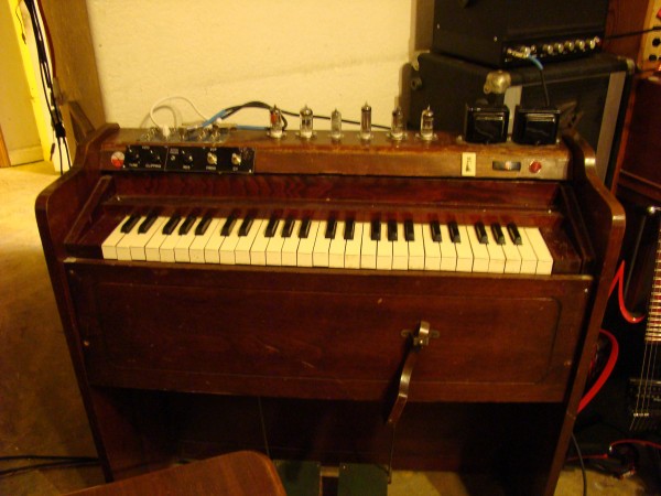

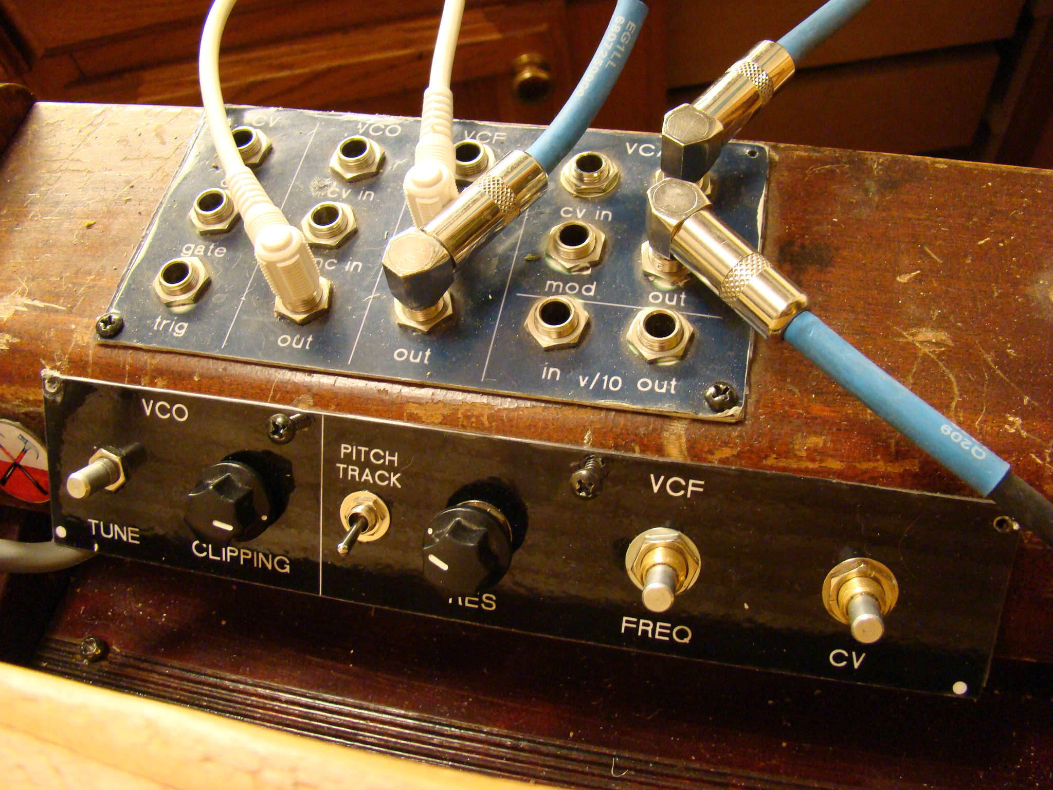

tojpeters
Joined: Feb 04, 2013
Posts: 22
Location: cali (far north)
PostPosted: Fri May 03, 2013 11:36 am    Post subject: here's mine Reply with quote  Mark this post and the followings unread
this it what I'm working on. just a rough draft, I'm making a couple changes.

Infrablue
Joined: Dec 29, 2011
Posts: 131
Location: Utah
PostPosted: Sat May 04, 2013 6:30 pm    Post subject: Reply with quote  Mark this post and the followings unread
tojpeters , this is looking so cool. Check out those tubes... can't wait to hear this instrument!
tojpeters
Posts: 22
PostPosted: Sun May 05, 2013 7:04 am    Post subject: Reply with quote  Mark this post and the followings unread
The design for the tube synth is by Eric Barbour from the CGS site with some minor changes. Just a rough first try to check concept and gearing. I now need more parts. I was going to use 1 pot to control the anode voltage on the vco tube and the other to sweep the filter in a pitch tracking way. But the filter sweep needs to be 60% of the range of the frequency pot,and I can get more range by using the second pot to control grid voltage. The keys send cv to the grid also.When using the ribbon I unpatch the cv from the keys to the vco and just use the keys to send gate signal.The freq pitch control will be handled by a third pot/pulley to get the gearing closer. This works great so far. Still experimenting before I decide on final design. I was going to mount a FSR408 touch sensitive resistor in front of ribbon for modulation/gate but now I'm not sure it is necessary. next I need to hook up my tuner and mark out all the c notes and see if they are consistent sweeping both up and down.

PostPosted: Mon May 06, 2013 10:22 am    Post subject: Reply with quote  Mark this post and the followings unread
Infrablue wrote:
I found a reason to actually buy a Guitar Hero controller ($5 at a 2nd hand shop) and wired up the whammy bar's pot to my Moogerfooger CP-250. I think this could well modulate volume/brightness for a Martenot controller.
Could you shed some light on how this was wired up? Was it literally wired as a volume control on the audio signal or did you have it rigged up to actually control CV for, perhaps, a VCA? I'd like to implement the latter and thinking about how this pot/lever arrangement could do it without having to send the audio from the synth to the controller and back again.
Infrablue
Posts: 131
Location: Utah
PostPosted: Mon May 06, 2013 10:41 pm    Post subject: Reply with quote  Mark this post and the followings unread
axg20202 wrote:
I hooked it up by sending the three leads of the Guitar Hero pot through a TRS quarter inch jack - ended cable to one of the powered CV inputs of a Moogerfooger CP-251. This powers it and let's it be output as a CV out basically. Another way of looking at this is... it fully takes the place of Moog's EP-2 Expression Pedal. So any input that uses that sort of standard pedal will use this as a control source.
You could also send it to replace various pots in a modular module and that would translate to VCA or a simple CV etc.
I plugged it right into the expression pedal input of my A6 Andromeda and it worked right there as well.
I was surprised how nicely it worked as is with the pot it came with.
