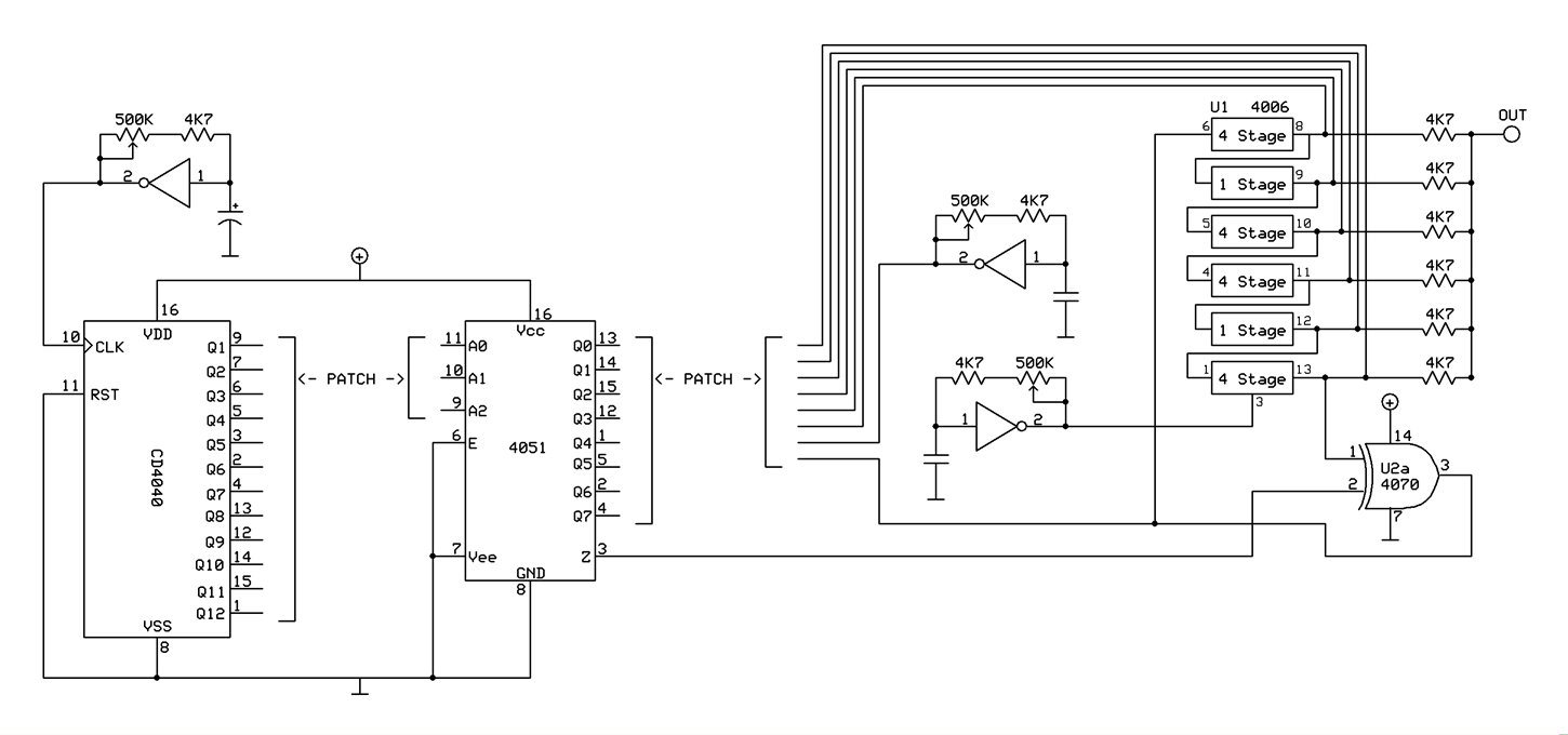

I did however do another test. I used one XOR with it's output connected to the input of the waveshaper,
and one of its inputs to the last ouput of the 4006. I noticed that by attaching the other input to different
outputs of the 4006 I could get what sounds like different notes. So I hooked up a 4051 controlled by a 4040
to create a melody (if you can call it that). I think it actually works kinda similar to 4017/4051 melody generator
and a PIC experiment I just did)
I'm still cutting up the recording but I've posted the first cuts here
and here's a schematic which shows what I did, or at least part of it,..

PostPosted: Tue Jun 19, 2012 12:35 pm    Post subject: Re: CMOS Waveshaper + 4040 4051 test
Subject description: The saga continues
and I have enough things to finish as it is to start on another (big) project.
So do I, so please stop distracting me with all these cool-sounding circuits that I just have to try ASAP! Smile
Anyway, I checked out the sounds you posted, and they sound great.

PostPosted: Wed Aug 30, 2017 9:59 am    Post subject: Reply with quote  Mark this post and the followings unread
what do you thing this would look / (sound) like with the 4046s out of sync?
Posts: 5907
PostPosted: Thu Aug 31, 2017 6:40 am    Post subject: Reply with quote  Mark this post and the followings unread
Nice idea, not sure what it would look/sound like. For the first one it would probably be interesting when
the frequencies are close together. For the second one you'll need some pretty precise resistors so I don't
know how well that would work. I don't think it would be as interesting as the first setup though. but I might
be completely wrong.
