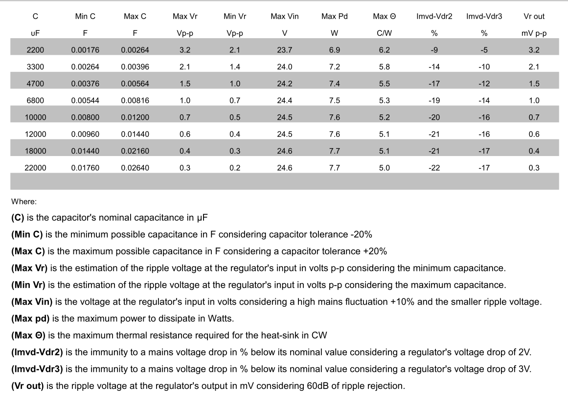

PostPosted: Thu Jan 30, 2014 8:25 am    Post subject: Reply with quote  Mark this post and the followings unread
The ripple at regulator's input (II): The size of the capacitor.
We have already discussed about the ripple voltage in the post "The ripple at regulator's input" in the previous page and know that there is a linear relation between the ripple voltage and the filter capacitor value.
Vr=(0.007*Iout)/C
But... what is the optimal ripple voltage at the regulator's input? and, what is the capacitance required to achieve it?
A small ripple voltage at the regulator's input (versus one large) implies the following:
-A smaller ripple at the regulator's output. (Good)
-Higher immunity to mains voltage drops. (Good)
-Higher voltage at the regulator's input, thus more power to dissipate. (Not good)
-A larger capacitor.
----A larger capacitor use to have higher current ratings (Good)
----We can expect a larger size and higher cost. Although I don't consider these in our context, where we may build a few power supplies and that we assemble them in big cases.
Let's see, through an example, how much the ripple affects to those parameters. Let's pick up several capacitor values and estimate several parameters and write it down in a table
The example is again our PS1 assuming the following:
General:
Voltage Output =15V
Current Output=0.8A
Forward Rectifier Voltage Drop=1V
Crest Factor of the wave at the secondary=1.3
Voltage across one secondary=18VAC.
To estimate the power dissipation:
A high mains fluctuation of 10% over its nominal value.
A capacitance 20% over the nominal value of the capacitor due its tolerance.
To estimate the maximum thermal resistance required for the heat-sink:
Ambient Temperature=40C
Junction to Case Thermal Resistance=5C/W
Case to Heat-Sink Thermal Resistance=1C/W
To estimate the immunity to a mains voltage drop:
A capacitance 20% below the nominal value of the capacitor due its tolerance.
Looking at the attached table:
From the 2200μF to the 10000μF rows:
Look at the immunity columns. There is a great improvement (From -5% to -16%) or (-9% to -20%)
However, if we look at the column of the heat-sink's thermal resistance required, it decreases 1C/W.
From the 10000μF and the 22000μF rows:
There is not remarkable variations in the immunity nor in the thermal resistance.
Consider, also, that each time that the capacitance is doubled, the ripple voltage is halved.
Then, notice that once the estimated maximum ripple input is smaller than 1Vp-p, to double the capacitance does not produce considerable variations.
So what?
One rule of thumb could be to calculate the needed capacitance for a maximum ripple voltage of 1 Volt p-p. (considering capacitor tolerances)
C=(0.007*Iout)
But there is a more easy rule of thumb:
Give at least 10000μF (or the very next higher standard value) for each 1 Ampere of power supply output.
Examples:
For a 0.2A power supply give at least 2200μF for the filter capacitors.
For a 0.5A power supply give at least 5600μF for the filter capacitors.
For a 0.8A power supply give at least 8600μF for the filter capacitors.
etc..
 Filesize:  174.34 KB
