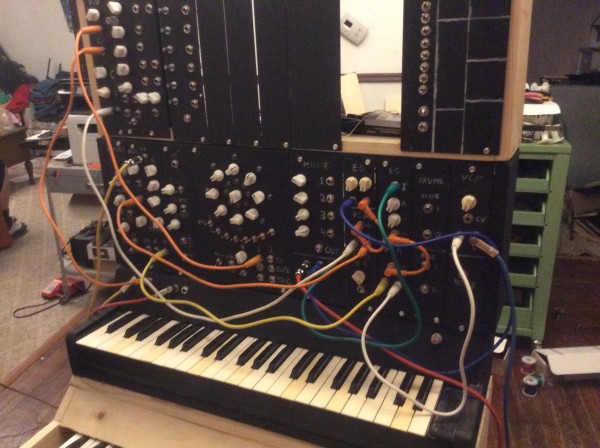

PostPosted: Tue Nov 22, 2016 5:54 pm    Post subject: Reply with quote  Mark this post and the followings unread
I know this is an older poste, but I was curious if you ever got this going flareless? I'm currently building one on perfboard.

PostPosted: Tue Nov 22, 2016 6:46 pm    Post subject: Reply with quote  Mark this post and the followings unread
Thanks flareless.
I will check out your build link.
The key to building on perf is to design your modular with really big modules.
At 10 inches tall (25 cm) my modules can take really big perf board. This looks pretty easy to perf for my synth.
