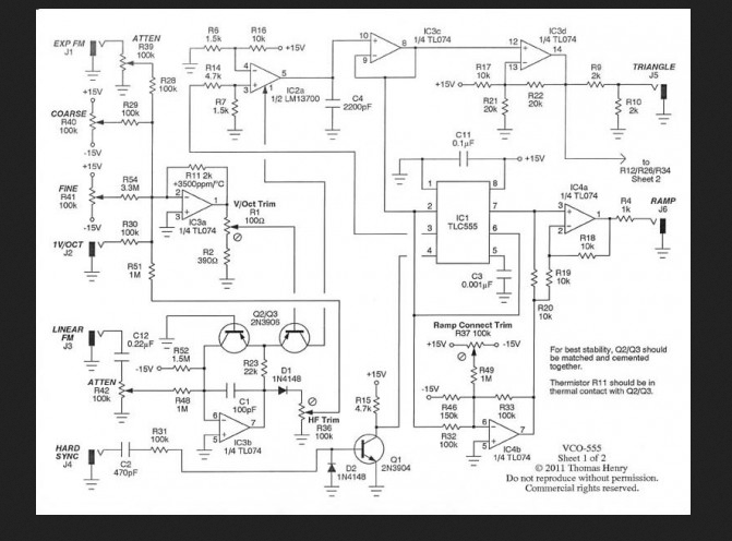

hello everyone.
self -explanatory title.
MY newly built 555 VCO exhibits a remarkable volume amplitude fluctuation depending on the frequency i set it to.
It gets louder as the frequency increases.
the effect is most pronounced with the triangle wave, as ,at low frequencies its is almost inaudible.
What might be wrong? i Suspect this is not a normal behavior !
thanksfor any suggestions

Can you show us a full schematic?
What it reads like is something similar to a VCO passed through a low pass filter, but you don't mention a filter. Have you measured the voltage of the output with an oscope?

i just wondered what the correct signals output levels were supposed to be like in the Thomas Henry 555 VCO.
I measured the output voltage with a digital multi meter, and observed the waveforms on the oscilloscope.
Can't remember whether or not they significantly changed in amplitude, when sweeping the frequency. Tomorrow i'll take a closer look !
I'll attach the schematics.
So, do you reckon that a steady amplitude on the scope, regardless of the frequency, means that everything is ok?
Or, do voltage outputs have to be measured with a DMM for a better response?
thanks

and yes, there's also part 2. However, i left out the sine wave part.
I only implemented the pulse wave !
i forgot to tell you guys that when sweeping the frequency knob not only did the perceived volume varied , but also the output voltage levels fluctuated !
Roughly , on low-mid frequencies triangle and sine the DMM reads 2 V output. When increasing to high frequencies the DMM reads about 4 volts.
Double as much.
that's what made me wondered what the hell is going on here ! Smile

I don't know exactly but i guess measuring the voltage with a DVM on a changing frequency output is not the best option, on the scope you can see level changes better.
What came into my mind is the HF-trimmer, might have something to do with it, as far as i understand it has something to do with compensating for lower Levels at high a constant output, might have to do with how it's generated: with an comparator as Long as the triangle output is over the treshold the comparator output Switches from rail to rail and giving a stable voltage out via the resistro divider at it's output...
But at least that would be the opposite from what your telling...
Also interesting, regarding the Square output, would be to know if the square frequency output also changes or at least the pulsewidth...
As with variable treshold via the triangle with changing Amplitude this could occour too, without changing the PWM manually or by CV...
...And at least, know my memories came back, there was an issue with the sine output being a bit low on some builds, which Fonik solved. There is a thread regarding this at the Forums here... Looking at my printed schematic the 100k R34 in the sine shaper is reduced to 56k, i guess that's how it ended up in my build, but i'm always a bit lazy with documenting my changes.
