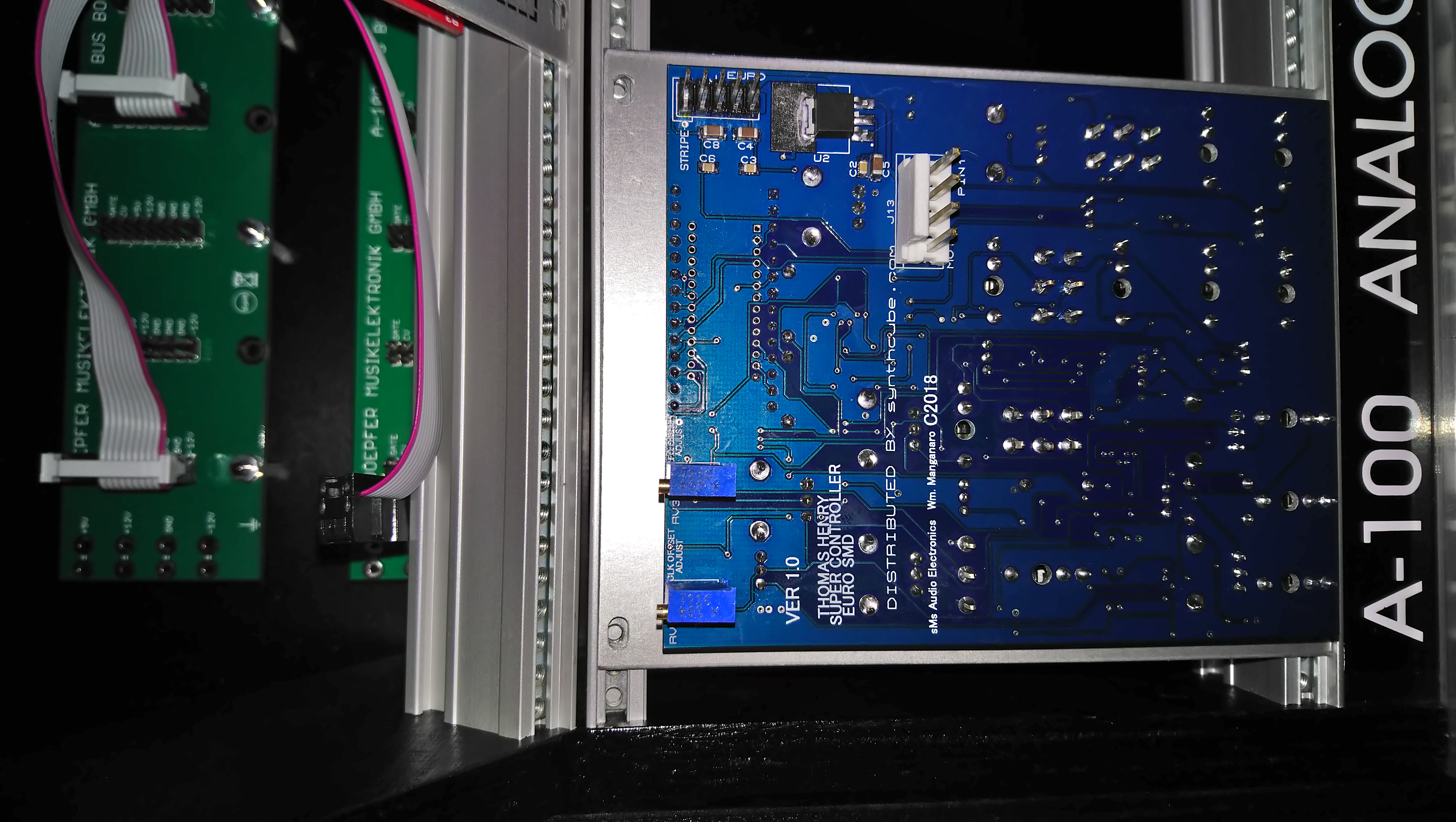

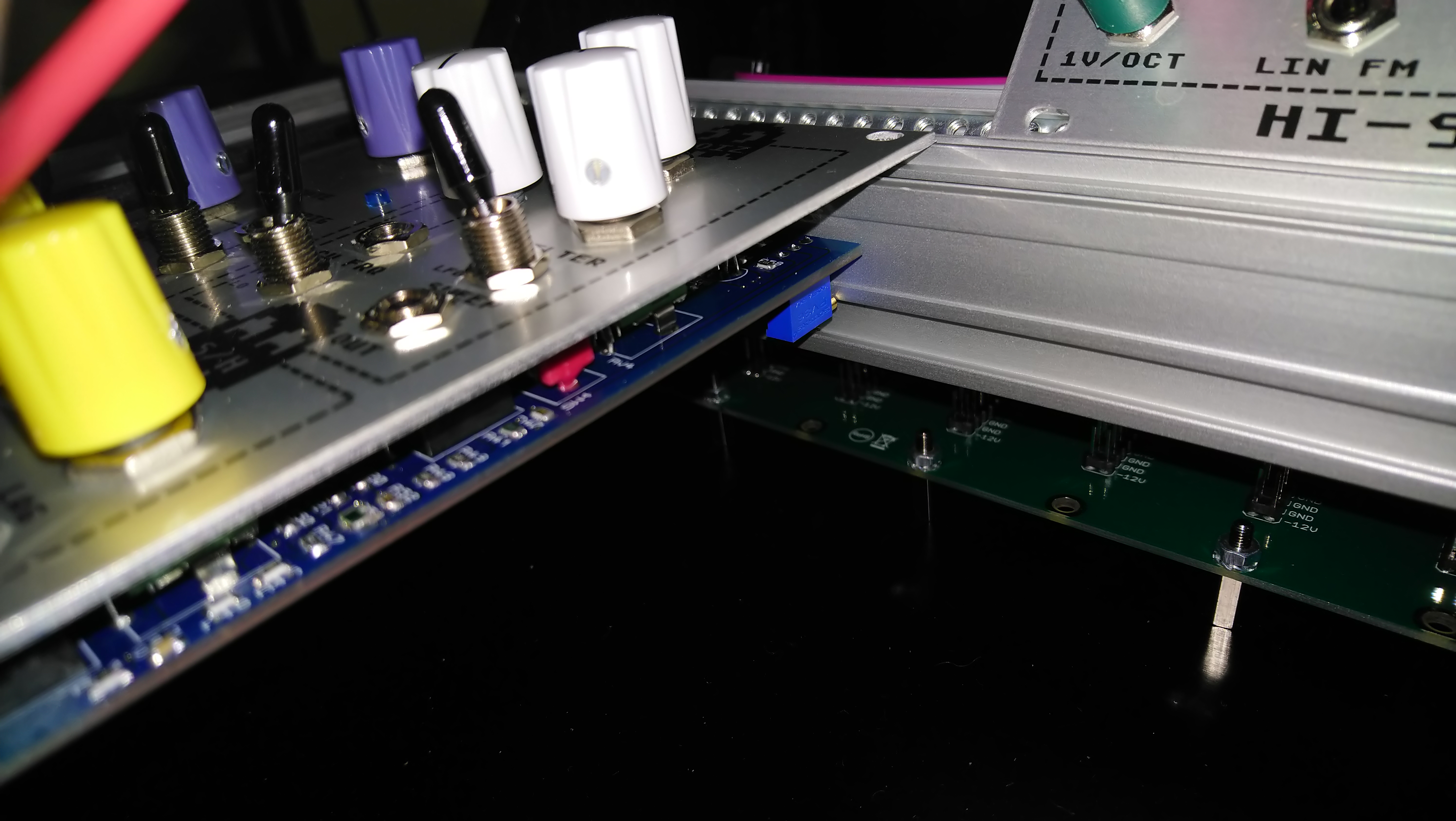

One question: those 2 trimmers on the back. Are you sure the screw portion will clear a rack rail? I suppose you could get the kind that have the screw facing up instead of on the side, in a pinch.
The module trimmer screws do clear the rails on my Doepfer and Synthrotek cases so I don't believe you will have any trouble there for any ther case also. Part of my testing is fit.

With reference to the trimmer screw clearance, Looking at these views and zooming in on the trimmers, you will see there is about a 1 to 1.5mm clearance. Close !!! Laughing
Like you said Dan, if there ever were a fit problem, just use a trimmer with a top adjustment screw.
Thanks for bringing it up to my attention. It made me think on it Cool
