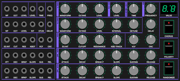

so, what do I want ?
The bare mimimum would be a small box with controls for each parameter which I can place on top of the synth and plug into its MIDI input.
The controls are made with potentiometers configured as a voltage divider connected to analog input pin(s) of the Arduino. The Arduino will
read the control values and send out the corresponding midi message.
Since I am already using voltages to control the parameters the next step would be to add external inputs for CVs from my modular synths.
I could actually make the whole controller into a synth module, but it might get a bit too large for that and I am also not sure if it would be very
practical to use. It would make it easier to patch though. I will try to keep it simple so no extra controls for external inputs, probably no buffers
either. The easiest thing would be to connect the external inputs directly to the control pots using sockets that will normalize it to 5V when nothing
is plugged in. So when an external CV is connected they will function as attenuators for it.
A CV input to control the actual pitch would be nice too. That means I could use the synth as a VCO (I am not much of a keyboard player anyway).
I can't just sweep the frequency (at least not to my knowledge) but I could convert the voltage into appropriate MIDI commands to simulate
pressing the keys. I could actually add a quantizer with different scales. I am not sure yet how to handle Note On/Off though. If I treat it like a
standard monophonic VCO I could just send Note On/Off messages when the pitch changes but an external gate input might make more sense.
However, it is a 6-note polyphonic synth so it would be a bit of a waste if I didn't make use of that. Maybe 6 CV/Gate inputs ?
Some kind of sequencer/arpeggiator ? It's pretty easy to make a midisequencer with an arduino but how to program/control it ? I could use the
parameter controls for this as well so in sequencer mode they adjust the notes and in control mode the parameters. However, there is a downside
to this method (at least when using pots and not rotary encoders). Whenever you use the sequencer mode you lose the visual representation of
the parameter settings. Code wise it would be possible to add some sort of catch-up so when you adjust a parameter it doesn't change untill you pass
the current setting. A better way would be to use the actual keys on the synth but that means reading MIDI aswell. It's possible but might get a bit
tricky to code (at least for me).
A small LCD display for parameter settings. I think this could be useful to display things like selected waveform and octave, Also useful for quantizer
or sequencer info. If I do add one I will probably come up with some more uses for it.
Storing patches, sequences and other things. The DW6000 can store 64 different patches/voices but I could store them in the arduino.
That just reminds me of another thing. It is possible to select voices stored in the synth through midi too, maybe add a contol for that as well.
Of course you will again lose the visual representation if you'd switch to a different voice.
I will probably get some more ideas along the way and any suggestions are welcome too of course Very Happy

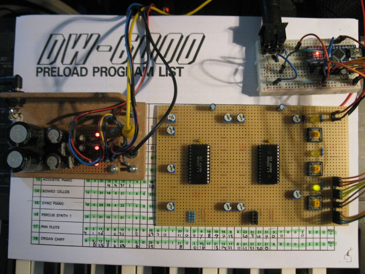

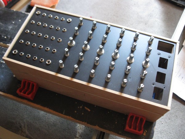

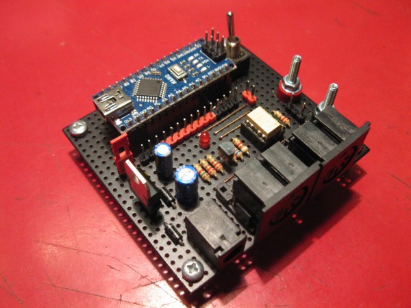

hardware:
The main core will be an Arduino Nano 3 (actually it's just a cheap chinese clone).
As mentioned I want to use potentiometers to control parameters but I am not sure yet if I want to do this for all parameters. There are
actually already 3 parameters for which I will use switches:
bend VCF on/off: determines if the joystick is used to change the VCF cutoff frequency. (I am not even sure if I will add a control for this)
VCF eg polarity: determines if the signal from the envelope generator for the VCF is inverted or not.
Chorus on/off: self-explanatory.
There are some more parameters that only have a limited amount of settings, like waveform, octave, VCF keyboard tracking, interval and
detune. There is no problem with using a pot for these and I can just design the front in such a way that it's easy to see what the setting is but
another possibility would be to use (rotary) switches with a resistor network. However, I wouldn't be able to use them as attenuators for CVs.
I am also not sure yet if I want to use all rotary pots or use sliders for some paramaters. Envelope generators make much more sense with
sliders and there might be some other parameters for which they are more suitable as well. Downside of sliders is that they are a PITA when
making a frontpanel (especially from MDF), finding the right knobs can be tricky and they are slightly more expensive and harder to obtain.

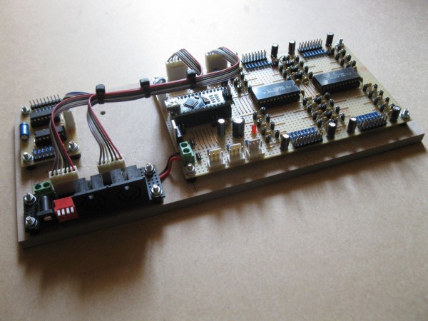

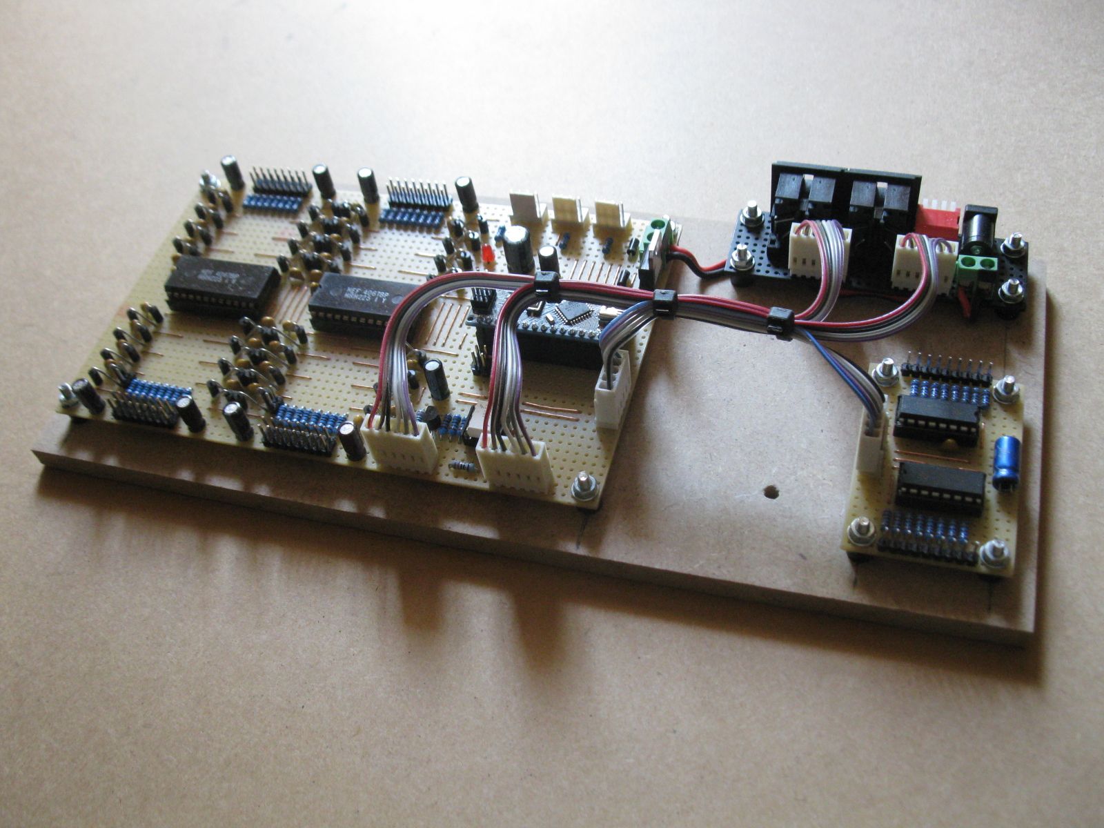

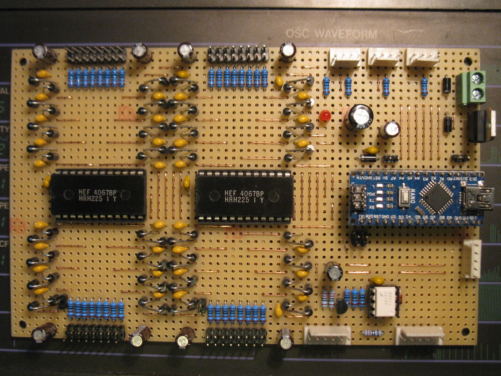

To be able to use so many analog controls I use multiplexers, it can only read 1 control at a time anyway. At the moment I've opted for 2x
4067 which is a 16 to 1 mux. That gives me a maximum of 32 analog inputs while using only 2 analog inputs on the arduino and 4 digital outputs.
I could use 4x 4051 (8 to 1 mux) which is a bit easier to obtain and because it has an inhibit pin I would only need 1 analog input on the arduino.
It would require 2 additional digital outputs though but only needs 3 control bits, so in total it requires 1 analog input and 5 digital ouputs.
I made a test board for it with trimpots which makes it easier to test the code I am writing. I only had 10 pots left though but more are ordered.
As you can see it also has 3 pushbuttons and LEDs. I could use toggle switches and leave out the LEDs which would make the code a bit simpler.
The advantage of pushbuttons is that you can set and change the state in code and they can be configured as momentary or latching. It's also
possible to combine buttons to do different things. (like pressing 1 & 2 at the same time will enter a different mode).
At the moment the switches (and LEDs) are all wired directly to digital input pins on the Arduino. However, I still have 1 unused analog input on
one of the muxes as I only need 31* analog controls. Earlier today I was thinking that I could just use the switches in combination with a resistor
network and connect it to the mux. That would save me 3 digital input pins on the arduino and it would be easy to add more buttons. For the
LEDs it might be possible to use the control lines for the muxes and one additonal output if I add some extra hardware.
If I add CV inputs I need some form of protection as the voltage levels can exceed 5V and also be negative. Grumble did some tests supplying
voltages to in- and outputs and posted the results here. According to those tests a 1K resistor in series might be sufficient. However the signals
first pass through a mux which also needs to be protected and I don't think simply using a resistor would be ok. Together with some diodes to clip
the voltage to the supply rails it could be fine though.
For the normalized sockets it would be easiest to connect them directly to +5V, but when you plug something in there is a moment where the tip
of the connector would be connected to +5V and thus whatever output is connected on the other side of the cable would be as well. In an ideal
world outputs are protected and this wouldn't cause any problems but better not to count on that. Adding a resistor in series should prevent any
problems but also causes a voltage drop in combination with the potentiometers. I could use a slightly higher voltage instead of +5V to compensate
for this or add buffers before the potentiometers. Another possibility is to make some adjustments in the code, I think it's even possible to adjust
the ADC voltage range itself.
I also need a powersupply. I'd like to make it so it all runs on +5V or maybe higher but at least a single supply. I could use a seperate supply for this
but maybe I can tap into the DW6000 PSU and add a connector for it on the back. It shouldn't be needing a lot of current anyway.
* there is 1 more parameter that I didn't implement which is the "Key Assign" setting. It already has 3 seperate buttons on the synth for this and
I don't think there would be much use in adding an external control for it.

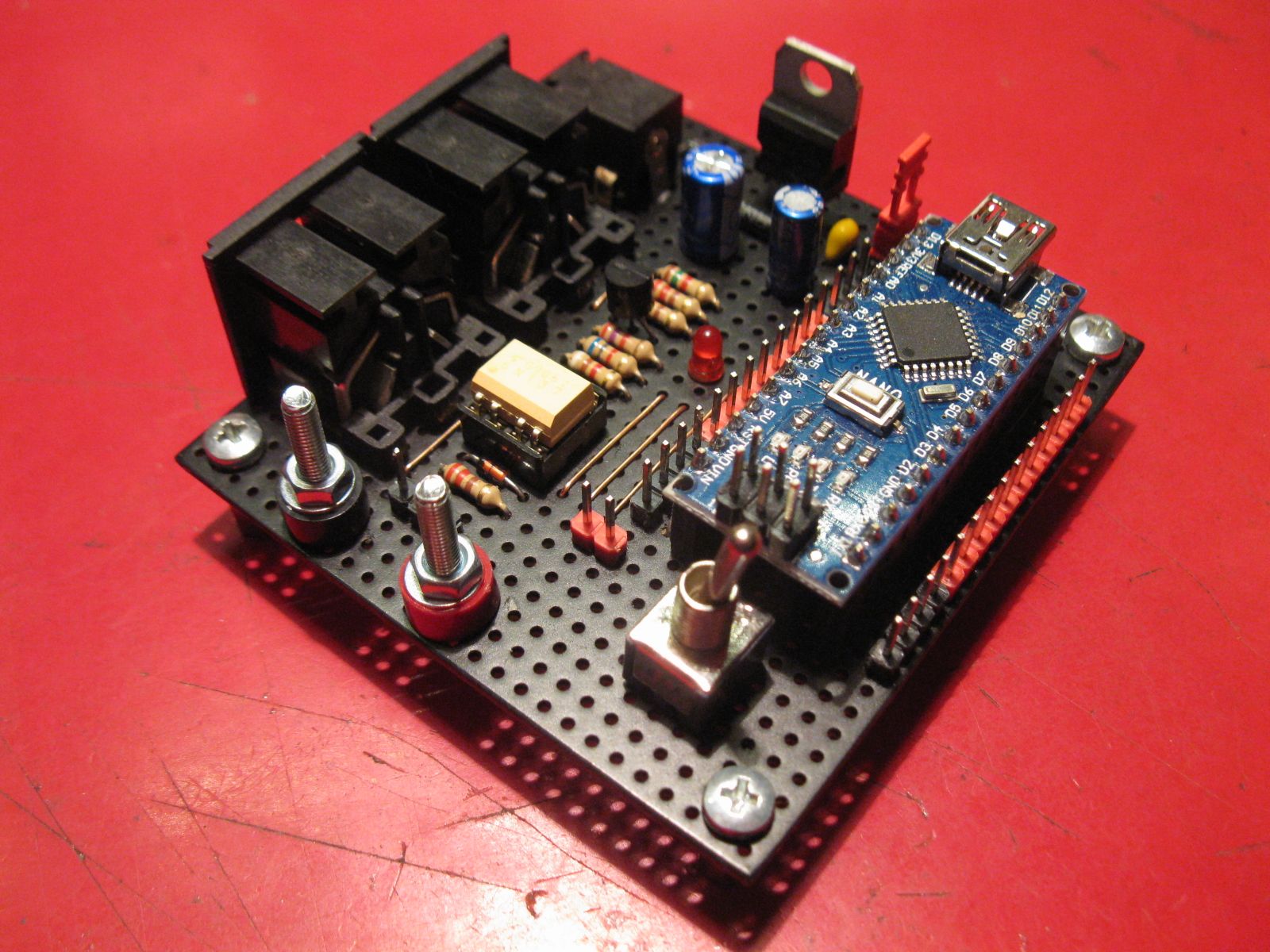

Before I could really do anything I first needed to add a midi output to the arduino. I followed along with this video, tested with
the example code and that worked fine. Next I had to figure out what messages I needed to send to change the parameters.
(note that when I mention the manual I am refering to the DW6000 owners manual which can be found here)
In the midi implementation section of the manual there are bytes and descriptions for all the MIDI messages but it doesn't really
say how to use them. It's probably something standard but that's where my knowledge of MIDI is lacking. I found some information
here that helped me get further:
First you have to declare a sysex array, for example
Code:
byte sysexArray[14] = {F0, 43, 10, 26, 02, 06, 01, 00, 1F, 01, 78, 00, 00, F7};
and then you send that array with:
Code:
MIDI.sendSysEx(14, sysexArray, true);
This made me realize that I'd probably have to send all the bytes mentioned in the manual for parameter change.
11110000 EXCLUSIVE
01000010 KORG ID 42H
00110000 FORMAT ID 30H
00000100 DW-6000 ID o4H
01000001 PARAMETER CHANGE 41H
0vvvvvvv PARAMETER OFFSET (See DW-6000 BIT MAP)
0vvvvvvv PARAMETER VALUE (See DW-6000 BIT MAP)
11110111 EOX
Initially this still didn't work untill I found out I had to change a setting on the DW6000 itself to enable it for sysex messages. After this
I could actually change the parameters. Razz I posted a test sketch here which repeatedly sweeps the filter cutoff frequency up/down.
here's a snippet of code that declares the sysex array:
Code:
// KORG DW6000 parameter change bytes
const byte exclusive    = 0xF0;
const byte korg_id      = 0x42;
const byte format_id    = 0x30;
const byte dw6000_id    = 0x04;
const byte param_change = 0x41;
const byte eox          = 0xF7;
byte param_offset       =  5;           // selected parameter (5 = filter cutoff frequency)
byte param_value        =  0;           // value for selected parameter
byte sysexArray[] = {exclusive, korg_id, format_id, dw6000_id, param_change, param_offset, param_value, eox};
As you can see I didn't put the values directly in the array as I think it's easier to understand this way.
(note I am now using #define instead of const byte)

PostPosted: Mon Jun 18, 2018 7:16 am    Post subject: Reply with quote  Mark this post and the followings unread
I made a test board for MIDI in & out + power. I haven't tested the input yet though. I also looked into the possibility of powering
the controller from the DW6000. The schematic is included in the service manual and the powersupply actually has 3x 5Volt
regulators. However I think it is better to just take the raw DC (11V) and built a seperate regulator in the controller. This way
I could also use an external DC supply if I'd want to.
I also changed the button setup to use an analog pin. Initially I used an R2R but the voltages I got out were not evenly spaced.
I calculated them and what I measures actually seemed to be correct which I found rather confusing. Untill I realized that an
R2R needs high and low signals, while the buttons can only provide a high signal. So I had to resort to a different setup.
 Filesize:  249.91 KB
 Viewed:  927 Time(s)
 Filesize:  270.48 KB
 Viewed:  928 Time(s)

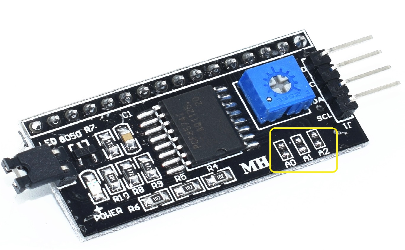

The better option, I think, would be to use one of those cheap 16x2 LCD displays with I2C interface sub-board. This way you need only 2 pins from Nano (SCL and SDA) plus supply line. They are on A4 and A5 so maybe you should consider rearranging your input/output pins. LCD display is much more versatile, you can use it also for system/MIDI debugging.
Personally I am using Arduino Mega Mini Pro Embedded (with USB) boards having a lot of pins but there is always too little input/output pins as multiplexing inputs in not an option for me (performance) when one board controls also many other things in real time.

hmm, was just checking on ebay for some prices and there are I2C converter boards available, those could be useful for the
displays I already have. It also answers another thing I was wondering about; do they have a range of address settings ?
I have some I2C DACs and I can only select between 2 diffrent addresses so without any additional hardware I could only use 2
of those. The converter boards seem to have a range of 0X20~0X27 so no problems when I want to use it in combination with
the DACs.
These modules usually have possibility to change I2C address. See attached photo of such module (A0 A1 A2 soldered jumpers).
 Filesize:  274.02 KB
 Viewed:  555 Time(s)

PostPosted: Mon Jul 16, 2018 7:06 am    Post subject: Reply with quote  Mark this post and the followings unread
I did a bit of soldering over the weekend.
 Filesize:  349.32 KB
 Viewed:  579 Time(s)

PostPosted: Sat Jul 21, 2018 2:25 pm    Post subject: Reply with quote  Mark this post and the followings unread
Here's the first draft of the front panel. I am not sure yet what kind of buttons I'll be using and I don't know the actual size of the display.
I will also need to figure out a way to mount it but I have something in mind for that. The knobs I ordered are black with a green indicator.
 Filesize:  303.11 KB
 Viewed:  568 Time(s)

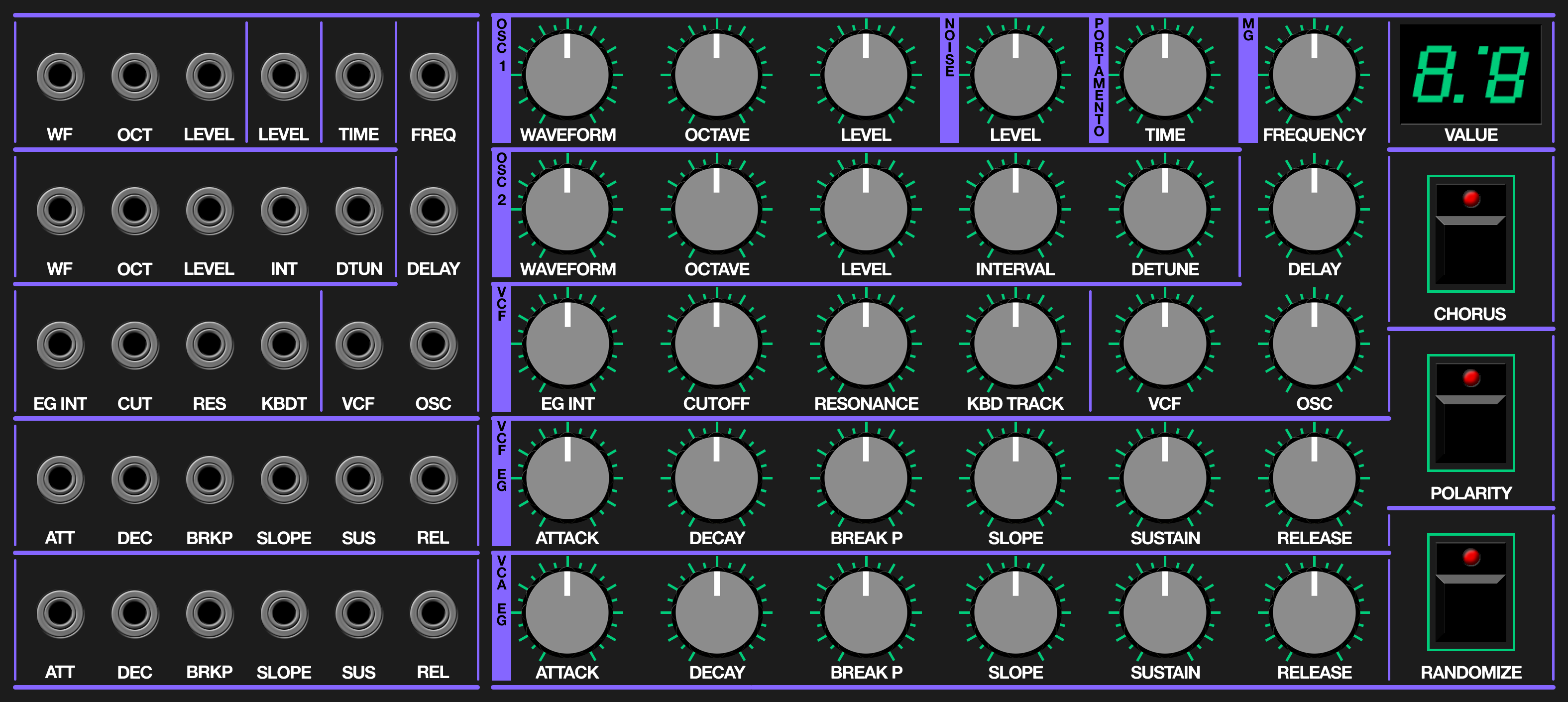

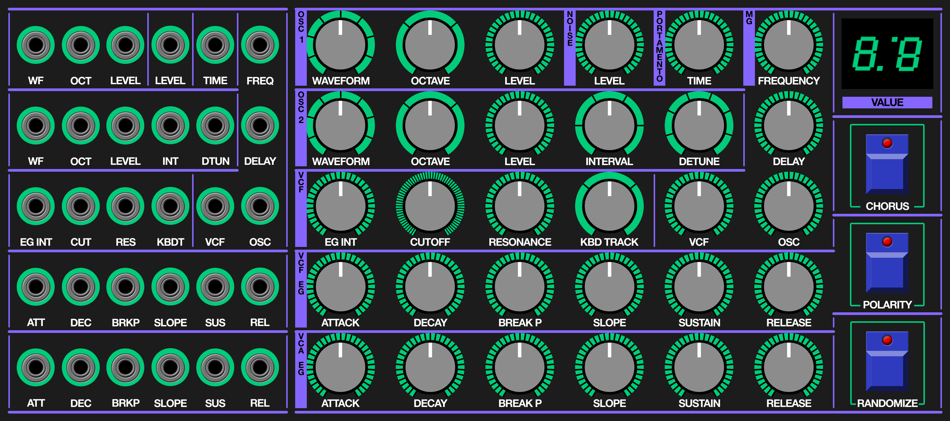

Posts: 5908
PostPosted: Mon Jul 23, 2018 6:53 pm    Post subject: Reply with quote  Mark this post and the followings unread
Second draft. I received the LED displays so I now know what size they are and I have some (blue) digitast switches I can use.
 Filesize:  420.13 KB
 Viewed:  583 Time(s)

PostPosted: Wed Aug 01, 2018 1:12 pm    Post subject: Reply with quote  Mark this post and the followings unread
I did some more soldering and started on the frontpanel,
the knobs arrived today and I got myself a crimping tool.
 Filesize:  267.72 KB
 Viewed:  591 Time(s)

Posts: 5908
PostPosted: Sun Aug 19, 2018 6:31 am    Post subject: Reply with quote  Mark this post and the followings unread
Cool
 Filesize:  231.53 KB
 Viewed:  497 Time(s)
 Filesize:  234.03 KB
 Viewed:  473 Time(s)
test fit
 Filesize:  252.76 KB
 Viewed:  509 Time(s)

PostPosted: Fri Aug 24, 2018 9:19 am    Post subject: Reply with quote  Mark this post and the followings unread

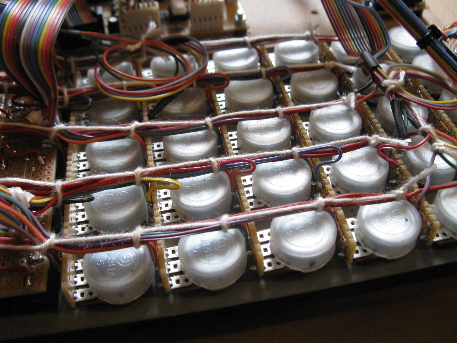

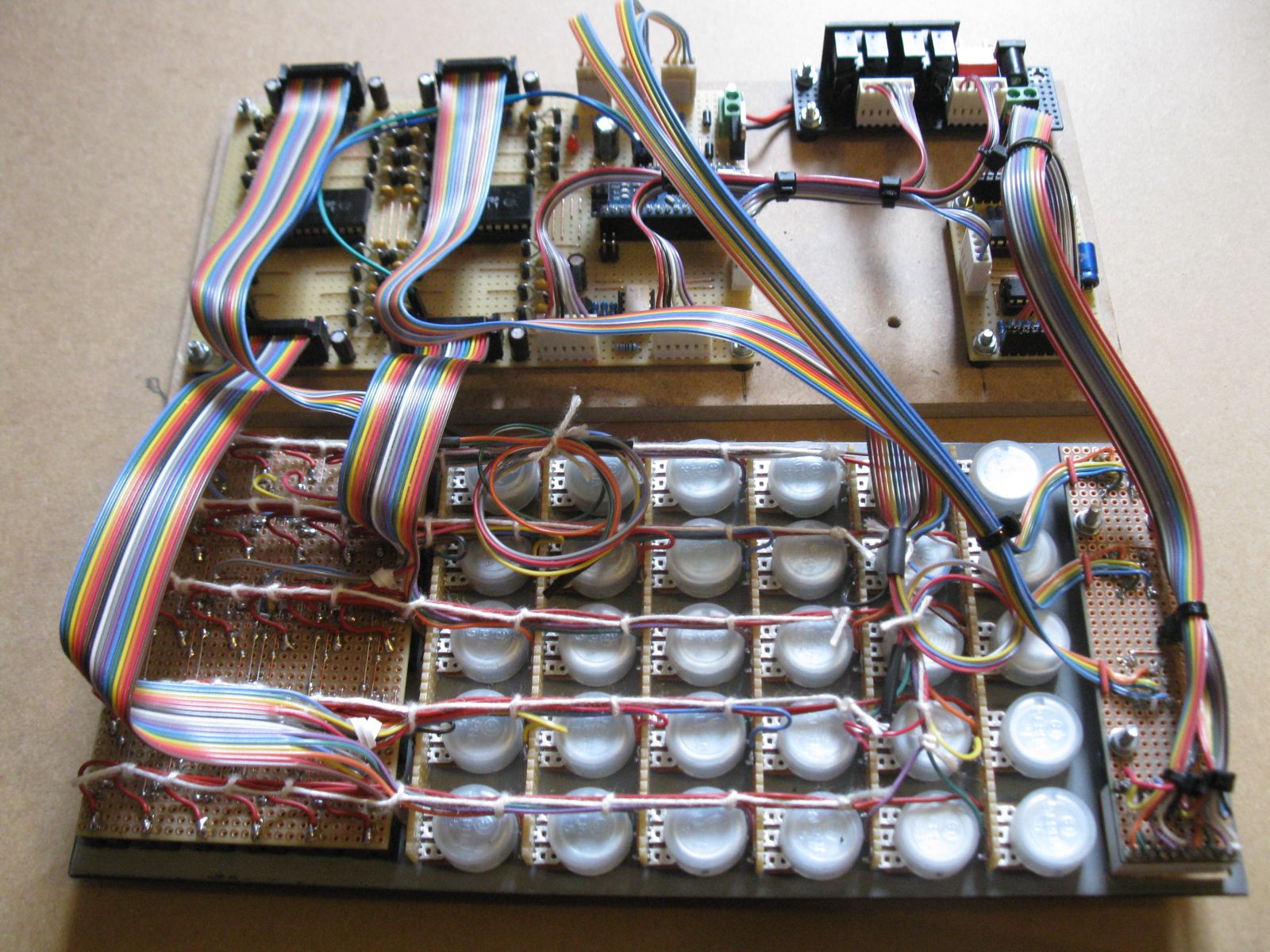

wiring..
 Filesize:  321.64 KB
 Viewed:  491 Time(s)
 Filesize:  273.14 KB
 Viewed:  490 Time(s)
