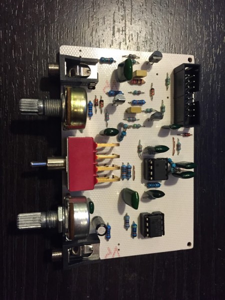

Verified working. Needs separate pink noise source. Should work for LowTom / HiTom values too. Designed for this chunky 4PDT toggle:
http://www.jameco.com/webapp/wcs/stores/servlet/ProductDisplay?search_type=jamecoall&catalogId=10001&freeText=2181204&langId=-1&productId=2181204&storeId=10001&ddkey=http:StoreCatalogDrillDownView
Eagle files:
https://github.com/jbeuckm/808-MidTom-MidConga/releases/tag/v0.1

Thanks for sharing these layouts ,i got these pcb's made for me ,was wondering if anyone can share a parts view of the board , just reinstalled my computer and it wouldn't install eagle , i have some print screen images of the boards with the parts but it's not easy to read .

I made the values more visible and added an image of the layout here: https://github.com/jbeuckm/808-MidTom-MidConga

Just a quick question, arhm, three, actually.
How / where should you connect the noise source and what does the big switch?
Are all of your 808 boards verified? ... you know, winter comes, will have a lot of free time Very Happy

i built this one and as i recall of checking the capacitors it's hi-tom ,i think .. you may check that before building .the switch is for tom/conga ,and the noise source is to be connected in the pink noise input (you'll need to make noise separate) ,had to turn the trimmer all the way down so the noise would make sense
