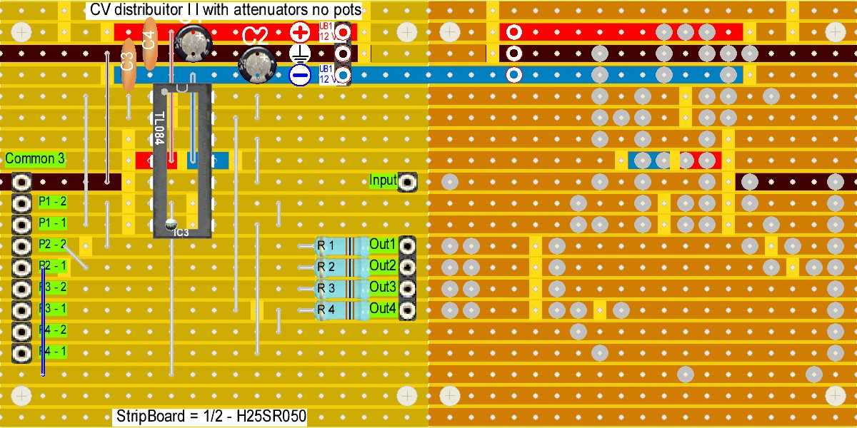

Here o version of CV distribuitor II with attenuators, no pots on board, using an 1/2 - H25SR050 stripboard

hi nardu,
verry nice work. can you please say witch part values you used on the cv distribuitor 2 ?
thanks for your nice stripboard layouts ....

Nardu wrote:
Stripboards
Great ! Thank you !!!!!!!
I will be able to compare when I have done my own stripboard if I did something wrong. This really helps.

citric acid wrote:
Nardu wrote:
Stripboards
hi nardu,
Nardu's stripboards are illustrating the CV Distributor version found here: http://www.musicfromouterspace.com/analogsynth_new/OLDIESBUTGOODIES/VOLTAGEMIXER/voltagedist2.html

I built the circuit at the beggining of the post and it works great, i also added a led driver that gives ferdback of the input signal.
I just realized i havent put the 1uf caps...
Thanks for this Smile

can a tl074 be used instead of 084?
PostPosted: Sun Dec 30, 2018 6:17 pm    Post subject: Re: g Reply with quote  Mark this post and the followings unread
Usually. In this case I'd say probably yes.

elmegil wrote:
thanks I figured since they have about the same specs. I actually used a 1-2 PASSIVE multiple to slit my midi-cv convertor in order to control 2 vcos and I figured there would be pitch problems but there wasn't so I tried it again later and still no pitch problems. I doubt a passive 3-1 for 3 vcos would work but maybe ill give it a try. but there 2 really stable vcos. ones a th vco-1 which is pretty pricise and stable and the other is a cem3340 design.
