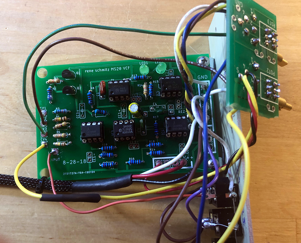

Hey there, I've now built 2 rene MS20 filters: https://www.schmitzbits.de/ms20.html
First one works fine, second one built w/ same parts and PCB has an issue.
when I really push the cutoff CV (crank up the cutoff frequency pot, +/- 15V or that combined with CV modulation) the audio output goes dead.
When I crank the CV inputs back down the VCF output comes to life again after about a second, I can hear audio at its output again.
I can't see anything wrong w/ either circuit; the only difference is that I used smaller green LEDs in the one with the "lockup" problem to get more nasty "MS20 peak distortion".
Beyond that when I look with a scope etc. they look about the same until one's audio output dies.
The resonance settings doesn't affect this issue--the small LED one will get silent and conk out even with resonance set to 0.
I read about zeners used to protect against "lockup", is that what I am seeing here? I mean this: http://www.syntiac.com/syntiac_obvcf.html. What does this mean?
I thought maybe I was killing the 3080s by over currenting them but I have also found when you do this they die really fast, and if that's what's happening here, if the 3080's are getting knocked silly, these 3080s are coming back to life.
Any assistance would be greatly appreciated, this issue is driving me crazy!
Posts: 1320
PostPosted: Mon Feb 04, 2019 1:14 am    Post subject: Reply with quote  Mark this post and the followings unread
Could you post a picture with the not functioning module? (both sides when possible)

Hi Grumble:
I have not added bypass caps yet. I usually do that once I am pretty sure the build was OK. I assume that's not the issue here, I use a stable power supply while testing (siglent 3303X)
As I said, I have another identical board that works without this issue (Same parts, bigger LEDs) which is the same layout, same PCB etc.
pot sub board removed to reveal this.

It looks like you have a cold solder joint somewhere, reflow all your solder joints, maybe that will cure your module,

PostPosted: Mon Feb 04, 2019 8:08 pm    Post subject: Reply with quote  Mark this post and the followings unread
[quote="cslammy"]
Grumble nailed it. Using a scope I could see that High Pass in wasn't working and I traced it to a Cold solder joint on the wire that connects the normal of the High Pass input jack ultimately to ground. See my diagram.
Interesting that a ground problem with this cap manifests this way, not what I would have expected.
