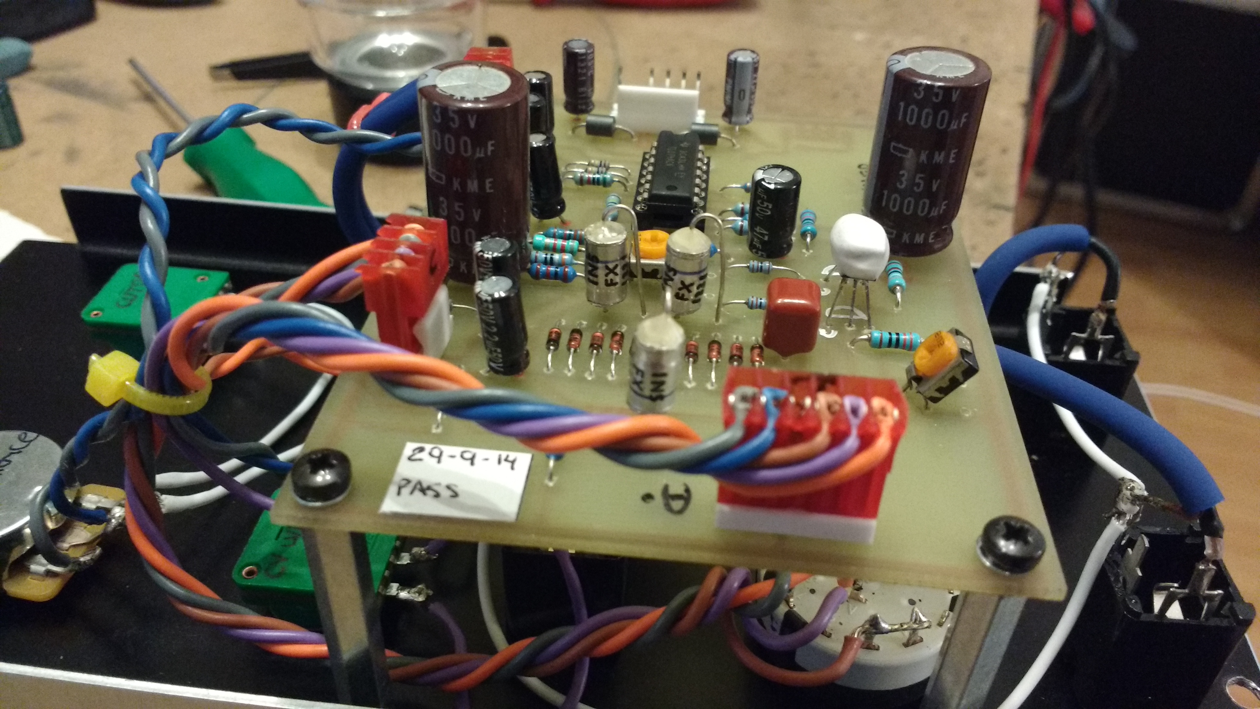

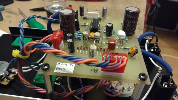

PostPosted: Wed Jan 27, 2016 9:55 am    Post subject: Faint hum in Steiner VCF and Minimoog VCF
Subject description: C7 and C7 replaced by 1000uf caps...
yusynth wrote:
You may double the value of C7 and C8 and use 100uF for C1 and C2, and add a small 100nF cap in parallel.
Using ferrite beads instead of R1 and R2 would also greatly improve the rejection of the HF noise of your switching PSU.
Using a switching PSU is OK in a modular if it is followed by low drop linear regulators which dampen the power fluctuations.
Hi Yves,
Off topic: Thanks a lot for sharing all of your modules, I've done several of them and they are just so cool.
I certainly replaced C7 and C8 for big 1000uf 35v and C1 and C2 are 22uf and I have ferrite beads, however a little improvent is what I've got after that. Any idea? I have similar problem with my Minimoog VCF.
I am not using a switching PSU, mine is a linear one with big 10000uf caps and a toroidal trafo, two LM338 and all the stuff to make it work.
VCA, VCO, LFO, Mixer, Sample & Hold, ADSR all of them work great no nosies or malfunctions.
I have no clues why I have that horrible hum in those two VCFs, I also did the MS-20 clone by Schmitzs and it works fine, no hum.
Thanks a lot in advance!
JRC.

PostPosted: Wed Mar 16, 2016 3:48 am    Post subject: Re: Faint hum in Steiner VCF and Minimoog VCF *** FIXED ***
JRC4558D wrote:
Hi Yves,
JRC.
The solution is very simple: A precision PSU. I used this one here (check out the link) http://www.analog-monster.de/un_psu_en.html.
Is based around LM723 regulator and 2N3055 power NPN transistor. symetrical 15v 3Amp.
Not only filters work better now (all of them), also VCOs work super.
I can't understand why anyone said that 3 LEG REGULATORS are useless for modular synths (unless you like buzz noises), no matter which one you use...
Anyway if you are reading this post now you know how to fix your buzzing rails.
Cheers.
