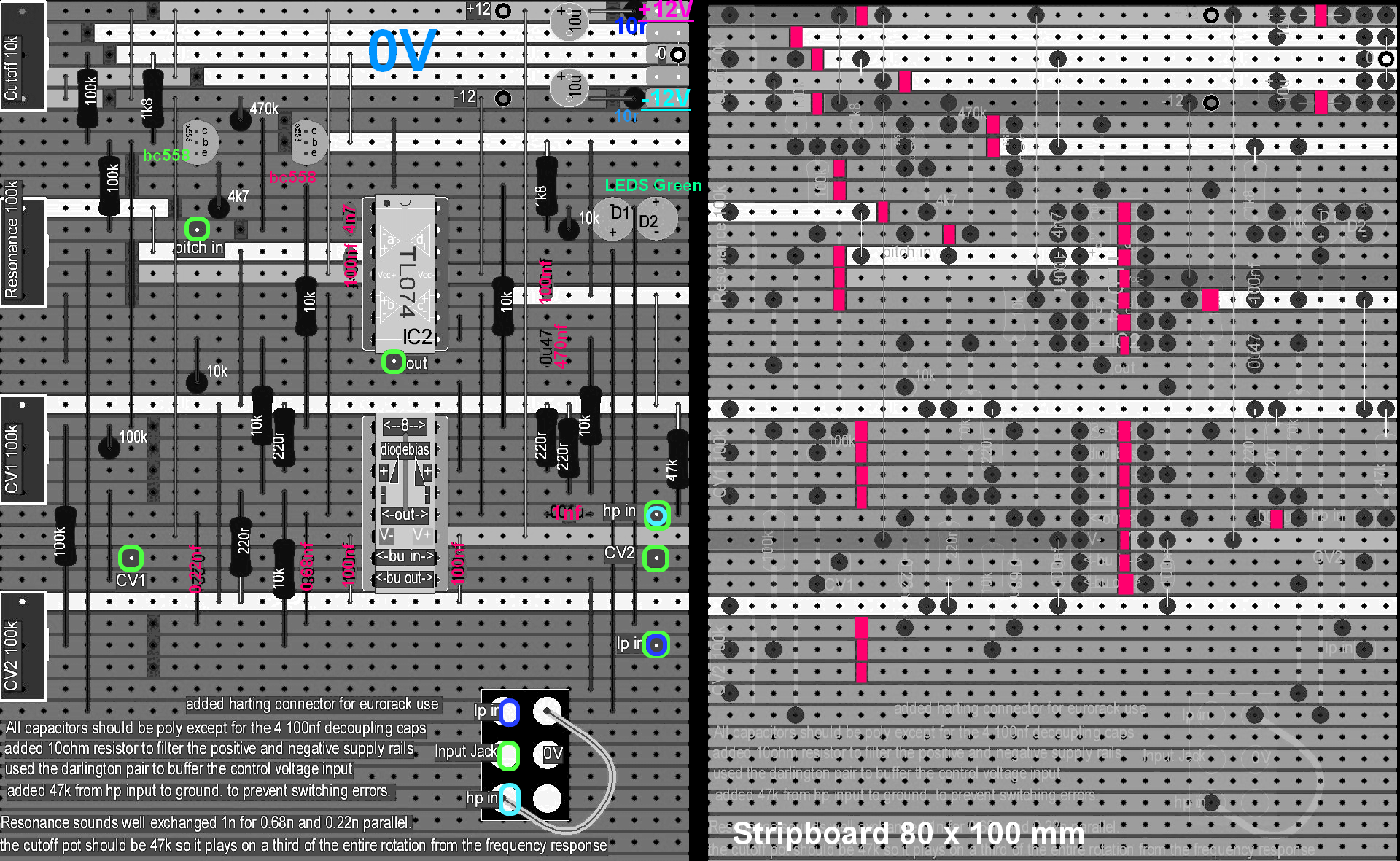

btw. the above posted stripboard layout can be improved.
First add some 10R resistors and decoupling caps on the power rails, also use decoupling caps for the LM13700 and place them as close to it's rails as possible. perhaps move that one resistor leg away from the bottom of the IC or move it more to the side and cut the trace behind it and then make this line a gnd line so you can place the caps really close, going from 6 and 11 to the trace below the IC.
Also i see there is a flaw in this layout, on the OP-amp pin 1and 2 (the Op amp in the resonance Feedback path) the diodes (original 6 diodes, 3 in each directing in series or instead 2 LEDs) and the feedback resistor (original schematic 10k) seem to be off, they should sit between 1 and 2 and not connected to -12V. Perhaps you should have a look at the original schematic too, and also there's somewhere in the net the Adaption of Scott Stites with the switched variant, were you can change between LPF/HPF mode.

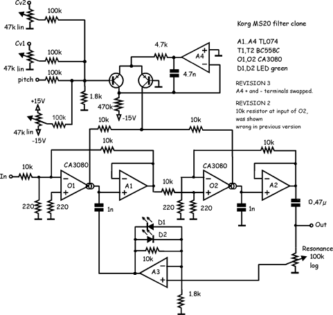

I found the later layout without that Switch. Also, I went digging and found the schematic, or I think I found it.

i'm not sure what you mean with the bottom resistor.
what i meant, was moving R18 (10k) the resistor for the Signal Input to the left on the board, then cut the trace right to it (on the leg at the bottom and not that one going to the LM13700), hook te inputwhich is here labelled as SW B1 to the hard left on that race and then you would have the rest of the trace "free" and could use it as a ground line to connect the decoupling caps to the IC, which are included in that design already even if in a bit more distance, but what i ignored in first instance or simply haven't seen first.
Maybe to give you a hint, what i meant can bee seen here:
http://electro-music.com/forum/phpbb-files/121vcf_676.png
That's the only layout i made, it took as nearly as Long as doing the stripboard so i decided to move along my usual way and just solder my way through the schematics.
Further thought on reducing the signal path for the Input is, if you Keep your signal lines that Long and especially direct between the rails, this could result in crosstalk of your signal to your power rails... so it's best to Keep them as short as possible.
Well the third leg of the resonance pot goes straight to gnd... not drawn there but can bee seen in the schematic you've posted.
What i said Looks false is what is in the schematic A3 which is in the layout the upper left OPamp of the LF347. You see the spacing is incorrect for the diodes, moved on trace up.

Looking at the schematic I was confuse at first, but Reso 1 goes to GROUND.
But I'm confused to where A3 goes on the switch wiring. Ground???

Looking at the switch Connections it Looks like in HP mode one cap is Floating free at the input… guess that's not the best idea…
Please feel free to correct me if this is wrong but i would wire the switch as follows…
A3 and B3 connected together… B2 goes to input
B1 goes to R18 (10K) (Low Pass input in LP mode)
A1 goes to gnd and connects C4 to gnd in LP mode)
A2 goes to C4 (high pass input in HP mode)
In HP mode Signal from B2 is connected to B3/A3 and A2 to cap C4
In HP mode singal goes from B2 to B1 into R18 while C4 is grounded…
and well as said before take care of the Layouts fault that i mentioned earlier the diodes and resistors on the left of the top IC are connected to -12V they have to be soldered a trace below between pin 1 and 2 of the Opamp

PostPosted: Tue Jan 15, 2019 4:51 pm    Post subject: Made it on stripboard today Reply with quote  Mark this post and the followings unread
I experimented a bit today. came out at the end so that I take the two darlington buffer to buffers cv 1 and 2. I also exchanged the 1nf for 0.68nf and 0.22nf in series and took the lf347 instead of the tl074. sounds very good and the resonance is not so fat anymore.

and here's a link to the original MS20 schematic:
http://machines.hyperreal.org/manufacturers/Korg/MS-synths/schematics/KLM-307.GIF
The original MS-20 HPF/LPF filter had a discrete core, using the Korg35 "IC".
This one using 2 x 13600 is a later version.
