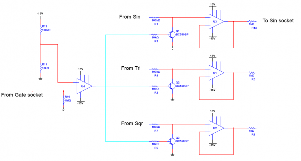

i try to explain it with words
- first, all the circumstances uve described matching perfectly together, exept that " IC1b pin 7 goes to -15v sometimes, and +15v sometimes" it should stay steady at -15v, but let us do ignore it for now as you have stated right u "may have seen one of those voltages when there was a gate signal".
- start with the osc-core, it produces a triangle that goes from 0V to -5V (as stated in the schemo) on pin 1 of IC1 and a square that goes from 15V to -15V pin 7 IC1
if in gate mode and no key is pressed Q1 is shortening the integration cap, the triangle out is at 0V then
- in order to to get a -/+5V triangle (and sinus) the signal from pin 1 of IC1, lets call it raw-tri, gets amplified by two (now it goes from 0V to -10V) and receives an offset of +5V (now it goes from -5V to 5V)
-->those are the 5V ur measuring when no key is pressed (core at 0V)
u would need to change the core if you like to change the behavior
or u could add extra little circuiterry, i can imagine at least 3 ways to silence to wave outs when no gate is present.
The most non-inversive way could be to shorten the outputs to ground.
with the attached idea u would not need to solder around on the board, and you could test it with comfort on a breadboard.
It it just an idea -no guarantee

Yesterday while brushing my teeth i have recognized that my little circuit idea will certainly NOT work as desired. Crying or Very sad
probably it will take the output to 0V while no gate is present.
BUT the moment gate goes high the TRI SIN output immediately goes back to +5V. Shocked
the further i think about, the more i think that the 0V thing doesn´t matter that much, but i would think about to get inverted outs.
lets say u have connected the LFO (tri or sin) to a VCO. If you hit the key, the LFO starts to decrease the frequenzy of the VCO. always.
I can imagine that it would be usefull to have the option that the frequenzy goes up when u hit the key?

I will still give some thought to a fix for this. I realized that a repair like gabbagabi's may work in gate mode, but will mess up the trigger mode. I like the circuit and will play with it a bit to learn more. Maybe Thomas Henry left the LFO Controller with the DC outputs because the fix is too complex.

no, it would leave the "normal" mode unattached Cool
