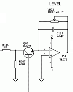

richardc64 wrote:
Yes, but I've seen the same basic idea used with other op amps. The scrap below, using a TLO72, is from the TR909 clone rim shot. I've also seen an LM324 used.
I like this type of VCA for percussion circuits as the distortion and control signal breakthrough tends to accentuate the attack portion of the sound, which is generally desirable in a percussion sound.

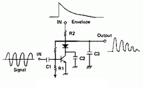

PostPosted: Wed Jul 01, 2020 4:59 pm    Post subject: "Roland's DR-110 percussion unit"
Subject description: Simple VCA
I breadboarded the 1-transistor, 1-diode VCA shown above.
At first the sound quality was only suitable for white noise.
But I was able to improve the circuit. Sorry I don't have a diagramming tool.
By adding a feedback resistor of about 220K across the collector and emitter, and moving bias resistor R1 from +V to ground, I was able to keep the sound clean enough for a lot of cheesy drum sounds.
This with a "decay-only" envelope generator provided by another NPN transistor will meet my requirements. I think.

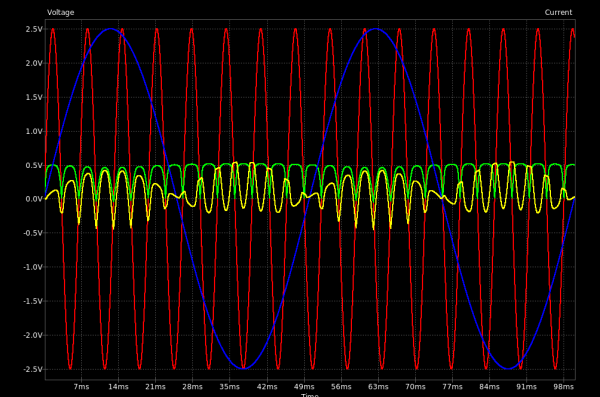

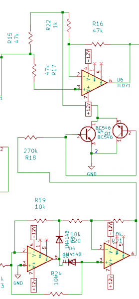

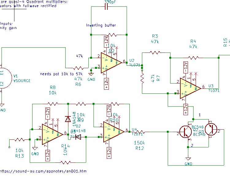

Since we are on the subject, here is an unusual kind of 2-transistor VCA I have been toying with, as a quasi 4Q multiplier. Expressly lo-fi: I wanted it for inside a waveshaper, so fiddling with the shape is a feature not a bug!
First up, the wide pic is a voltage controlled attenuverter, in the picture roughAttenuator.png.
In the trace: the audio signal is the blue; the control signal is the red: this is first fullwave rectified, to give the green: this green signal goes to base of the transistors, causing the output in yellow.
You can see that when the green is 0.25V, it makes the inputs to the op-amp cancel each other out, so you get 0V on the output. As the green goes above .25V you get the blue multiplied by the green, but as the green goes goes below .25V (to 0V) the output is inverted. (The asymmetry you can see is just the operation of the fullwave rectifier.) (You can perhaps see there are little horns at the polarity turn too.)
And there is a variant on this (in the picture roughAmplifier.png) which acts more like a VCA.
