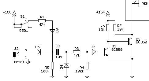

Posts: 1310
PostPosted: Mon Jan 09, 2017 3:43 pm    Post subject: Reply with quote  Mark this post and the followings unread
I just saw this part of the citcuit and I noticed that the switch S1 is connected wrong in this picture: the switch is drawn in rest position indicated by the small arrow in the pushbutton, but in this position (NC) the way it is connected the Reset pulse coming into connector J2 will have no effect since R1 is at +15V level.
So the resistor R1 should be connected to the other now unconnected pin of the switch S1 being the normally open (NO) connection of the switch.
I thought this might be helpfull for any diy-er who likes to build this module.
Other than this nothing but kudos for Fonik Very Happy
