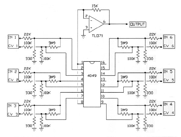

Hi Patrick.
Maybe try the hex VCA schemo below - it's an old EFM design, and looks interesting.... Haven't tried it myself.
EDIT - I guess +V is on pin 16, and GND on pin 8 , but I'm not sure how pin 1 works, as it seems to be connected to GND as well as the input to the TL071.
Hmmmm.. Anyone seen anything like this before?

PostPosted: Tue Oct 27, 2009 5:59 am    Post subject: Reply with quote  Mark this post and the followings unread
Grab the datasheet & take a look at the pin out of the 4049 to see how really wierd that cct. is,
4049 / 4050 don't follow standard CMOS VCC / VSS Wink

PostPosted: Tue Oct 27, 2009 7:25 am    Post subject: Reply with quote  Mark this post and the followings unread
WOAH!
pin 1 is VCC and pin 8 is GND?
Blimey - that is seriously weird......

PostPosted: Tue Oct 27, 2009 9:14 am    Post subject: Reply with quote  Mark this post and the followings unread
hm.. so judging from the schematic it'd give me about 6 vca's in one little circuit? would it be possible to substitute the opamp with one of the internal inverters as a buffer so that I (hopefully) get a single chip vca, vco/lfo/AR, vcf design out of it? I'm thinking of using two inverters to be switchable between astable and monostable mode so that either of them can be used as a vco, lfo or attack/release generator, one inverter for vca, one as a simple vcf, leaving the remaining two as buffers for vca/vcf. Just an idea for a one chip synth/module I'm hoping to put together.

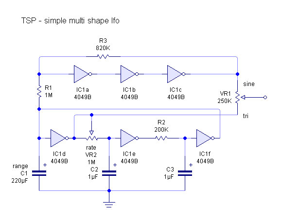

PostPosted: Wed Oct 28, 2009 2:17 am    Post subject: Reply with quote  Mark this post and the followings unread
I found this one on the the squarewave parade site... i havent tested it... i probably should considering i have a huge load of 4049s sitting around.
MULTI-SHAPE LFO:
 Filesize:  31.51 KB
 Viewed:  48264 Time(s)

I've been looking into that EFM hex VCA circuit.
The 4049 is a hex inverter IC. Manufacturers build their inverter circuits differently and this schematic may very well be dependent on an inverter design from a certain manufacturer.
It may not even work with a 4069.
The problem is, the IC manufacturer is not specified in the schematic. Most tinkerers will be confused if they breadboard this circuit and it does not work.
Some of the clever circuit designers have been known to design a circuit around the substrate makeup of ICs. The old minimoog has one such circuit - the 741 - that will not work with modern opamps.

I don't care who has had what success with the things: I will never ever trust digital CMOS used linearly, except in the simplest of applications, e.g. no-frills amplifiers, as used in the Osamu Envelope Follower and Noise Generator circuits. (Do you hear me, all youse over there in the Lunetta forum?)
Negative. Look at how the 4049 is wired. Vcc and Vss are connected together, creating an output "buss" of all the mosfets' drains and sources. Individual inverters are not available separately for any other use.
btw, I've looked at 4049 data sheets from National and Fairchild and the innards appear identical. The 4069 is slightly different, so, indeed, it may not work in the hex VCA circuit.
