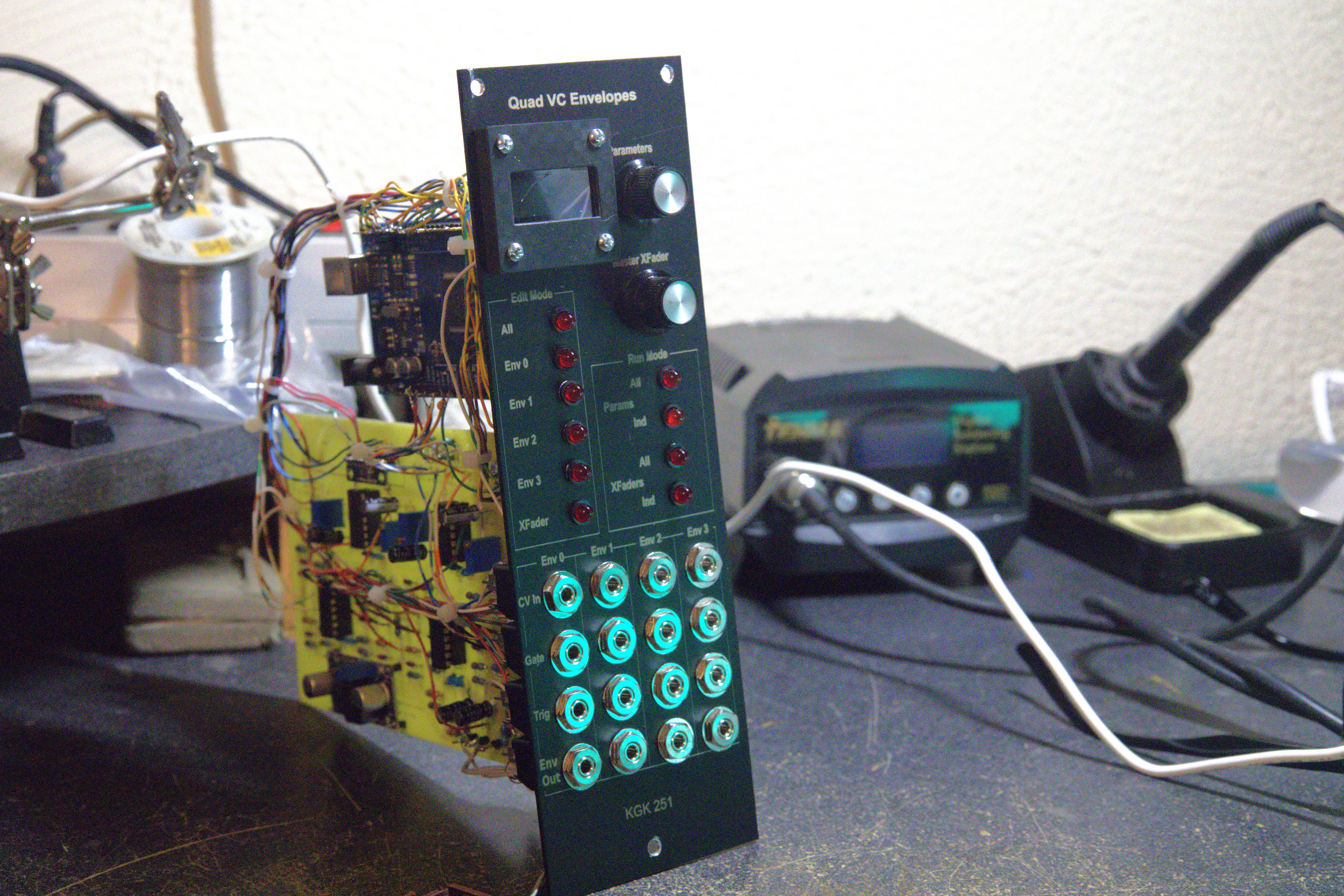

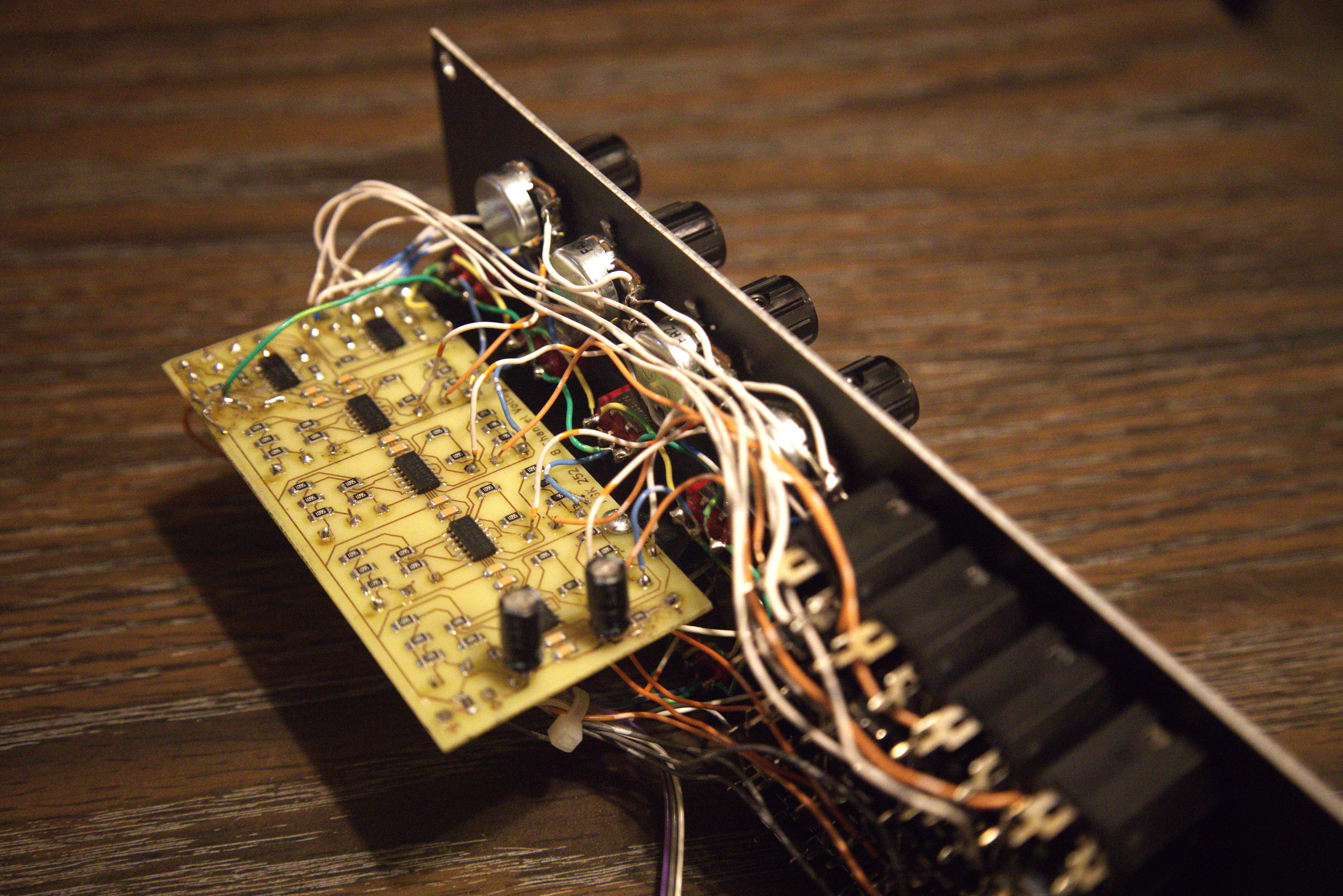

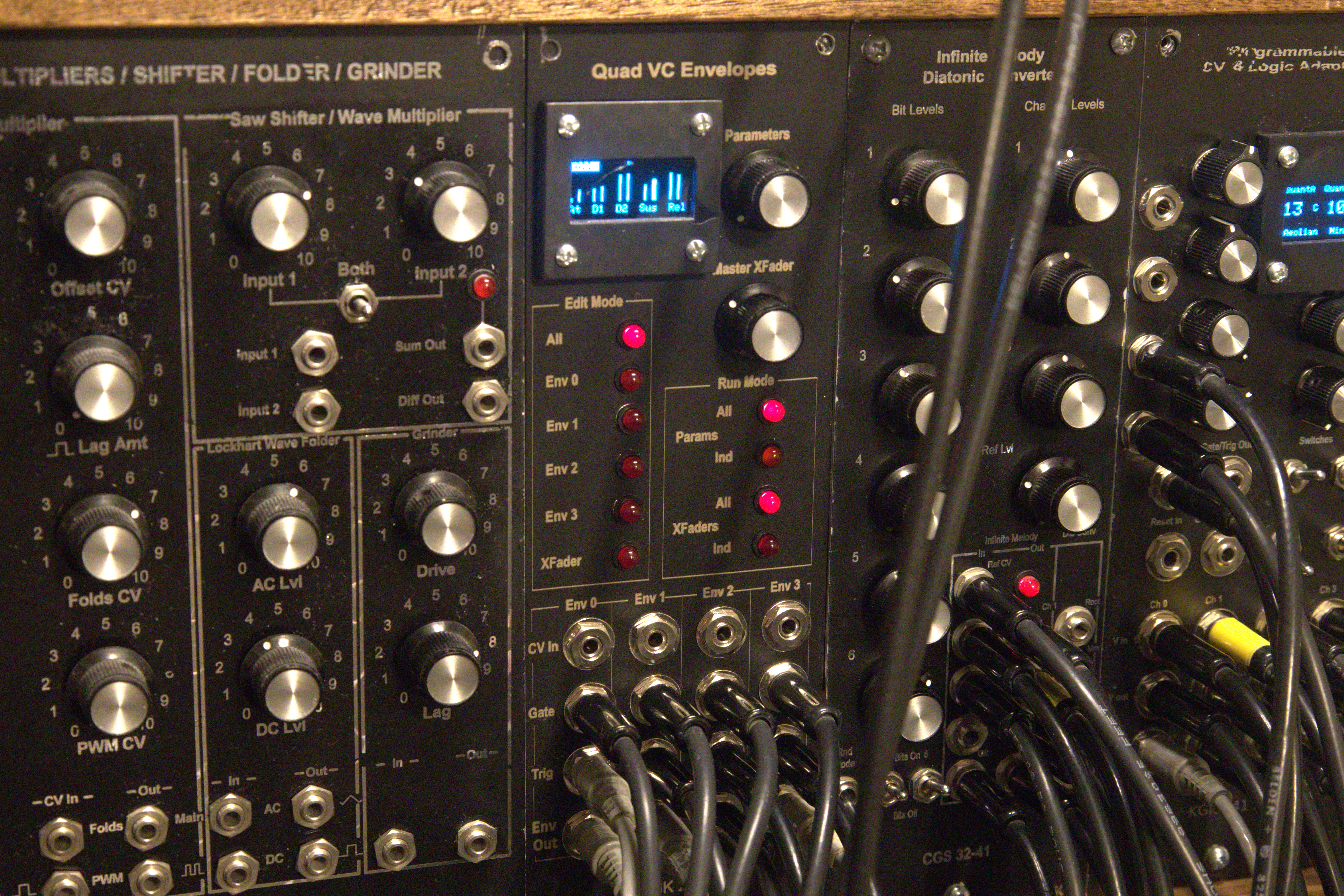

My latest build continues my work integrating Arduino-based control modules into my modular synthesizer while keeping the signal path fully analog. Behind the panel is an Arduino Mega with custom interfacing to bridge the 5V logic of the microcontroller with the 10V world of analog synths.
Introducing the KGK251: Quad Voltage-Controlled Envelope Generator
The KGK251 is my first build of 2025 (hence the numbering). It features four independent envelope generators (EGs) that can operate separately or as a group. My goal was a minimalist, intuitive interface, so the module has just:
One encoder for parameter selection and adjustment
One crossfader pot for seamless transitions
Each EG has four front-panel jacks:
Gate In
Trigger In
Crossfader CV In
Envelope Out
Envelope Design: Five Stages with a Unique Dual-Decay Approach
Each envelope features Attack, Decay 1, Decay 2, Sustain, and Release. The two-stage decay system prevents the typical “static” sustain level by allowing the envelope to evolve naturally over time. This keeps the envelope shapes organic and dynamic without requiring excessive complexity.
A/B Parameter Sets & Crossfading
Each EG has two parameter sets (A & B) that can be blended using the crossfader, allowing smooth morphing between two different envelope shapes.
Global Control: The module includes an ALL mode where parameters and crossfader positions apply to all EGs at once.
Per-Envelope Control: Each EG has its own crossfader position plus a dedicated CV input. The total crossfader value is the sum of the Master Crossfader, individual EG Crossfader, and external CV.
Wrapping Behavior: When summed values exceed the range, they wrap around instead of just staying stuck to the B parameter settings.
Additional crossfader modes are in development and will be added later.
Flexible Run Modes: Individual vs. Global Control
ALL Mode: A single pair of A/B parameters can drive all EGs, with individual offsets.
Individual Mode: Each EG can be set independently, with the option to disable the Master Crossfader’s influence for precise shaping.
Coming Soon: Video Demonstration
I’ll be posting a video soon to showcase these features in action. In the meantime, I’ll be sharing photos of the module and an MP3 demo of the patch.

New KGK251 Module on the workbench
 Filesize:  12.38 MB
 Viewed:  146 Time(s)
KGK251 Module installed and working!
 Filesize:  10.52 MB
 Viewed:  135 Time(s)

PostPosted: Sun Feb 16, 2025 1:43 am    Post subject: Reply with quote  Mark this post and the followings unread
Another impressive design of yours thumright
I appreciate controlling analog modules with microcontrollers. This offers to combine the best of both worlds, analog and digital / programmed.

Thank you for the compliment. This has been a learning experience, for sure! Smile
Posts: 5884
PostPosted: Fri Feb 21, 2025 11:27 am    Post subject: Reply with quote  Mark this post and the followings unread
That looks great Kevin!
I like the kind of juxtaposition of the very classic 5mm red LEDs and the OLED display.
I'll have a listen to the patch at a later point, but I am sure it'll sound great.
Are those connectors the less common jack size that I think were used for telephone exchanges ?
They look too small for 1/4 and too large for 1/8.

Posts: 1471
PostPosted: Fri Feb 28, 2025 6:29 pm    Post subject: Reply with quote  Mark this post and the followings unread
Hi PHOBoS. Thank you for your comments! The jacks are amphenol, 1/8" size. They cost about half as much as the Switchcraft jacks and I think I may "bite the bullet" and order Switchcrafts on the next order. The Amphenol jacks don't seem to work as smoothly as the Switchcrafts.

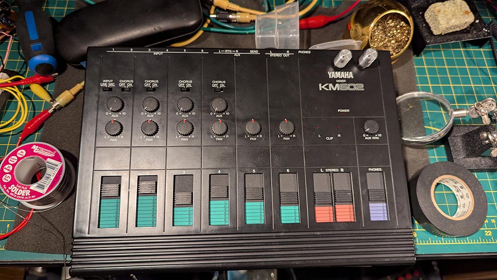

PostPosted: Mon Mar 03, 2025 2:18 pm    Post subject: Reply with quote  Mark this post and the followings unread
I have been working on repairing stuff and setting things up in my new studio space (I got rid of about 80% of my gear). Here is what I did last week.
This old mixer needed all the switches taken apart and cleaned. While I was in there doing that, I added depth and rate controls for the builtin BBD chorus.
I will be using this as a sub-mixer for a stack of Yamaha sound modules (3x EMT-10, and 1x EMT-1). I mostly use them for strings and choir sounds, so the chorus will be nice to have.
 Filesize:  139.47 KB
 Viewed:  120 Time(s)

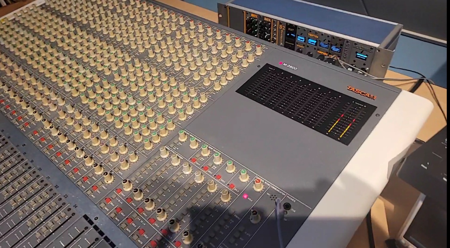

Posts: 1320
PostPosted: Tue Mar 04, 2025 12:08 am    Post subject: Reply with quote  Mark this post and the followings unread
Not realy a build picture, but a repair picture this time.
This 24 channel mixing table was donated to me since it was defective.
But after a morning working on it I found 2 false soldering points and after re-soldering the mixer worked perfect again.
Now I have to learn working with this beast of a mixer…
 Filesize:  418.05 KB
 Viewed:  145 Time(s)

PostPosted: Wed Mar 05, 2025 1:45 pm    Post subject: Reply with quote  Mark this post and the followings unread
Nice repair/mod job Jake Smile
wow , that's a large one, nice repair Smile does it have fx send/returns , usefull if you have a couple of old 19" rack multi fx units to hook up Smile , wall mounting the mixer is an option if studio space is a bit tight Smile
Posts: 1320
PostPosted: Thu Mar 06, 2025 11:25 am    Post subject: Reply with quote  Mark this post and the followings unread
Yes, it does have send returns for extern fx, some from the eurorack, or a fx case I have.
My studio doesn’t need much space, the small euro case you can see on the picture already has 12 outputs….
I also have built half an euro case with 3 MiniDexed DX7, so effectively with 24 DX7’s.

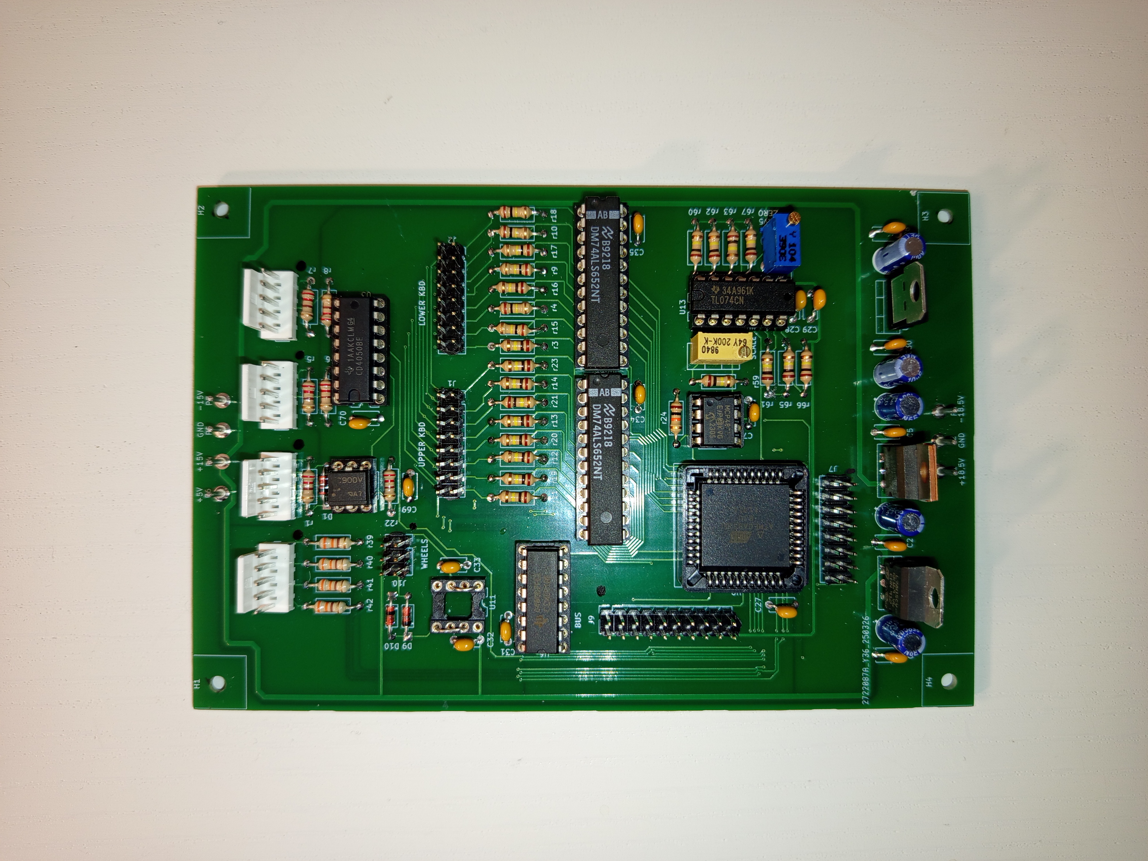

I modified two Roland EM-101 synth modules. It is a paraphonic synth with an IR3109 filter chip (SH-101, Jupiter-8, Juno- 6/60, JX-3P). It has a digital oscillator that stacks divisions of a square wave to create waveforms. It is often referred to as a "poor man's Juno". It is easily modified to add cutoff and resonance controls. The case is extremely cramped, so I added the mods to a little side panel. Here is a demo of them:

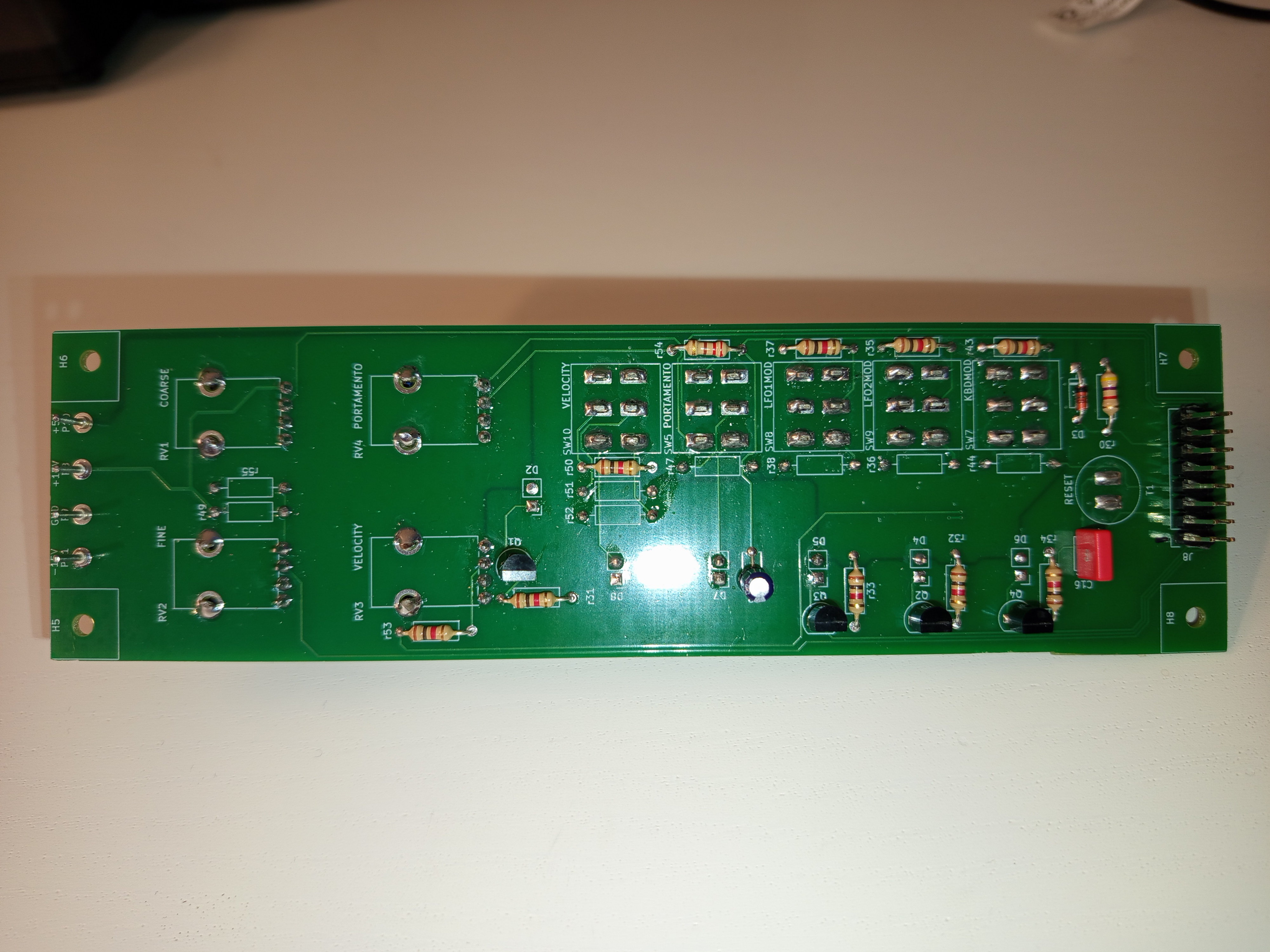

PostPosted: Sat Apr 26, 2025 7:57 am    Post subject: TyCoon Synthesizer
Subject description: A Synton Syrinx inspired system

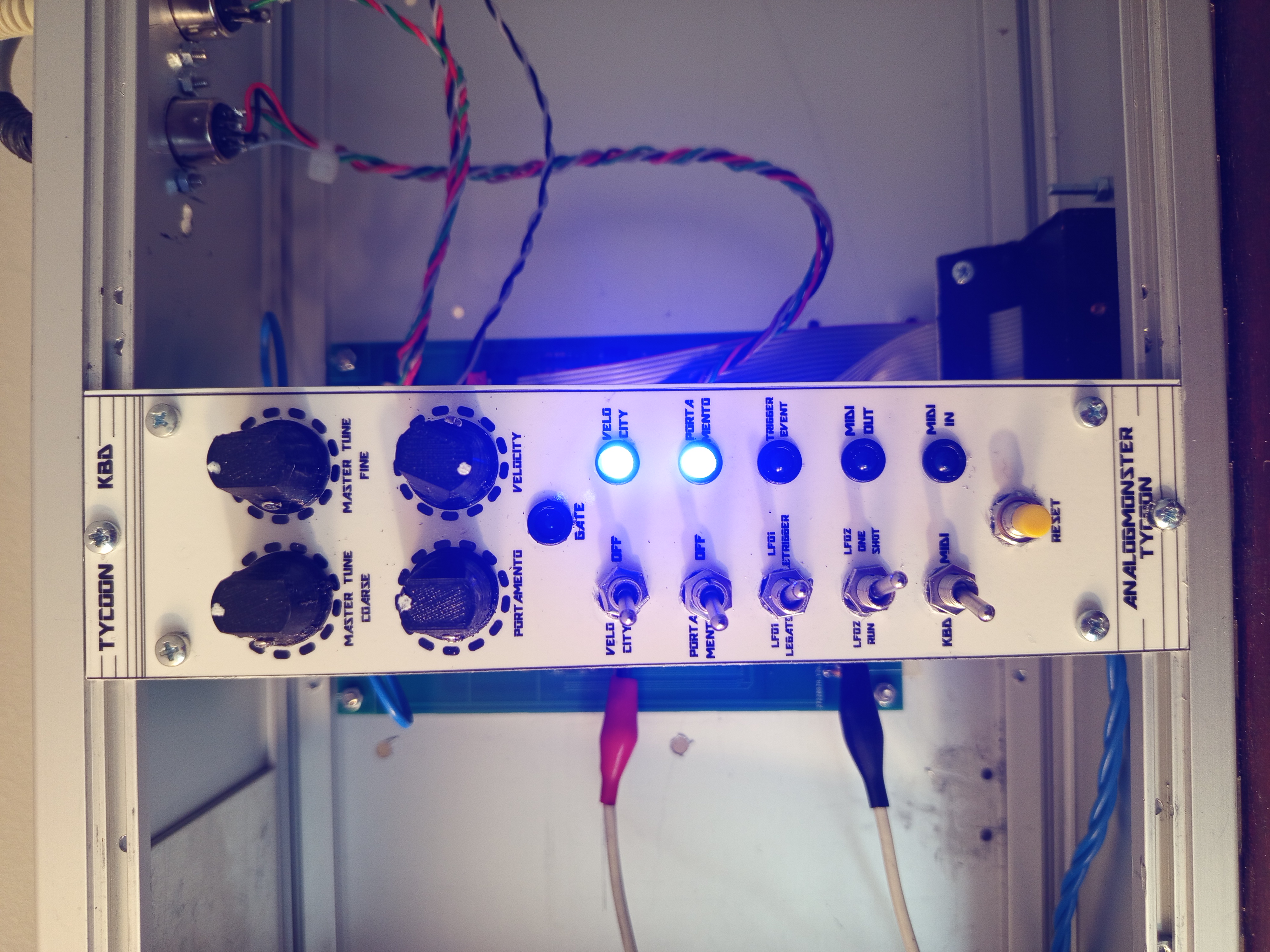

After finishing my Oberheim SEM cloning activities I've just started my new keyboard synthesizer project, the TyCoon synthesizer.
It is a system which is mainly inspired by the famous Synton Syrinx, but beside the Syrinx functions the TyCoon will provide some extra features and additional functions, like MIDI handling, stereo output panner, sequencer and others.
So the first steps are done, the keyboard interface is (nearly) finished and integrated, and first integration tests are made.
List of the TyCoon keyboard interface functions compared to the Syrinx:
1.) Syrinx: Resistor string <=> TyCoon: FATAR interface
2.) Syrinx: Master tune COARSE and FINE <=> TyCoon: as well
3.) Syrinx: Internal monophonic CV and GATE creation <=> TyCoon: as well
4.) Syrinx: Portamento <=> TyCoon: as well
5.) Syrinx: External CV out GATE out <=> TyCoon: no equivalent
6.) TyCoon: Keyboard velocity analysis <=> Syrinx: no equivalent
7.) TyCoon: Portamento switch <=> Syrinx: no equivalent
8.) TyCoon: MIDI OUT <=> Syrinx: no equivalent
9.) TyCoon: MIDI IN/THRU <=> Syrinx: no equivalent
Current build state

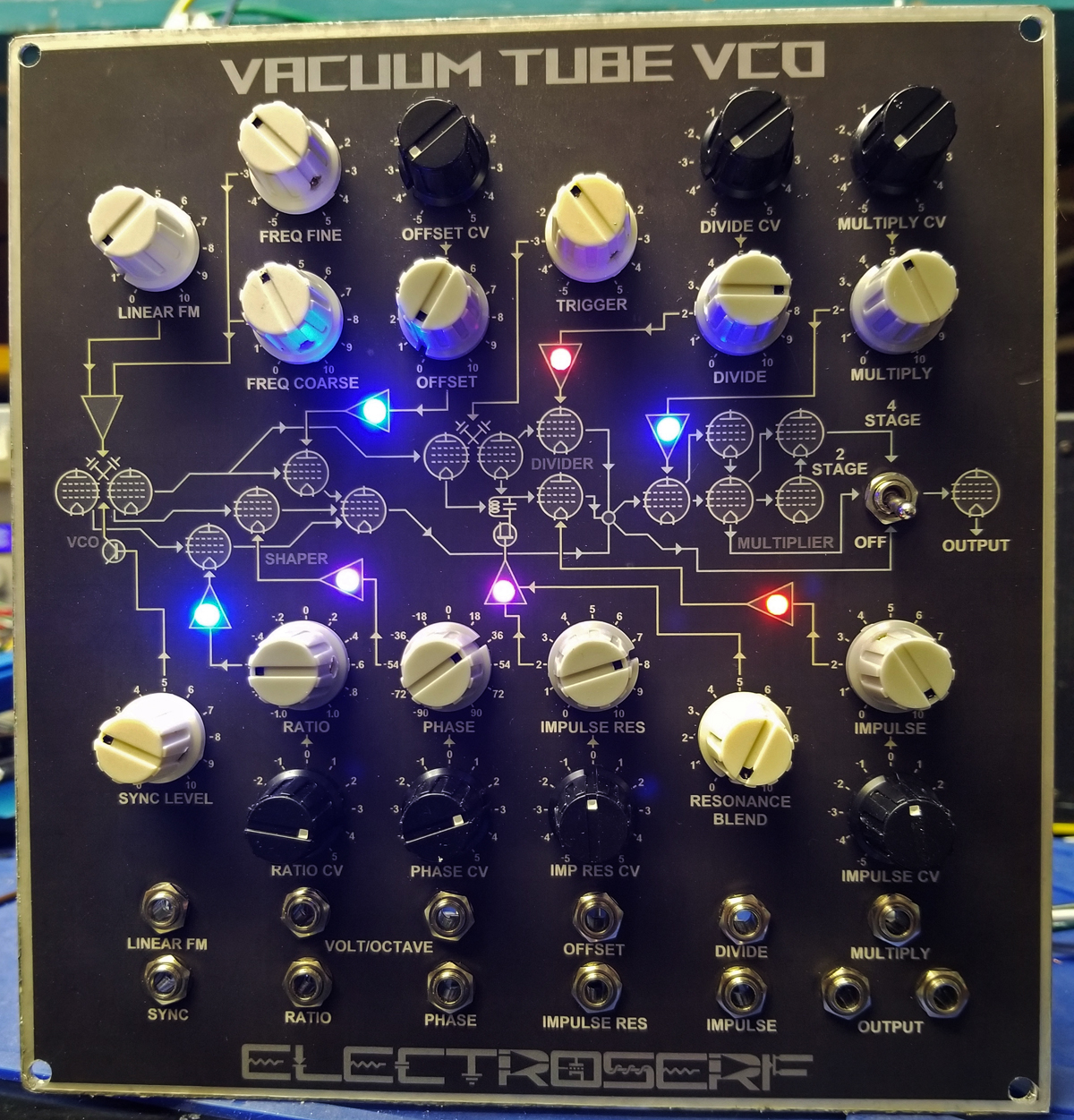

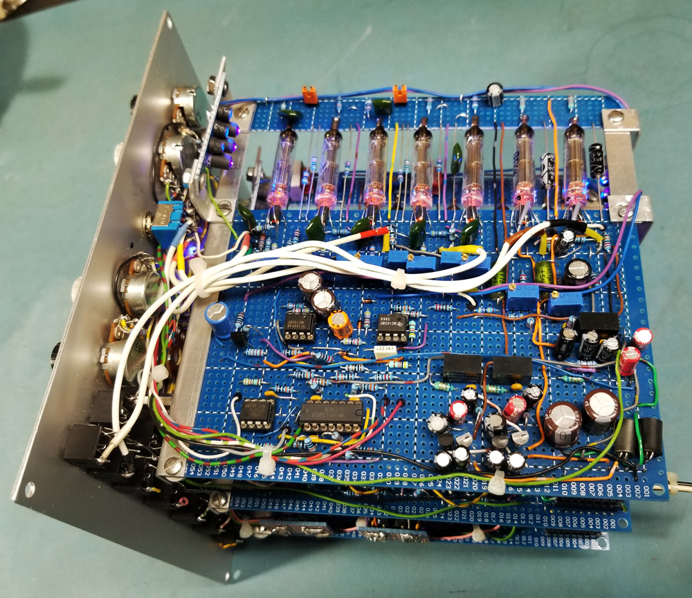

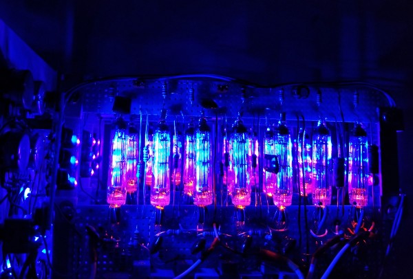

Lately I've been designing and building a series of modules based on Soviet rod tubes with the goal of creating a complete monosynth with an all-tube audio path.
Here is the first module, a complex VCO that includes waveshaping, sub octave, wavefolding, and more. A total of nineteen tubes are used here, including 1J18b, 1J24b, 1J29b, and 1J37b.
More to come...
Take care,
Doug
 Filesize:  1.03 MB
 Viewed:  154 Time(s)
 Filesize:  926.9 KB
 Viewed:  144 Time(s)
 Filesize:  774.69 KB
 Viewed:  128 Time(s)
The Electronic Peasant
www.electronicpeasant.com

I think the inside is better looking as the outside 😁👍🏻
Nice job!

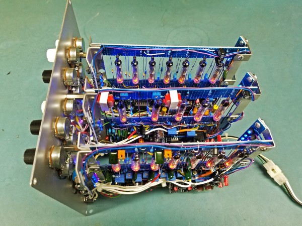

Cynosure, I am planning on making a video of the VCO module in action with sound examples when I get the VCA module completed. I am working on building that module now along with a noise generator.
Thanks for the nice comments, Grumble! I have attached a few more inside pics for you. Lots of stripboard work!
Take care,
Doug

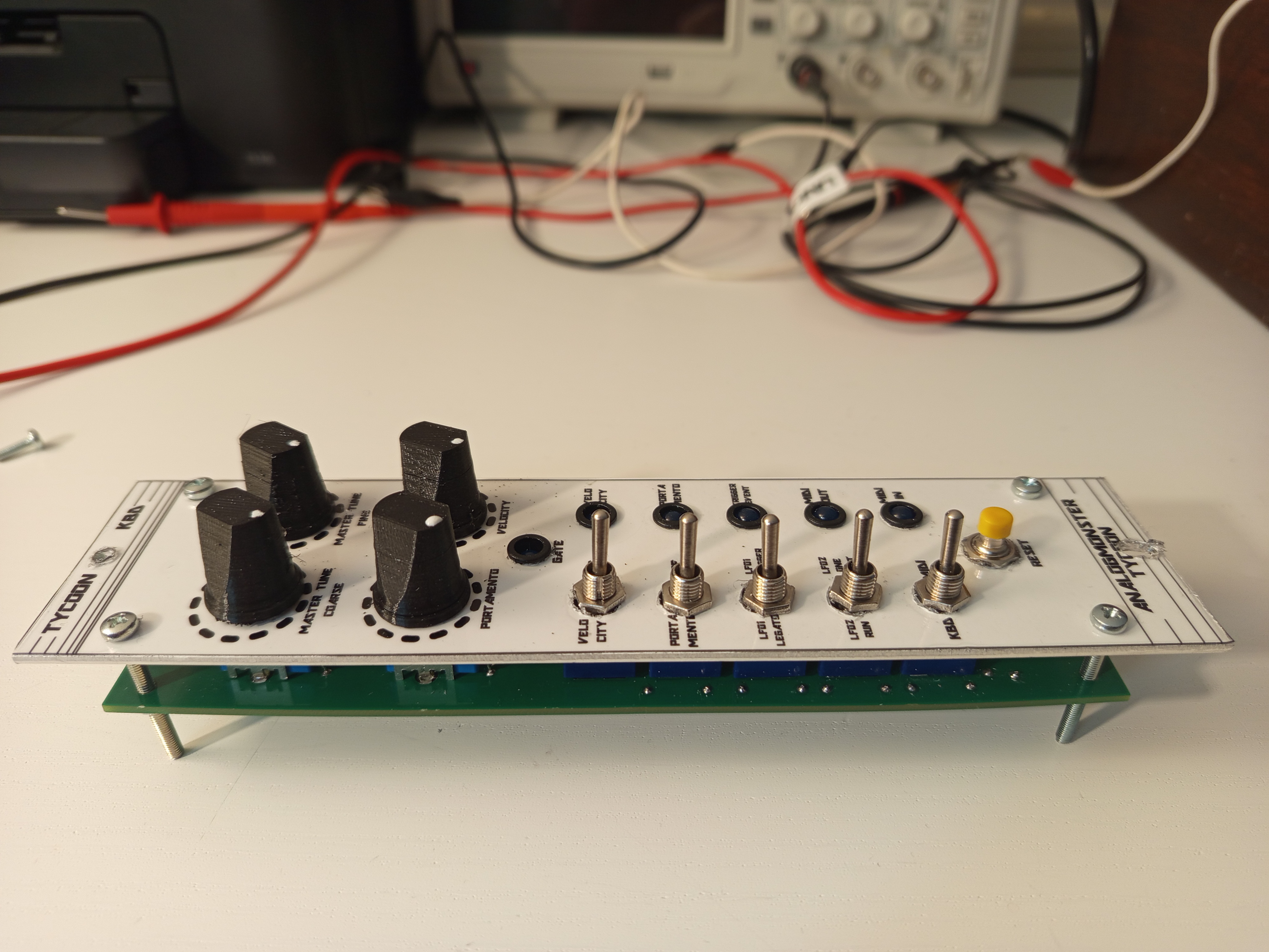

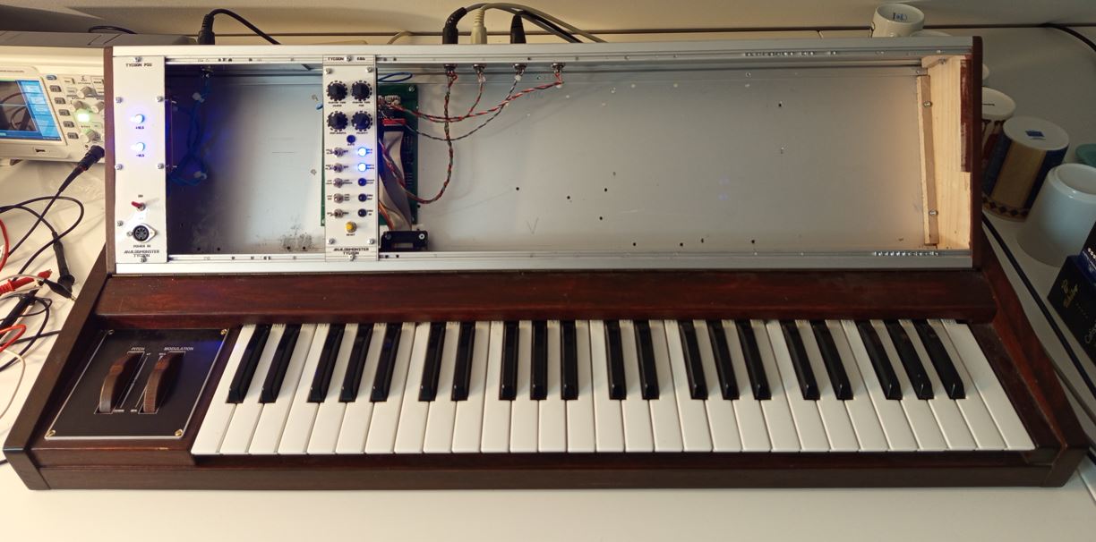

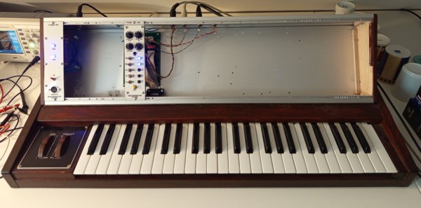

Ambitious project! Is your keyboard/case your own design too? Also (forgive my ignorance) but are your modules Eurorack format?
Sounds like it will be a cool addition to your setup.

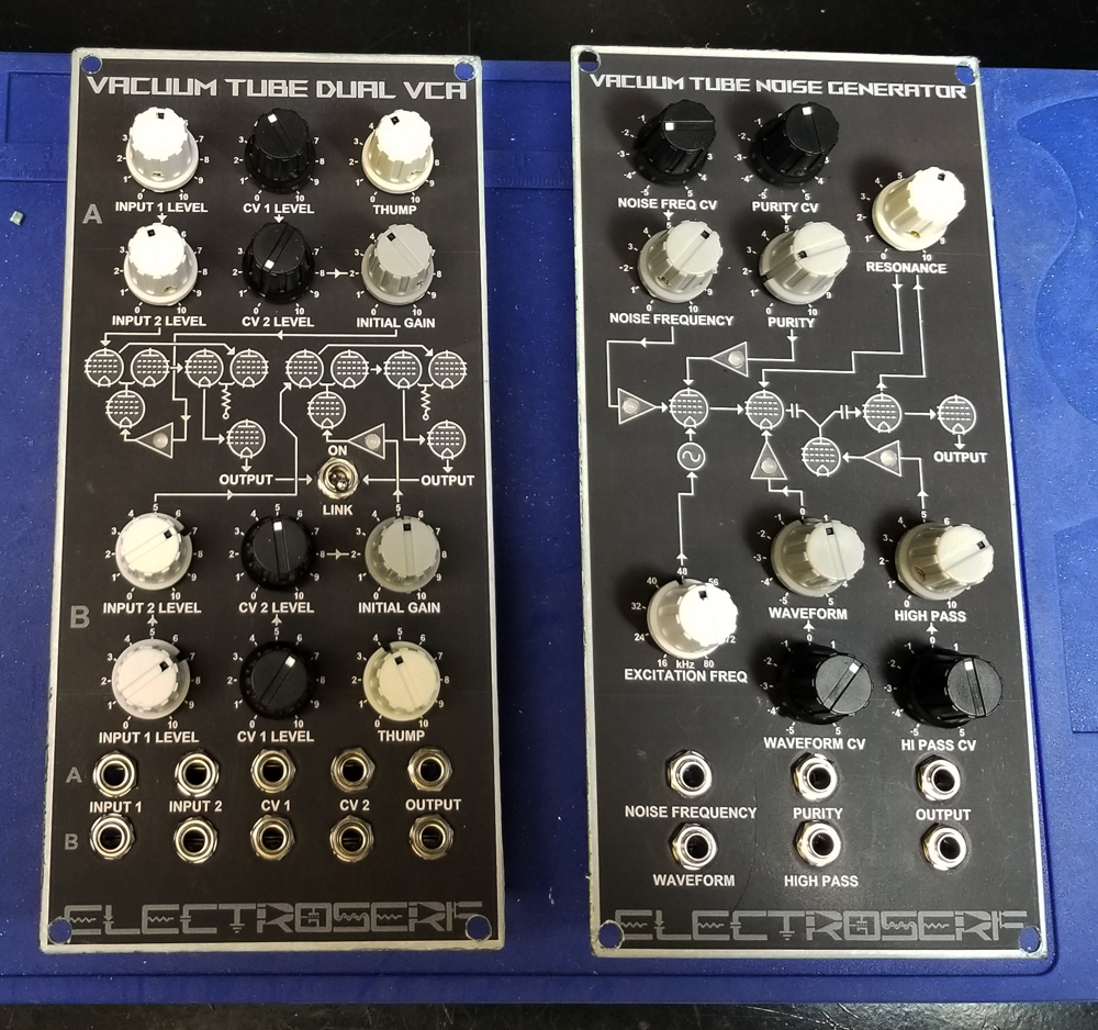

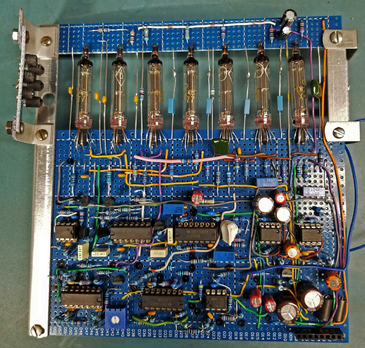

Take care,
Doug
Your pic of those glowing tubes is amazing. Definitely look forward to hearing your creations. Will you be designing a vacuum tube filter?
And one other question: what is your plate voltage on these? (Just curious.) Smile

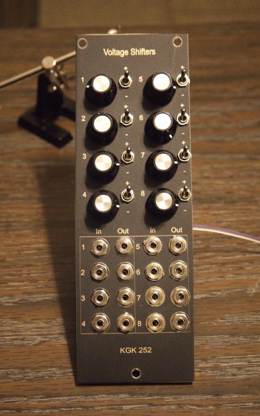

This is a recent build of a handy utility module I’ve dubbed the KGK 252 — a project that also served as a proof of concept for several new design techniques.
I’ve long needed a simple utility to shift control voltage (CV) signals up or down by 5 volts, primarily to convert bipolar CV sources (like LFOs and noise generators) to unipolar signals for use with modules that require unipolar inputs. The KGK 252 meets this need with eight independent voltage shifters.
This was also my first SMD build. I designed the PCB in KiCad and etched it using a toner transfer process. To streamline assembly, I used my laser engraver to create a solder paste stencil, which allowed for neat and consistent application to the SMD pads. The board is mounted with a custom 3D-printed bracket (black plastic, mostly hidden in the photo).
The front panel is black anodized aluminum, engraved using a laser engraver. I designed the panel layout in LightBurn.
Each shifter circuit mixes the input signal with a selectable bias voltage (provided by onboard ±5V regulators) and routes it through a front-panel attenuator. A buffer stage follows the attenuator to ensure a stable output capable of driving multiple downstream modules without signal degradation.
The toggle switches on each channel are three-position: -5V, unshifted, and +5V. When no external signal is connected to the input, the module functions as a voltage bias source — allowing it to serve double duty in patching and module calibration.
Voltage Shifter Front Panel
 Filesize:  7.65 MB
 Viewed:  153 Time(s)
Voltage Shifter PCB
 Filesize:  11.55 MB
 Viewed:  122 Time(s)

Thank you for the nice comments!
I have a VCF module about 70% designed and I will be working on that after I get the VCA and Noise modules completed.
Plate voltages in my rod tube designs run between 30 and 50 volts depending on the module. So no dangerous high voltages, safe and easy to work with!
Take care,
Doug
