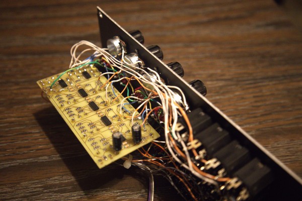

My latest build continues my work integrating Arduino-based control modules into my modular synthesizer while keeping the signal path fully analog. Behind the panel is an Arduino Mega with custom interfacing to bridge the 5V logic of the microcontroller with the 10V world of analog synths.

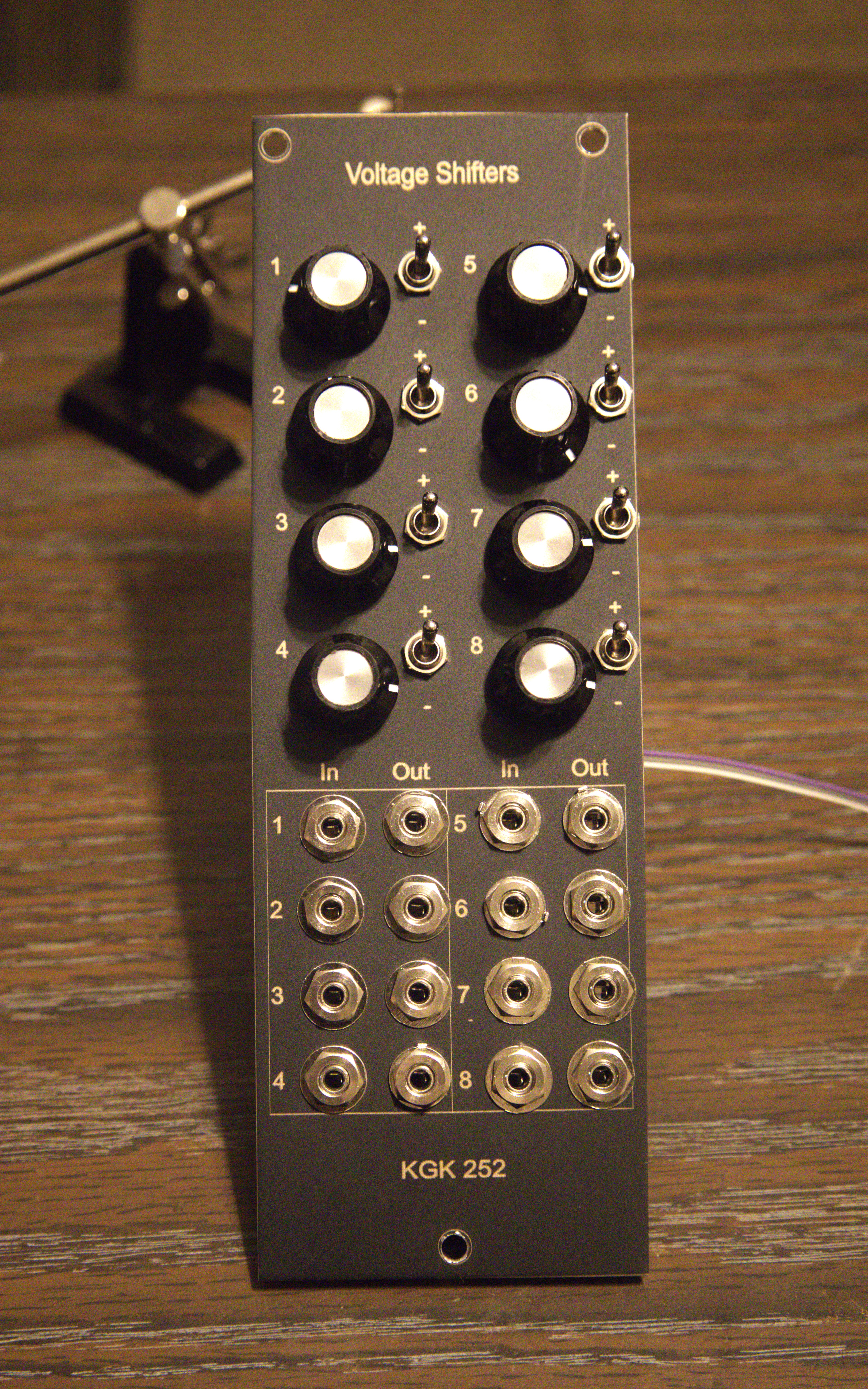

Introducing the KGK251: Quad Voltage-Controlled Envelope Generator
The KGK251 is my first build of 2025 (hence the numbering). It features four independent envelope generators (EGs) that can operate separately or as a group. My goal was a minimalist, intuitive interface, so the module has just:
One encoder for parameter selection and adjustment
One crossfader pot for seamless transitions
Each EG has four front-panel jacks:
Gate In
Trigger In
Crossfader CV In
Envelope Out
Envelope Design: Five Stages with a Unique Dual-Decay Approach
Each envelope features Attack, Decay 1, Decay 2, Sustain, and Release. The two-stage decay system prevents the typical “static” sustain level by allowing the envelope to evolve naturally over time. This keeps the envelope shapes organic and dynamic without requiring excessive complexity.
A/B Parameter Sets & Crossfading
Each EG has two parameter sets (A & B) that can be blended using the crossfader, allowing smooth morphing between two different envelope shapes.
Global Control: The module includes an ALL mode where parameters and crossfader positions apply to all EGs at once.
Per-Envelope Control: Each EG has its own crossfader position plus a dedicated CV input. The total crossfader value is the sum of the Master Crossfader, individual EG Crossfader, and external CV.
Wrapping Behavior: When summed values exceed the range, they wrap around instead of just staying stuck to the B parameter settings.
Additional crossfader modes are in development and will be added later.
Flexible Run Modes: Individual vs. Global Control
ALL Mode: A single pair of A/B parameters can drive all EGs, with individual offsets.
Individual Mode: Each EG can be set independently, with the option to disable the Master Crossfader’s influence for precise shaping.
Coming Soon: Video Demonstration
I’ll be posting a video soon to showcase these features in action. In the meantime, I’ll be sharing photos of the module and an MP3 demo of the patch.

Another impressive design of yours thumright
I appreciate controlling analog modules with microcontrollers. This offers to combine the best of both worlds, analog and digital / programmed.

Thank you for the compliment. This has been a learning experience, for sure! Smile

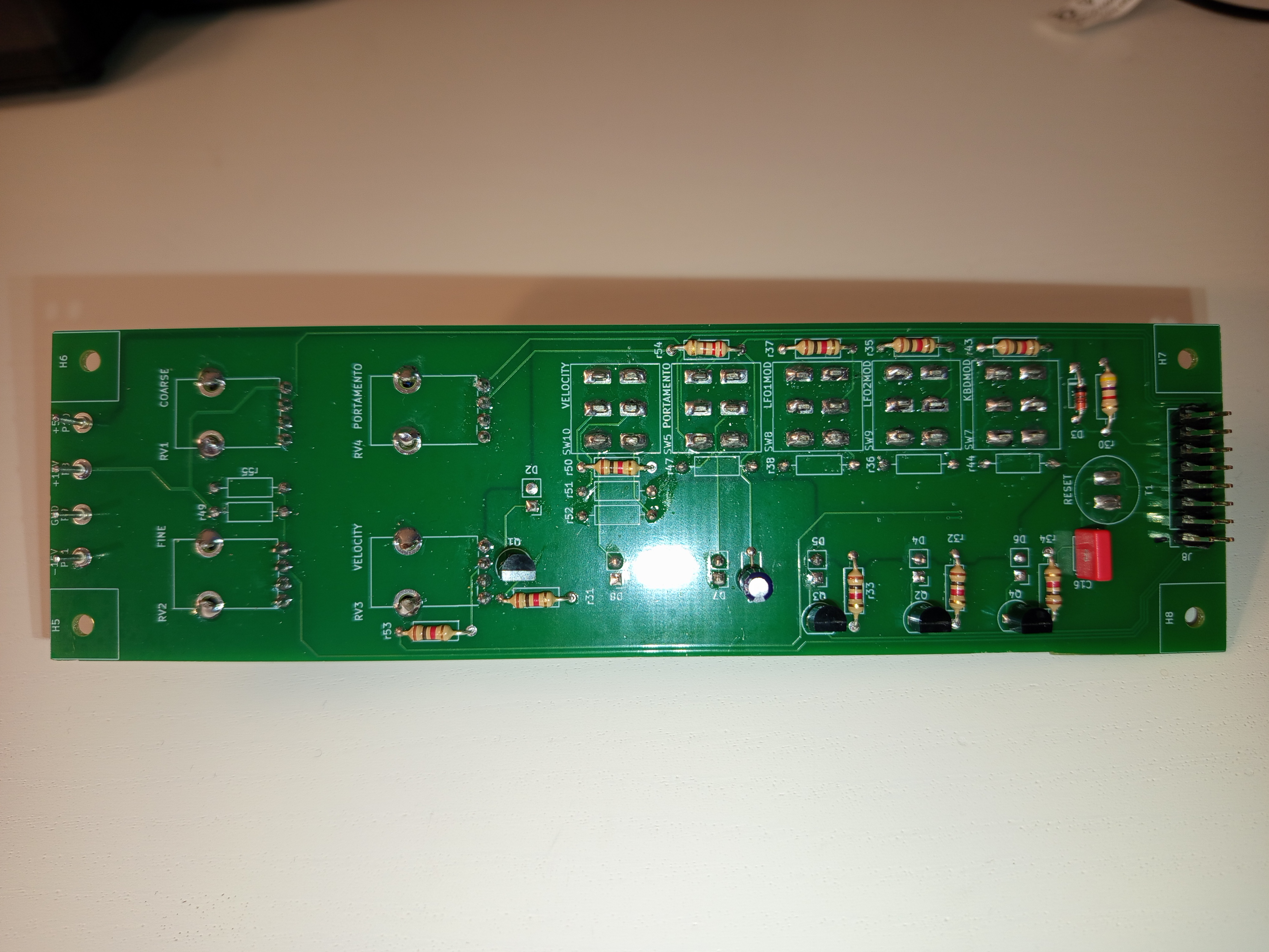

After finishing my Oberheim SEM cloning activities I've just started my new keyboard synthesizer project, the TyCoon synthesizer.
It is a system which is mainly inspired by the famous Synton Syrinx, but beside the Syrinx functions the TyCoon will provide some extra features and additional functions, like MIDI handling, stereo output panner, sequencer and others.
So the first steps are done, the keyboard interface is (nearly) finished and integrated, and first integration tests are made.
List of the TyCoon keyboard interface functions compared to the Syrinx:
1.) Syrinx: Resistor string <=> TyCoon: FATAR interface
2.) Syrinx: Master tune COARSE and FINE <=> TyCoon: as well
3.) Syrinx: Internal monophonic CV and GATE creation <=> TyCoon: as well
4.) Syrinx: Portamento <=> TyCoon: as well
5.) Syrinx: External CV out GATE out <=> TyCoon: no equivalent
6.) TyCoon: Keyboard velocity analysis <=> Syrinx: no equivalent
7.) TyCoon: Portamento switch <=> Syrinx: no equivalent
8.) TyCoon: MIDI OUT <=> Syrinx: no equivalent
9.) TyCoon: MIDI IN/THRU <=> Syrinx: no equivalent
Current build state

The Peasant wrote:
Cynosure, I am planning on making a video of the VCO module in action with sound examples when I get the VCA module completed. I am working on building that module now along with a noise generator.
Thanks for the nice comments, Grumble! I have attached a few more inside pics for you. Lots of stripboard work!
Take care,
Doug
Your pic of those glowing tubes is amazing. Definitely look forward to hearing your creations. Will you be designing a vacuum tube filter?
And one other question: what is your plate voltage on these? (Just curious.) Smile

This is a recent build of a handy utility module I’ve dubbed the KGK 252 — a project that also served as a proof of concept for several new design techniques.
I’ve long needed a simple utility to shift control voltage (CV) signals up or down by 5 volts, primarily to convert bipolar CV sources (like LFOs and noise generators) to unipolar signals for use with modules that require unipolar inputs. The KGK 252 meets this need with eight independent voltage shifters.
This was also my first SMD build. I designed the PCB in KiCad and etched it using a toner transfer process. To streamline assembly, I used my laser engraver to create a solder paste stencil, which allowed for neat and consistent application to the SMD pads. The board is mounted with a custom 3D-printed bracket (black plastic, mostly hidden in the photo).
The front panel is black anodized aluminum, engraved using a laser engraver. I designed the panel layout in LightBurn.
Each shifter circuit mixes the input signal with a selectable bias voltage (provided by onboard ±5V regulators) and routes it through a front-panel attenuator. A buffer stage follows the attenuator to ensure a stable output capable of driving multiple downstream modules without signal degradation.
The toggle switches on each channel are three-position: -5V, unshifted, and +5V. When no external signal is connected to the input, the module functions as a voltage bias source — allowing it to serve double duty in patching and module calibration.
Voltage Shifter Front Panel
 Filesize:  7.65 MB
 Viewed:  235 Time(s)
Voltage Shifter PCB
 Filesize:  11.55 MB
 Viewed:  178 Time(s)

Kevin,
again a stringent development of yours - it is a joy to see the way you proceed your projects Cool
And I agree that this is a useful and important module. I did a similar module integration in my Formant project, a module which I consider as extremely useful and which I use quite often, the CVI

Thank you for the nice comments!
I have a VCF module about 70% designed and I will be working on that after I get the VCA and Noise modules completed.
Plate voltages in my rod tube designs run between 30 and 50 volts depending on the module. So no dangerous high voltages, safe and easy to work with!
Take care,
Doug
Your panels look great! I should probably look at getting better front panels made, mine are designed in MS Paint (LOL), printed out on photo paper using my laser printer, laminated with matte laminate sheets, and stuck to the metal panel with double-sided tape. It's pretty easy to do, but not anywhere near as durable as an actual all-metal panel.
