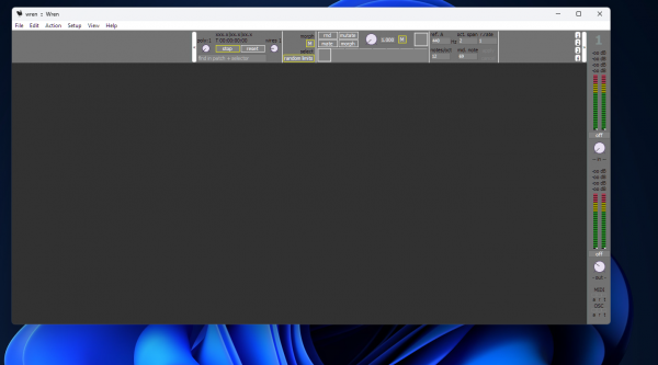

Someone uses WREN on Windows 11 x64 sucessfully ?
Im trying time to time install with new relases but modules not generating on first run.

At first run i have error: A device ID has been used that is out of range for your system.

Could there be an issue with a selected audio device?
It is not really clear to me from the log file.
The screens you posted suggest that an error is generated when an audio device is being opened.
And that you then click away tat message, on which wren produces a boring look without a patch and without modules.
Am I interpreting this corrctly?

This error pop up on start but when i click ok wren starting.
I can set audio settings to asio and general settings without problem.
I can run audio engine but there arent any modules. Palette of modules is empty.

PostPosted: Fri Jul 04, 2025 5:46 am    Post subject: Reply with quote  Mark this post and the followings unread
The log says nothing about populating the module selector - and it should say that. This I do not quite understand .. but apparently the error generated causes the modules not being created / populated.
The log also at first says that there is no ini file; then a little later it says that there is a new ini file being made and then saved as : 'C:\bin\wren.ini'
Is that file actually present after you ran wren once?
And if it is present - what happens when you start wren again after you had selected audio devices? [so for the 2nd time .. or later]

Hmm .. it could also be MIDI i think
Posts: 24592
Audio files: 309
PostPosted: Fri Jul 04, 2025 6:03 am    Post subject: Reply with quote  Mark this post and the followings unread
Ok ..this can be tested .. two things to try ..
1) if you start wren, and then change the window size, quit wrenand start it again - did it remember the window size?
2) if you start wren, then change the folder setup [from the menu setup/folder setup] - and then stop wren and restart it - did it remember the folder setup?

wren.ini is present after first start. I can set audio devices and channels.
When i start wren once again i must change settings again. Configuration is not memorized.

No windows size and folders after change are not memorized. They resetting to initial settings.

Looks like setting midi crashes then ... that is one of the first things tried on setting up [and does not generate proper error messages].
As your wren.ini is being saved .. you can try to set up midi from the menu, settings ..
then exit wren and restart it ..
if that does not work .. i'd like to see your wren.ini file ..
and maybe you could have a look at the section [FormMidiSelect] to see what the MidiInDeviceName and the MidiOutDeviceName are ... and if your sustemhas those devices.

Thanks a lot for help. Now its working.
Yes...that was some problem with midi like you point out. I didnt have any midi devices or midi ports on laptop.
so i installed loopMIDI virtual midi port and everything working again modules are present and config settings saved properly. Cool Smile
So for future if anybody had same situation on windows 11 X64 laptop
without proper audio interface:
I used free KoordASIO for ASIO
and loopMidi virtual midi port for midi.
