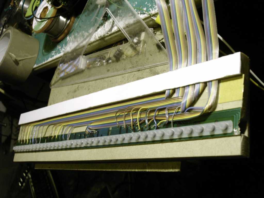

Yep, but my web page has been screwed up AGAIN for some reason. No sounds, pics missing.
Well, the weltschule/tableHooters/waranty Void site has all the basic bends. The site is down a lot, I recommend you save the info.
More fun: Totally remove the pitch resistor and replace with a pot 500K-1M or higher. This thing can be pitched WAY down. I had a pitch with two 1.5M pots in parallel I liked a lot, as you can use one to set the range.
It's duophonic, each voice has it's own envelope signal sent from the blob that is smoothed with two capacitors. These can be replaced, or a pot inserted, or voltages added to change / scale / modulate the envelope. when doing different bends or settings at each capacitor with each key played the envelopes alternate.
An electri-fire discovery: Play with multiple sound select buttons held down. Now pitch way down. Nice right? I had the sound select buttons paralleled with spdt switches to select the button holds.
Mic connection? Ooh, I don't know. Somewhere near the amp section. Usually a 386 poweramp: http://www.national.com/ds/LM/LM386.pdf (pin 2 or 3 ? , but I've had versions with a transistor amp as well.

not only is it easy to bend, it is also very versitile. most of it is hand wired, so this makes it all easy to find.
heads up on a few things though:
• when the screws are not tightened, it is hard to produce a sound from the keyboard, because the sensors do not hit well.
• turn it upside down and be careful with removing bottom well. otherwise, those rubber buttons will go EVERYWHERE! not fun!
• you will find on the voices, when you press more than one key at a time, it sounds very glitchy...this is cool! i found the wires for these, and hooked them up to a rca patchbay!
• you can find lots of groovy stuff, pitch bends, etc. i am sure you will find even more than i did!

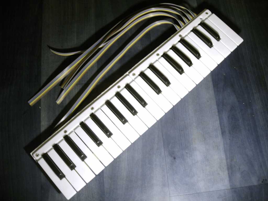

PostPosted: Fri Jan 18, 2013 7:24 am    Post subject: Reply with quote  Mark this post and the followings unread

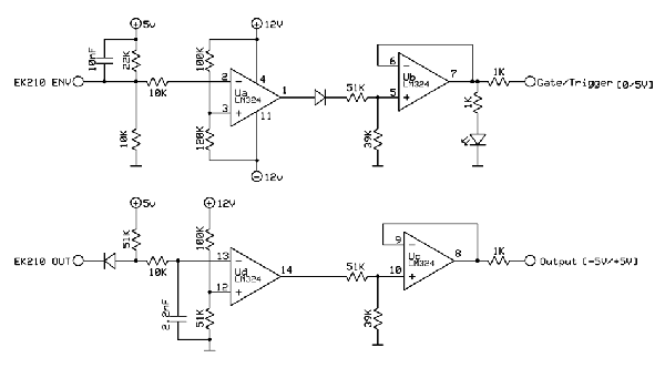

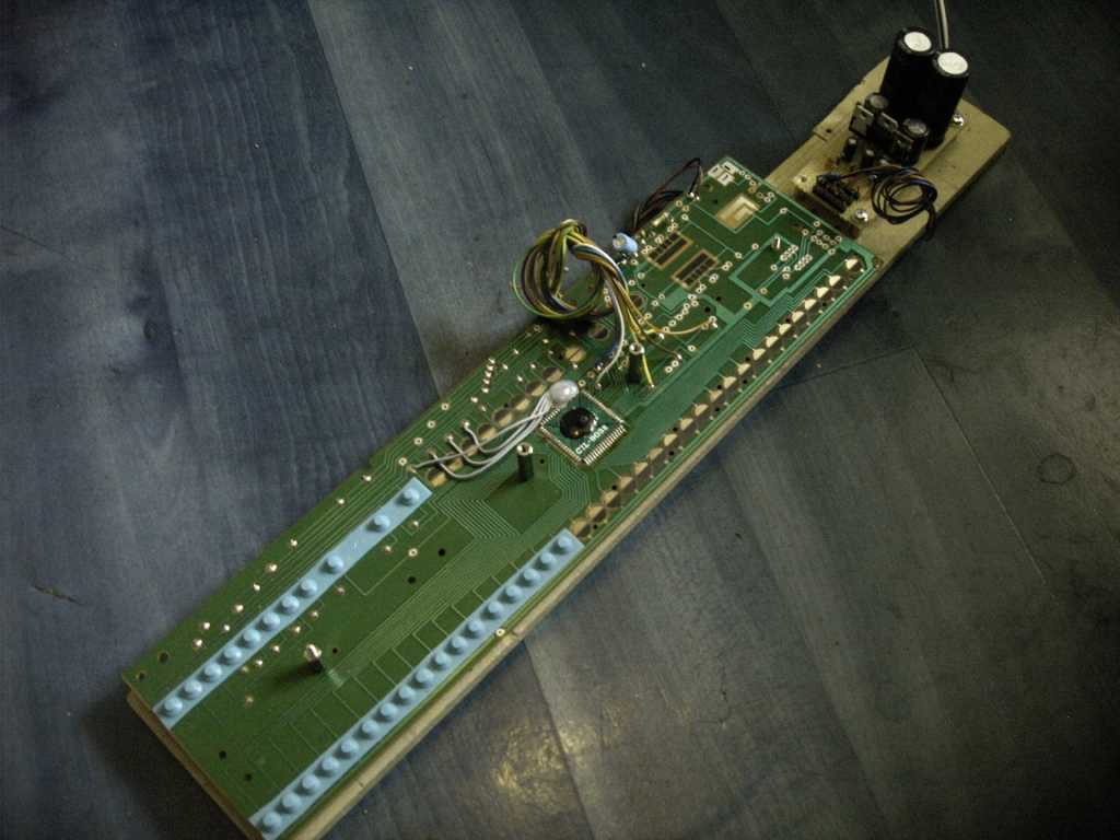

I just got my hands on 2 'new' keyboards yesterday Very Happy
Because they look older then what I usually get I was hoping that these would not be your typical black blob matrix wired keyboards.
One thing I noticed is that they both have almost the exact same functions which made me wonder, could it be that they actually
contain the same chip ? They also sound pretty much the same except the demo is different.
So I opened them up, and they both contain a black blob but it doesn't look like your usual circuit. It has a lot more pins and there are
a lot of other components in there aswell. However one of those keyboards is constructed in such a way that I have to resolder some
ribboncables to actually see what parts are on it and how it's wired.

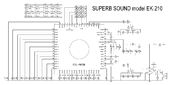

anyway, after drawing the schematic of the other keyboard, I searched the web to see if I could find some info on it. I did a quick search
yesterday but didn't find a lot. But now I did, and what I suspected just got confirmed Laughing . The keyboard I drew the schematic of is labeled
as 'SUPERB SOUND model EK-210" while the other one doesn't have any identification on it at all. But by looking for the EK-210 I ended up
at the Table Hooters site for the Hing Hon EK-001, and it turns out that that is the other keyboard I have Shocked !
banana party!
Searching for the Hing Hon EK-001 gives a lot more hits and it's also how I found this thread, So I shall share any info here.
first some dfferences between the 2 keyboards:
The EK-210 has seperate controls for rhythm and voice volume which the EK-001 doesn't have (so you can add that to it).
However the EK-001 has a mic input with volume control, the EK-210 doesn't have a mic inout at all. I haven't tested it, but I assume
it's just mixed in with the signal, not processed in any way. (Might be usefull for feedback though). As I allready mentioned the demo is
different, I really like the melody of the EK-210. Not sure what it is, but I'll probably find that info somewhere. The EK-210 runs on 6
batteries and has a DC input labeled to be used with 9V. While the EK-001 runs on 4 batteries and has a DC input labeled to be used with

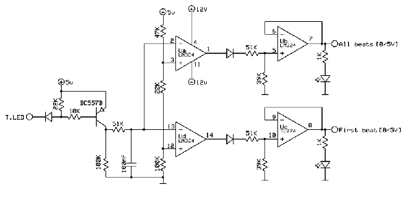

4.5-6V. The EK-001 has a headphone ouput, the EK-210 doesn't. And then there is another very usefull feature on the EK-001, a beat LED
which actually flashes brighter on the first beat. I have to check what signal this is (probably PWM) but I bet it can be used as a CLK for
other circuits Very Happy (and add it to the EK-210)
I haven't drawn the schematic of the EK-001 yet (might be available online) so I can't compare the actual circuit yet. I did noticed there was a
trimpot on the Ek-001 PCb which the EK-210 doesn't have.

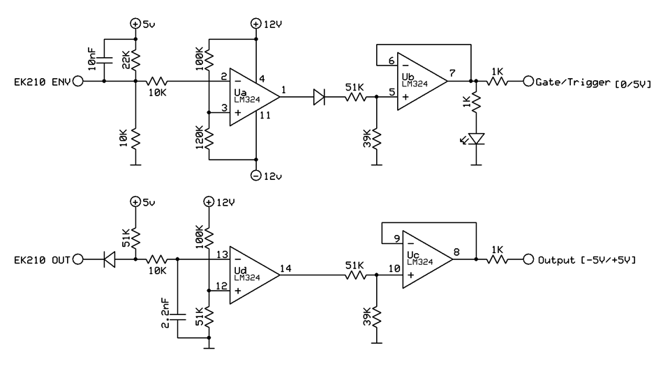

Some things I noticed from the EK-210 schematic. There is a voltage regulator section with a 5.1V zenerdiode for the supply of the main chip/blob.
I will probably replace this with a standard 78l05. There is an LM386 in there which is powered directly form the input voltage. Well not directly,
since there is a 4.7 ohm resistor in series with the batteries/DC in. There are 3 resistors and 1 capacitor in there that I'm not sure what they
are for yet (I'll approach them with my finger Wink) I guess at least 1 is for pitch, maybe in combination with the cap ?. But I bet I can find that
info somewhere. And then there is something I'm wondering about considering the drum sounds. 4 pins of the chip/blob are tied together to
produce the drums. There are also 4 drum sounds, could it be that each pin has a seperate sound ? Or otherwise just adding some switches
between those pins might give some interesting variations. (anyone who tried this ?)
I'm gonna see what info I can find and I want to draw the schematic of the Ek-001 aswell. After that I have some other projects that I should
finish first because it looks like this is gonna be a big but fun one (maybe I'll combine the 2 keyboards)

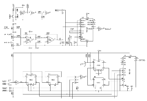

Posts: 5881
PostPosted: Fri Jan 18, 2013 11:09 am    Post subject: Reply with quote  Mark this post and the followings unread
I'm reading the AK-900 pdf which is VERY interesting Very Happy
it does seem to use a 9037 chip while the EK-201 uses a 9038 chip. Maybe it's just the demo that's different maybe something else,
but the schematic of the AK-900 is very similar to the one I've drawn of the EK-210. (will post it here)
Looking at the block diagram of the 9037 it shows (as I was hoping) that the 4 pins used for the drums each have there own drum sound.
Which means you can add level/panning control and on/off switches (which you could control with some logic) for each of them Very Happy
I'm wondering now if it would be possible to add an external oscillator instead of the build in one, then use some digital waveform and
play with that on the keyboard.
edit: I'm actually pretty sure it can work with an external oscillator,. hmm how about a CD4046 ? or since I'm working on Tim Escobedo's
PWM circuit (with VCO) add that, have some other sound source control the main CLK speed of the CPU. Also the key frequencies are derived
from the main CLK so if I divide it and hook it up to the CLK of the other keyboard I should be able to play 6 octaves.
full schematic traced from PCB.

Ok I'm having a go at it and see where this project will end or strand Wink
Starting with the EK210, which has a nice PCB to work with.
I first removed all the components Shocked except for a couple of the jumperwires that are only connecting some of the buttons to the CPU (let's call it that).
Next thing I did was carefully seperate the pins for the drumvoices. This was actually harder then I expected but with some wick an exacto
knife and some patience I managed to get it done. I then soldered some wires to the pins and secured those with a big blob of hotglue. The
wires are connected to solderpads that previously had some jumperwires soldered in to connect some of the rhythm buttons. I'm going to use
the contact pads from the buttons/keys to solder wires to, but I first have to scrape off the carbon (at least I think that's what it is). This
will leave me with some nice big solderpads which are not very likely to come off (something that can happen when soldering wires to traces).
Since I removed all the components, I have solderpads free that are connected to all the other pins of the CPU. So I attached wires to the
OSC IN, RESET, VIBRATO (not sure if I will use that one), TEMPO LED (there are allready traces and solderpads to add a LED and resistor it
just wasn't used Confused ), OUT1, OUT2, ENVELOPE1, ENVELOPE2, and DEMO.
I also soldered 2 wires for the power to the PCB but I added a 10 ohm resistor in series followed by a 100nF cap, 220uF cap and a 5.1V zenerdiode
(just in case). The components are all soldered to the bottom/copperside of the PCB.
Since I'm planning to add some analog goodies to it I decided to make a PSU that besides 5V also outputs +12V and -12V, so no wonky virtual
ground that might upset some jovians Wink. I happen to have a 12VAC/830mA wallwart so that's what I'm using together with a design based
on the MFOS wallwart supply (with an extra 5V regulator). I mounted the the PSU and keyboard PCB on a piece of wood for convenient testing.
(more to come)

testing ,. well without a CLK to run on it won't do much so that's the first thing I cobbled together.
I'm using a 4046 as planned which i'm pushing a bit beyond it's limit since the datasheets suggests to use a minimum of 100pF for the timing
capacitor when running at 5 volts, but I'm using a 22pF one which seems to work. I also added an overly complex octave switch Laughing
The CV input stage consists of 2 opamps. The first one (U1a) is configured as an (inverting) summing amp which mixes 3 CV sources together: the
main frequency control, internal modulation (wired to an LFO maybe with a switch for other sources) and external CV in (-5...+5V but can be
adjusted with the frequency pot and attenuator for other input levels). The second opamp (inverting) adds offset and adjust the levels to the input
range of the 4046 (± 1V ... 4.5V). a zenerdiode protects the 4046 against a CV voltage that's too high or negative.
The 4046 itself is only used as a very basic VCO, nothing fancy. I initially tried to add the finetune pot to the CV input which is how it's usually
done with VCO's, but I noticed that allthough it had a profound affect when the frequency was low, it was hardly noticable when it was high.
There's a schmitt trigger (40106) on the output because without it the output looked more like a sine then a square. (maybe that's what the
100pf suggestion was for Wink). It also inverts the signal but that get's taken care of further on. All the unused inputs are connected to GND.
I'll explain the reset section in a minute, but first the what's-all-that-stuff-for-? octave switch. Since I have 2 of these keyboards I am
also planning on making 2 of these VCO's, but I want to be able to run them both from the same VCO aswell. Since the required frequency is
so high there is not really any use for another external CLK, so there's a switch to select between VCO1 and VCO2. Followed by a schmit trigger to
buffer and most importantly reinvert the CLK signal. While the VCO is running this doesn't really matter but I want it to be low when it's turned
off (on a reset).
The CLK signal is then divided twice by using 2 flip flops (4013). This way I end up with 3 different frequencies and since the pitch of the notes is
derived from the CPU CLK this gives me 3 octaves. I could have made it easy and just added a rotary or slide switch, but I wanted to use a toggle
switch with center position which is where the mux (4052) comes into play. By making either the A or B or both dataselect inputs high I can
choose between the 3 CLK speeds. I don't know yet if I will use the other half of the mux, I could add some LED's but maybe I'll find another use,..
But wait there is more!? yes indeed there is. Because switching the CLK of a CPU can cause (unwanted) glitching, or worse; crashing, I added some
extra bits. Therefore the octave select switch is not connected directly to the mux but there are some flip flops in between. This means that I can
toggle the switch all I want but nothing will happen untill the flip flops get a CLK signal. To get this signal I used an OR gate (diodes + resistor)
connected to the main CLK and it's divisions, so the output will only be low when all inputs are low. The inverter turns this into the necessary CLK
signal. The result is a smooth transition whenever I flip the octave switch. And because the CLk speed is so high it still happens instantly.
I have noticed that the CPU is pretty crashproof btw. but I had the idea in my head and it only needed a few components and one extra chip (just
one more,. I promise that's the last one Wink)
oh almost forgot the reset.
The CPU has an active low reset input, so the reset switch is a pushbutton connected to GND. And the 100nF capacitor is to provide a reset on
startup which was also there in the original circuit. I also wanted the VCO to stop (using the inhibited pin) and the CLK output to be low on a reset.
Since both the VCO and the flip flops used for the octave divider need a high signal for this, Ua inverts it. I added an extra delay for the VCO,
not sure why actually. I think it has something to do with making sure that the CPU is not still in reset mode when the VCO starts because the
treshold level might differ from that of the schmitt triggers, or something silly like that. And I want to reset both keyboards with one button so I
allready added some extra inputs.

The keyboard(s)
I wanted some bigger keys and I now have two other toy keyboards which happen to have 37 larger keys (SK1 size). I actually got those because I was
working on another keyboard which I fried just before I had it finished,. Sad I managed to find another one but fried that pretty much instantly
(not sure how) but luckely I found a third one and got it all working now. So I have two that aren't working but I can use the keys Very Happy. One small problem,
the keyboards are wired in a matrix, which is pretty standard, but the EK210 keys are just switches to GND. This is actually a lot easier to work with
but it does mean I have to adapt those larger keyboards.
I finished one a couple weeks ago. I had to cut a bunch of traces (make two cuts with an exacto knife and heat up the part inbetween with a soldering iron)
and attach a wire for every key (and a GND wire). The way I made the keyboard the wiring all had to be very flat so I used some rainbow-ribboncable for that.
It was still a bit tricky to get it in but with the use of some doubleadhesive tape it all stayed in place. I covered the cables with a piece of black
tape.

If I don't use the internal VCA's I will loose this effect, but
I could recreate it with more variation on every voice using an ADSR, VCA and LFO, which I am planning to add anyway. Cool
Actually I come up with a way to do both Very Happy
As I allready found out the envelope pin goes low to charge a capacitor when pressing a key. I'm making use of this by setting the envelope level
not at max level, but a bit lower. The output will still be a continuous tone, even after you release a key, but it's amplitude will be lower. I attached a
comparator to the envelope pin with a reference voltage set between the set envelope level and the voltage it's pulled too when pressing a key. So
now it gives a short pulse at every key press, well at every other keypress since the keyboard toggles between the 2 internal oscillators.
At least that's what I thought but I was only testing with the piano sound. For the notes that have a sustain (flute, violin, organ, horn) the envelope
pin stays low untill the key is released, and for the banjo it pulsates Smile (music-box and guitar have a short pulse just like piano). I want the trigger/gate
signals to be 0/5V so I added a diode and a voltage divider to the output, buffered by a voltage follower. This should save me some work since I
was thinking that I had to add diodes and capacitors for every key to create gate and trigger signals. (as I did with the Lun-A-Key).
Now for the output. by setting the initial envelope amplitude below max there will be a change in it when pressing a key. A short pulse for
piano/music-box/guitar, a bit of a tremelo effect for the banjo, and for the flute/violin/organ/horn it will be louder as long as a key is pressed.
But I want a constant output of -5V...+5V (compatible with other synths and modules I've build). Since it's just squarewaves I added another
comparator, also with a voltage divider and voltage follower.
next I have to think about a way of mixing both the envelope signals together. And I also have to mix the outputs together which besides with a
standard resistor mixer I could do with some logic gates aswell. I'll convert them to 0/5V signals so I can also use them to control other things.

PostPosted: Sat Apr 20, 2013 12:11 pm    Post subject: EK210 envelope and audio circuits Reply with quote  Mark this post and the followings unread
I made some small changes. and added some more things.
I changed the 10nF capacitor on the envelope output to 100nF which was needed for the gate/trigger mixer I've added (circuit at the bottom).
The envelope signals are first converted into a pulse and then mixed together with an OR gate (2 diodes and resistor). Because the pulse was too short
to light up the LED I added an extra decay with a 1M and 10nF capacitor. It's still very short but the LED now flashes as bright as the other two.
The audio part now has PWM control (based on Tim Escobedo PWM) and 0/5V aswell as -5V/+5V outputs. I also added a mixer for which I used
a CD4052 in a similar setup as JingleJoe's ANY gate. The top part mixes the signals together in a logic way, selectable between XOR/OR/AND,
while the bottom part is the equivalent of a (non-inverting) summing amp with a gain of 0.5. both signals are then converted to -5V..+5V levels
which I will use for the rest of the circuits.

Another thing I did is convert the tempo LED into usable signals. Besides blinking on the beat the Tempo LED flashes brighter on the first beat.
The way this is done is by turning the LED on/off on the first beat while on the other beats it's not fully on but instead it's just flashing really fast.
So I buffered the signal and added a low pass filter which converts it into 3 different DC voltages. These are converted into two outputs with the
help of two comparators. One that is only high on the first beat, and one that is high on all the beats. Voltage levels are then converted to 0/5V and
buffered.
I haven't soldered this part yet but after this I probably have room left for about 3 more chips on the perfboard I'm soldering. The only signals
from the keyboard that I haven't processed yet are the drumsounds so that's next. I'll probably add some buffers and trigger inputs and
leave the mixing for another PCB. Since those are squarewaves too, mixing them with logic might give some interesting result. Laughing
note: at higher tempo's the first beat LED triggers on all beats, I solved this by replacing the 22K resistor (between pins 3 and 12) with a 47k one.
