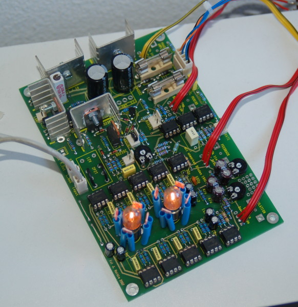

PostPosted: Tue Feb 12, 2008 3:37 am    Post subject: Reply with quote  Mark this post and the followings unread
Mine's finished as well.
I also needed to hardwire the relay points as my relay didn't work either (Futurlec HFD2-12). The LED switches on and off, but the relay doesn't. I think I have another DIP one somewhere so I'll try that.
 Filesize:  104.97 KB
 Viewed:  17345 Time(s)

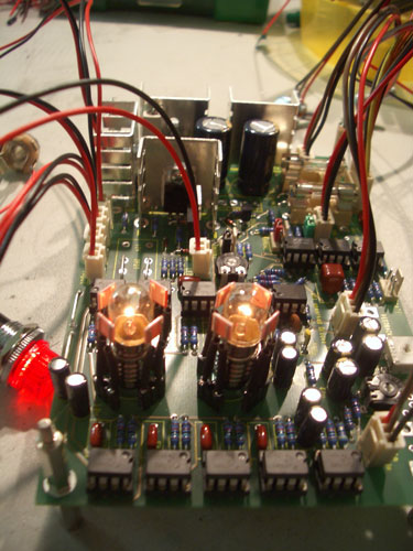

b-funk
Joined: Jul 17, 2007
Posts: 193
Location: Berlin
PostPosted: Tue Feb 12, 2008 4:00 pm    Post subject: Reply with quote  Mark this post and the followings unread
pix... ok, etaoin, you beat me with that... nice work btw...
tomorrow i´ll try another relay, hope it works.
best wishes,
tobias.
it blinks!!!
 Filesize:  58.02 KB
 Viewed:  17283 Time(s)
the brothers...
 Filesize:  51.67 KB

b-funk
Posts: 193
Location: Berlin
PostPosted: Tue Feb 12, 2008 4:43 pm    Post subject: Reply with quote  Mark this post and the followings unread
jürgen,
yes, i use a c type...
i´ll try your suggestion to hook it up to 15 volts if the new relay fails, too...
strange thing that also etaoin had similar problems...
best wishes,
tobias.
etaoin
Joined: Jun 30, 2005
Posts: 761
Location: Utrecht, NL
PostPosted: Wed Feb 13, 2008 12:50 am    Post subject: Reply with quote  Mark this post and the followings unread
My BD239 is also a C-type.
By the way, is the relay supposed to get slightly warm?
http://www.casia.org/modular/
etaoin
Posts: 761
PostPosted: Wed Feb 13, 2008 12:58 am    Post subject: Reply with quote  Mark this post and the followings unread
The Futurlec relay is fine connected straight to 15V (with the 100 ohm resistor).

PostPosted: Wed Feb 13, 2008 3:14 am    Post subject: Reply with quote  Mark this post and the followings unread
Found it. The Futurlec relay has a reversed polarity coil. It needs + at pin 1. It won't switch the other way round. The Takamisawa one I have is non-polar.
