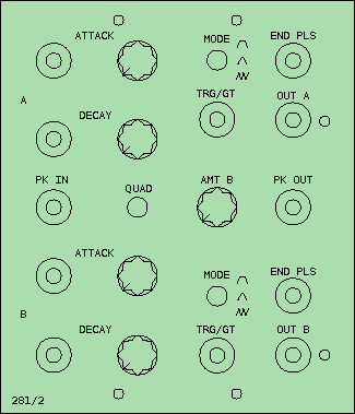

PostPosted: Tue Feb 05, 2008 4:35 am    Post subject: Reply with quote  Mark this post and the followings unread
here is a sample layout i just drew in illusrtator for a 3W frac panel
and then sqished it down to 2W eww it is squished

PostPosted: Tue Feb 05, 2008 5:00 am    Post subject: Reply with quote  Mark this post and the followings unread
here is the same layout in one of those taller formats 2.25" x 5U high
 Filesize:  4.14 KB
 Viewed:  320 Time(s)

PostPosted: Tue Feb 05, 2008 9:46 am    Post subject: Reply with quote  Mark this post and the followings unread
Here's another Frac version with more finger space and less text. I think this will work with board mounted pots because he gives us jumpers to decide which pot does what. The gray things are where pots or switches go. The red and black will be banana jacks on mine. Use a 1/2" knob for b level pot something a tad bigger for attack and decay.
 Filesize:  42.43 KB
 Viewed:  11341 Time(s)

PostPosted: Tue Feb 05, 2008 2:38 pm    Post subject: Reply with quote  Mark this post and the followings unread
What is the difference between topp's choice of "PK IN" and "PK OUT" and Banannaplug's "A or B" out. I chose Topp's method for mine because I have space for two jacks but I don't really understand what they do.
Anyway, here's my updated MOTM format panel. I had to compress the jack spacing to make room for everything. The CV pots are both dual gang for both the Attack and Release CV. I know this limits things a bit but I don't have room for both nor do I have any dedicated attenuator panels.
 Filesize:  33.06 KB
 Viewed:  254 Time(s)

PostPosted: Tue Feb 05, 2008 5:43 pm    Post subject: Reply with quote  Mark this post and the followings unread
Can somebody explain the workings of the QUAD section??
Quad on the controls refers to quadrature and it involves the relationship between 2 functions- A&B; C&D; see a few posts back- quad in the title of the original just means that there's 4- but since alot of folks won't be able to squeeze 4 onto a panel, you can build duals that work jsut the same. i think that is what you were asking..
I would like to order 2 pcb's if possible.
no prob send a PM
peak in is an external input is all to the peak circuit. peak out is just that- "A" is 'normalled' normally to an input, no attenuator, and finally, B goes there too, through an attenuator. this 'peak' output outputs the maximum voltage present at it's input- it can't go below ground because A sits around 0V when not doing anything.
i had space for a jack too so i decided to add an external input. it's nothing more than a jack and another diode. i think it is useful, but it isn't at all necessary. "a or b out" is the same as peak out- but you're not panning between the 2 here. "ORs" on the original panel just means that its like the analog equivalent of an OR function. i don't know what circuit the original used, but i used basically a discrete DTL OR gate.
