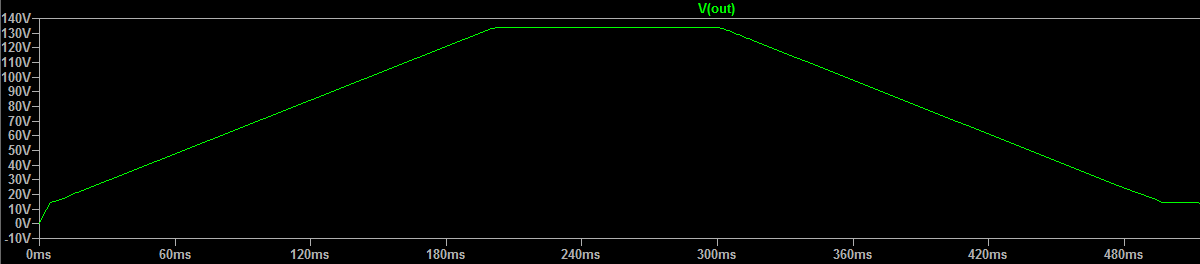

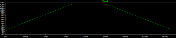

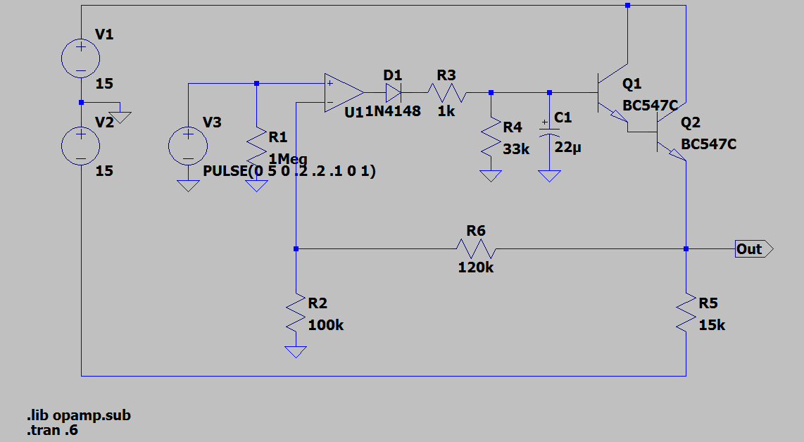

Just compared the schematics of SoST-Flanger with the original StormTideFlanger - Jürgen used the same Envelopefollower back then. So he made the same mistake twice?
Made a short simulation too. I'm not shure, if I coult trust LTSpice, as it says 140Volts on output, by +/-15V as power supply...
Scematic of my simulation, with the corrected resistor
 Filesize:  19.51 KB
 Viewed:  593 Time(s)
Sim of the original schematic
 Filesize:  7.28 KB
 Viewed:  590 Time(s)
...ich will doch nur löten...
Boerge
Joined: Sep 02, 2009
Posts: 82
PostPosted: Tue Feb 26, 2019 6:11 am    Post subject: Reply with quote  Mark this post and the followings unread
Ooops... missed a dot in the values for V3. 5Volts input is a bit too much Wink But with 0.5V input LTSpice runs still to 24V output...
PostPosted: Tue Feb 26, 2019 6:36 am    Post subject: Reply with quote  Mark this post and the followings unread
It obviously is a mistake. The R61 (R2 in your simulation) has to be in the 100K ballpark, not just 1K.

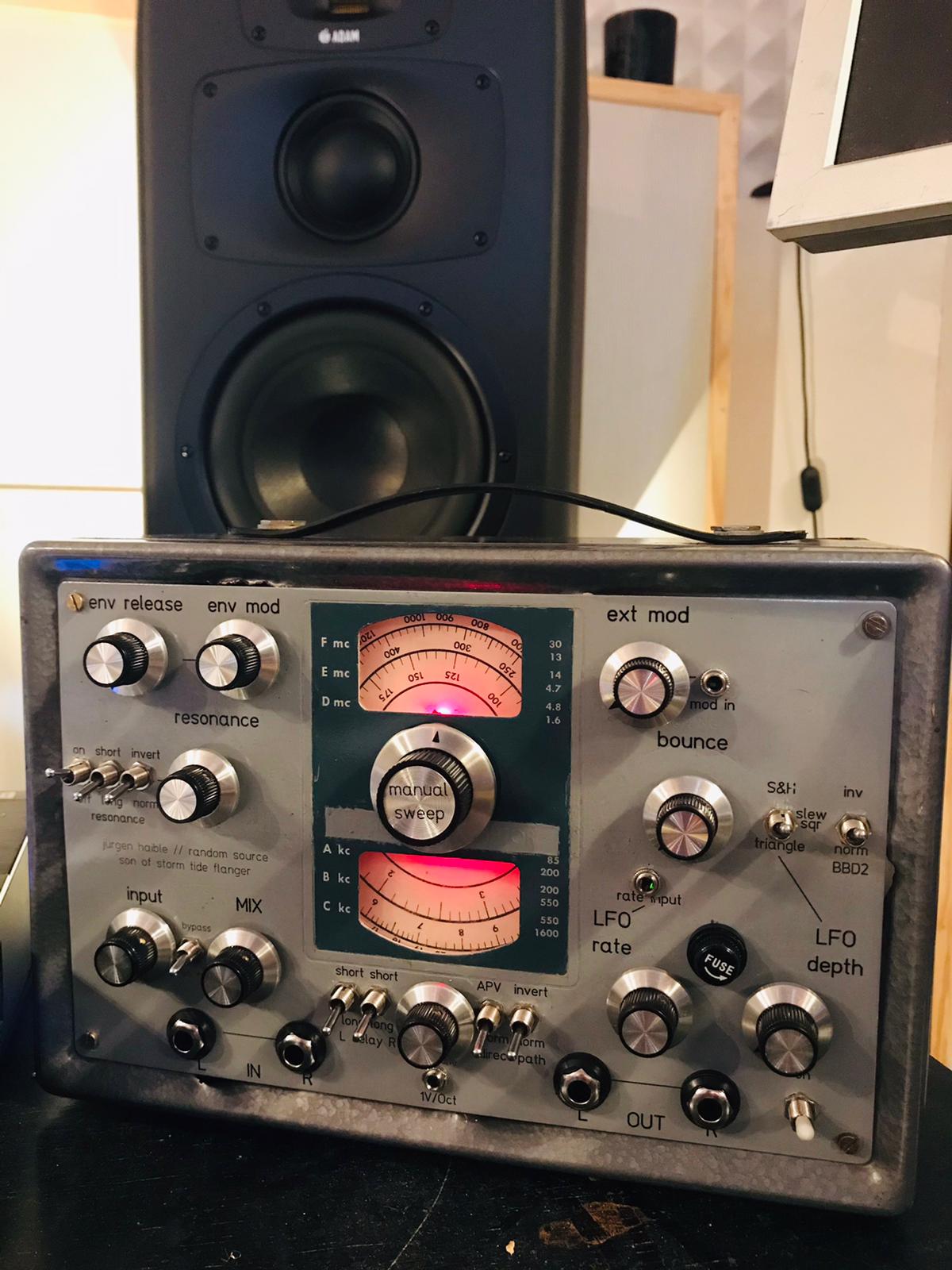

PostPosted: Thu Apr 08, 2021 5:09 am    Post subject: Reply with quote  Mark this post and the followings unread
Done!
At least almost.. I'm getting some weird noise when the BBD2 switch is on "normal"mode. I made little recording. Just a simple sine wave into the flanger. I'm witching it from normal to inv. Pretty obvious.. Does anybody know what this could be.
https://www.dropbox.com/s/xa4nvuofrcqdg6p/flanger%20noise_MIXDOWN.mp3?dl=0
Apart from that it works amazing. And I'm super happy!
 Filesize:  187.04 KB
 Viewed:  120 Time(s)
Posts: 24391
Audio files: 296
PostPosted: Thu Apr 08, 2021 6:37 am    Post subject: Reply with quote  Mark this post and the followings unread
wrentema wrote:
Done!
Nice build!
In the recording I hear clicks .. that probably is the mode switching, and then in one of the two modes there is some distortion ... or actually on better listening it seems to be there in both modes, just a bit softer in one mode ..
Does this also happen when you use a lower input signal? It sounds a bit like it could be clipping somewhere?
wrentema
Joined: Feb 08, 2021
Posts: 8
Location: Berlin
PostPosted: Thu Apr 08, 2021 6:55 am    Post subject: Reply with quote  Mark this post and the followings unread
wrentema wrote:
Done!
Nice build!
Yes it's me switching. It's not so much the distortion (clipping). But that obvious "sizzle electrical noise" sound that comes in and out.. It has nothing to do with input volume it seems.
Hmm I probably need to dive into the schematic whenever I have time (WHY DID NOBODY TELL ME DIY IS SOOO TIME CONSUMING:-)).. Maybe it's an IC?
