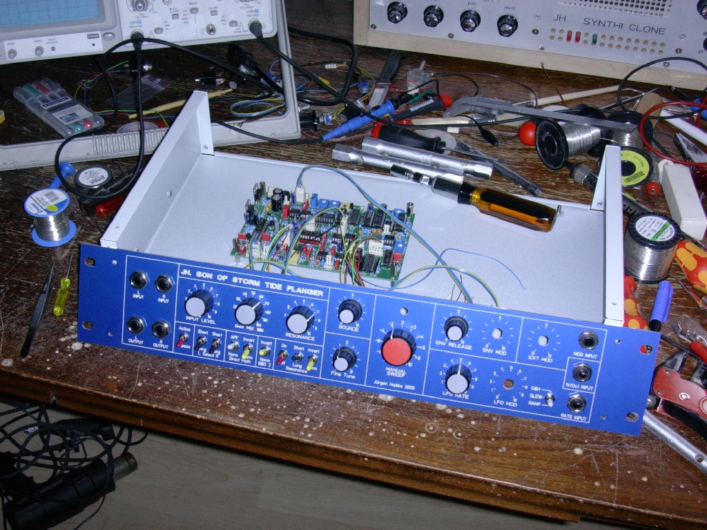

PostPosted: Fri Sep 04, 2009 1:03 am    Post subject: Reply with quote  Mark this post and the followings unread
Working on the Prototype ...
JH.

jhaible
Joined: May 25, 2007
Posts: 2014
PostPosted: Fri Sep 11, 2009 9:56 am    Post subject: Reply with quote  Mark this post and the followings unread
First Demo - just fooling around - but everything seems to work:
http://www.jhaible.de/sonofstormtide/son_of_storm_tide_1.mp3
JH.

jhaible
Posts: 2014
PostPosted: Sat Sep 12, 2009 12:10 am    Post subject: Reply with quote  Mark this post and the followings unread
StephenGiles wrote:
Yes, an amazing demo, the sound is very clean indeed.
Thank you!
I have put up the schematics meanwhile. I run the BBDs at a rather moderate level and put them inside that compander and germanium-diode-limited resonance loop of the ARP Quadra phaser.
JH.

jhaible
Posts: 2014
PostPosted: Sat Sep 12, 2009 6:50 am    Post subject: Reply with quote  Mark this post and the followings unread
TekniK wrote:
jhaible wrote:
limited resonance loop.
JH.
Shocked
limited?
Soft clipping - very soft due to Ge diodes, applied to a compressed signal
JH.

jhaible
Posts: 2014
PostPosted: Mon Sep 14, 2009 3:24 pm    Post subject: Reply with quote  Mark this post and the followings unread
Funky40 wrote:
Serenadi wrote:
Can you please demo the 1V/Oct abilities of the flanger? Some sort of Karplus-Strong things? Would be great.
me too, very interested in Karplus Strong only Demos !
nice Demo , thanks.
Ok, tracking isn't overly good. I adjusted the trimmer roughly, and made these demos:
http://www.jhaible.de/sonofstormtide/sost_karplus_1.mp3
http://www.jhaible.de/sonofstormtide/sost_karplus_2.mp3
http://www.jhaible.de/sonofstormtide/sost_and_wavefolder.mp3
The 3rd one is a combination of my wavefolder and the SoST Flanger in a feedback loop, self-oscillating.
Not as good as my old PM experiments by far, IMO (see http://www.jhaible.de/jh_ana_phys_mod.html). These were made with the old Storm Tide Flanger. But I could never reproduce them with the old one either - I guess it was just a lucky day then - this stuff is very sensitive to all parameters. And generally, the SOST has basically the same signal path as the old ST, so there should be not much difference.
ETA - wait: on these old PM demos, there was a Buchla LPG clone in the signal path as well ...
JH.
