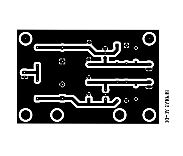

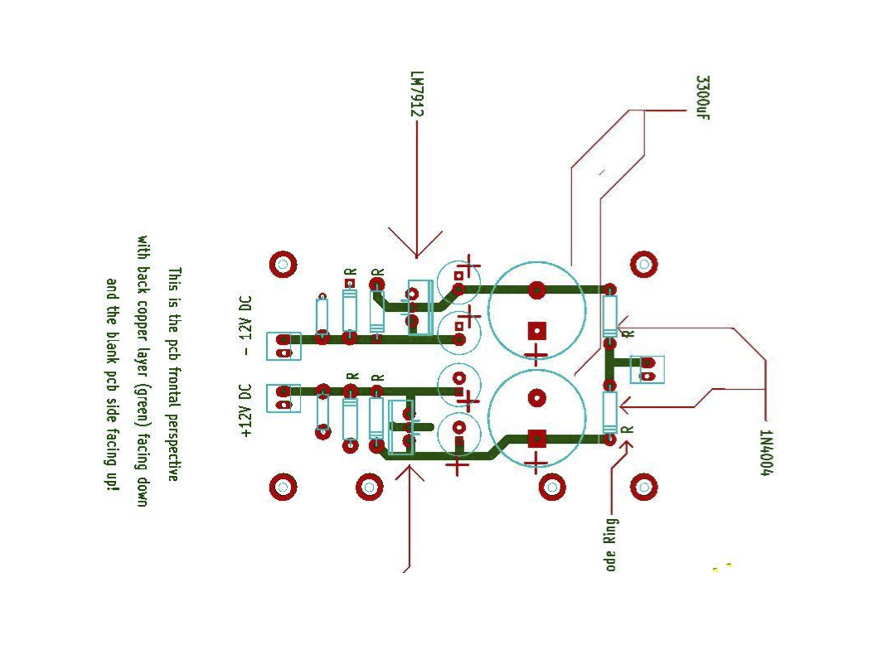

A friend and I worked out a simpler, smaller, one-sided and etchable PCB for the MFOS wall wart power supply for use with the Benjolin.
The Benjolin requires a very small amount of current, so one large cap per rail is enough. In fact, although 3300uF is listed, I have been using 2200uF caps (which aren't quite as tall and fit better into smaller enclosures) with no noticeable difference. Large caps should have 7.5mm lead spacing.
Resistors are 2K4 or 2K2, only to provide small load so that the PSU output can be measured without hooking it up to your Benjolin. Small caps are 1uF tants, diodes are 1N4004 and voltage regulators are LM7812 and LM7912. Circuit is fed with a 12V AC wallwart and outputs +12V/-12V DC. Pls ignore the "R" markings for the diode ring and use the markings on the drawings of the diodes themselves. See the MFOS site for full details.
Here is the copper (not mirrored) and parts overlay. Board size is 51mm x 78mm, PNG is at 150 DPI. You should know what to do with it from there...

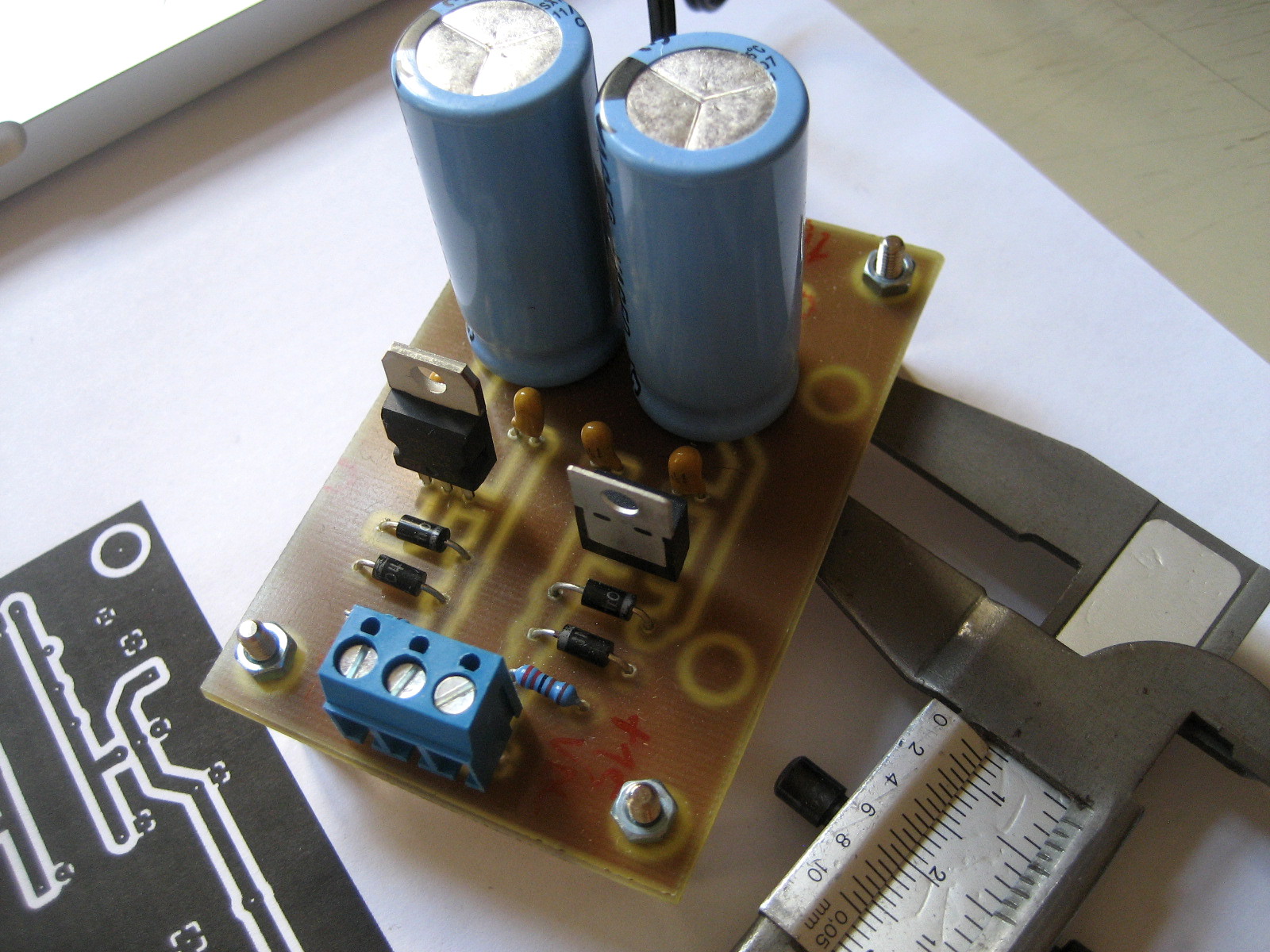

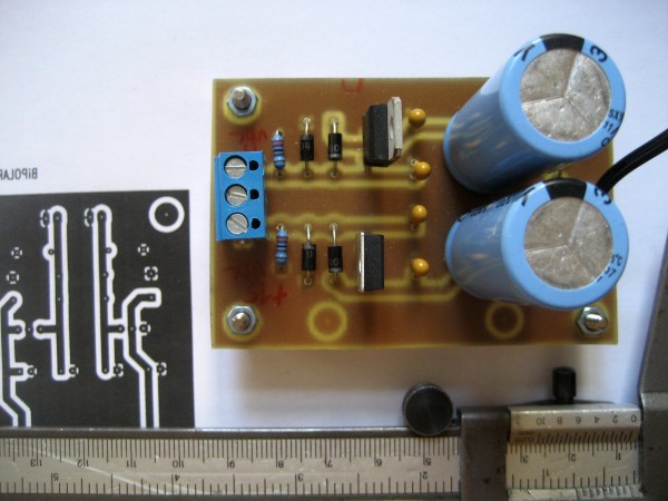

Photos of completed PSU with 3300uF caps.... they are 40mm high, and the 2200uF ones I found (Panasonic NHG 2200UF 35V) are only 26mm high. Makes a huge difference!
