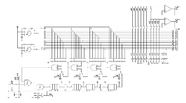

Ok here's what i got sofar, it's more of an idea then a full circuit.
I started out by trying to combine the 4015 waveshaper with the shiftregister/XOR semi-random generator
(need another name for that). But as it turnes out those 1 stage shiftregisters in the 4006 are important
for a semirandom effect. so I went back to using that one. The downside is that the 4006 doesn't have a reset pin
so I don't think I got a saw out of it, but I was able to get the triangle wave. However what kind of wave you
get varies on whatever is currently in the shiftregister, and at one point I had a circuit that created and repeated
a new sequence/waveform everytime I flipped a switch (could also be done with an external signal).
I first drew out a couple of schematics and then combined those to get the monstrosity you see below. Instead of
using just a couple of switches to get a few options, I decided to go for 12 step switches (those things above the
XOR gates). which can give you a lot more options. A lot of them can produce the same result, again
depending on what's in the shiftregister when you switch, this also makes it very unpredictable (unless you're a
genius with boolean logic).
This is all fun offcourse but sometimes you want to be able to repeat a setting. For this reason I added the
circuit with the 2 NAND gates and the 1/0 pushbuttons. With these you can force the input of the shiftregisters
(the blocks at the bottom are the shiftregisters of the 4006) high or low. Forcing it low for 18 clock cycles
will empty it completely. and depending on the settings of the switches it will be filled in a certain way.
You can set it so it will just cycle the bits you add manually, which can create the triangle.
I also added the options to insert bits to the XOR gates, so you could hook up a 4040 to this or whatever you want.
For now I made 2 oscillators with the leftover NAND gates, one slow the other fast, so it can produce LFO or audio
frequencies. One thing that might not be clear, the double circles are external in/outputs, the single ones are
internally connected, since it would get very messy to draw all those connections.
I am thinking of replacing the set of 4 resistors with a R2R which I did a quick experiment with and is
indeed a lot more fun. But,..
I think this circuit would be most usefull in a lunetta modular system and in that case I would opt for
seperate R/2R ladders and resistor mixer modules. So maybe leave that part out alltogether.

Joined: Nov 10, 2011 Posts: 878 Location: Lancashire, England
Posted: Mon Jun 04, 2012 5:21 am Post subject:
That looks so good and so much easier to understand It seems like the idea has really coalesced into something very neat and tidy and functional, I look forwards to a demo _________________ As a mad scientist I am ruled by the dictum of science: "I could be wrong about this but lets find out"

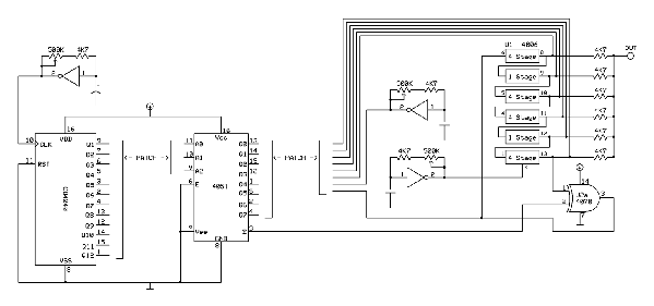

CMOS Waveshaper + 4040 4051 test Subject description: The saga continues
I tried to make it look not too complex, it's probably not even that hard to wire up, just a lot of it
(ribboncable and PCB connectors can take care of some of the work)
But I'm probably not gonna build it anytime soon. If I do it will be a module part of a bigger system,
and I have enough things to finish as it is to start on another (big) project.
I did however do another test. I used one XOR with it's output connected to the input of the waveshaper,
and one of its inputs to the last ouput of the 4006. I noticed that by attaching the other input to different
outputs of the 4006 I could get what sounds like different notes. So I hooked up a 4051 controlled by a 4040
to create a melody (if you can call it that). I think it actually works kinda similar to 4017/4051 melody generator
and a PIC experiment I just did)
I'm still cutting up the recording but I've posted the first cuts here
and here's a schematic which shows what I did, or at least part of it,..
Filesize:
51.33 KB
Viewed:
1592 Time(s)
