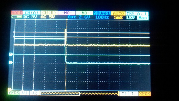

To re-explain, my attempt to get trigger outs is pretty simple. gate AND clock with a 4081.
The problem is, the gate drop is slow enough relative to the clock that I always get a tiny trigger pulse on the trailing edge of the EDIT: gate, not trigger. If I have the gate switched off for two steps, the second step doesn't pass a trigger. But of course that's not how I *want* it to behave.
My guess is that I could put an appropriately sized cap to ground on the trigger line and it would filter out that tiny bump without introducing too much slew, but I'm not sure how to figure that. The bump is less than 1ms, and a typical trigger is about 8ms.
Any advice? I'm trying to work out the math with a simulator....
Blue is gate, yellow is trigger

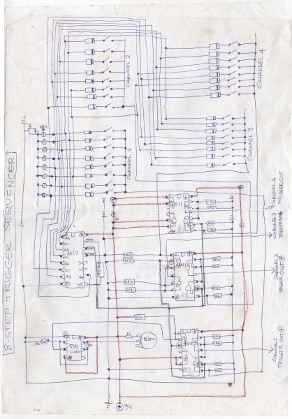

PostPosted: Wed Mar 06, 2013 11:43 pm    Post subject: Reply with quote  Mark this post and the followings unread
Actually I'm wrong, I did rewire this pretty significantly, I forgot that the 555 was doing a negative going pulse....
First schem is my current config, second is what I'm proposing, except I'm not sure what values to use.

PostPosted: Thu Mar 07, 2013 6:52 am    Post subject: Reply with quote  Mark this post and the followings unread
I think minus' idea about inverting the CLK for the 4017 sounds like a possible solution. I probably would never have thought about it myself
but it does make some sense. Assuming you mean you only invert the CLK for the 4017 and AND the gate out with the un-inverted CLK.

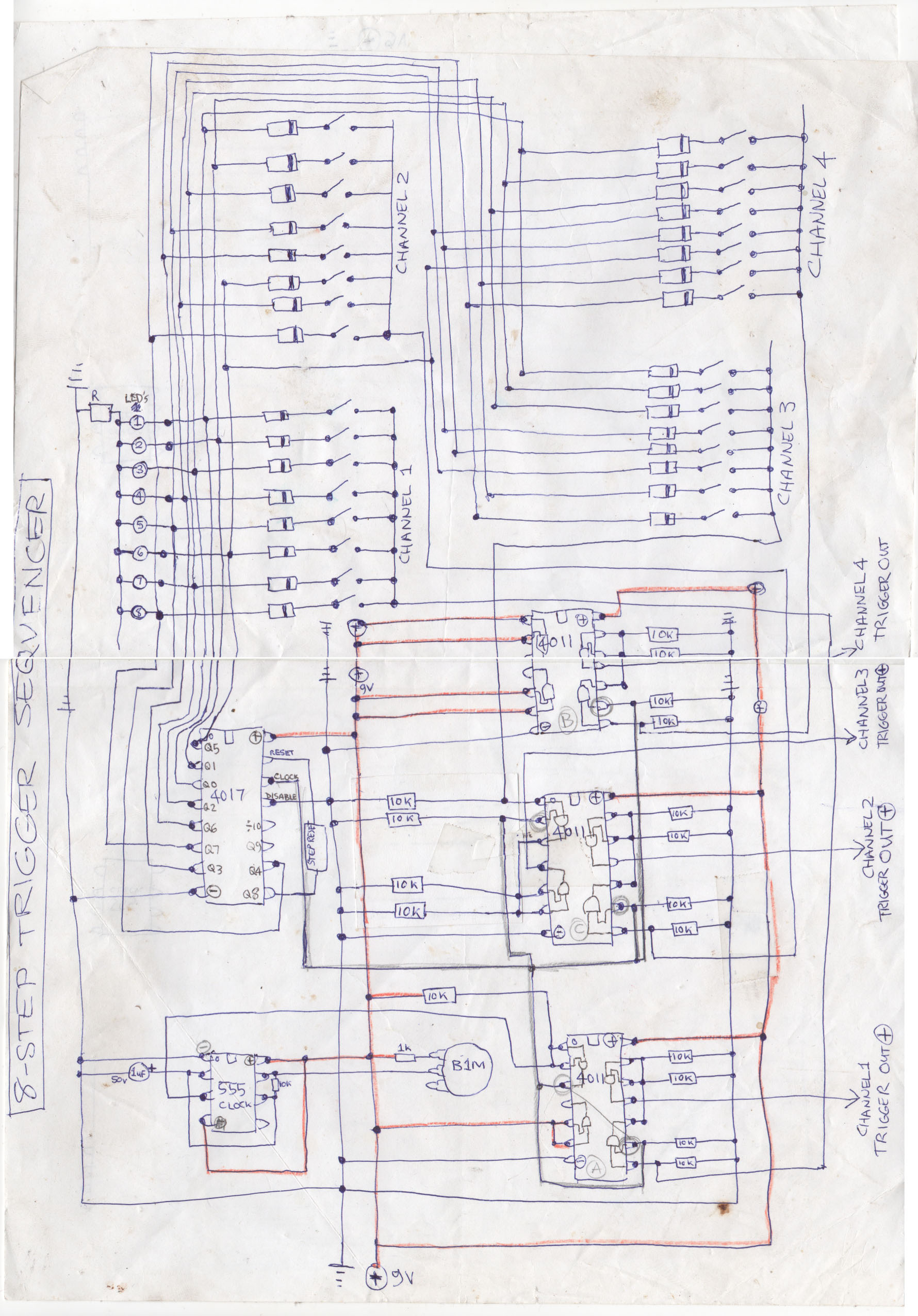

Reading back to an earlier post I assume you are trying to obtain a trigger out of sorts.
I inverted the clock with a 4011 NAND and I clocked the 4017 with this signal. I then used AND from NAND to create short triggers using the clock I had inverted and the step/gate outs of the 4017. I found that inverting the output from pin 3 of the 555, I obtained a much shorter pulse.
Here's a very old drawing of what I did when I made a trigger sequencer. Yes it's confusing.... Laughing ... but it works, even without decoupling caps!

PostPosted: Thu Mar 07, 2013 8:55 pm    Post subject: Reply with quote  Mark this post and the followings unread
The only difference I can see in what you're doing vs what I'm doing is that you're using NAND gates, and I used a transistor inverter and an AND gate.
I *am* confused by all the 10k pull ups and pull downs on everything though Smile

PostPosted: Thu Mar 07, 2013 11:44 pm    Post subject: Reply with quote  Mark this post and the followings unread
Well I'm equally confused by that Laughing . So you are inverting your clock, sending that to the 4017 to clock it, and AND-ing the 4017 output with the inverted clock? Strange it isn't working. That sequencer I made certainly works. I still use it to test things as I haven't yet replaced it.
It's very odd what you are experiencing. Not sure what to suggest. One of those Ken Stone Gate to Trigger circuits would perhaps clean this up would it? I've built a few of them and they work well...
