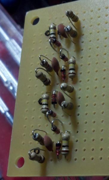

In that circuit, the Comparator is just there to square up the pulse, correct?
I think I'm going to try the following idea, one conditioner per gate (which doesn't have the common gate bus being a constant voltage problem) with the exception of the comparator, each one going through a diode to a common bus which is THEN squared up by the comparator.
Yes, it's brute force Smile But at this point if it works, that'll be sufficient.
 Filesize:  1.83 MB
 Viewed:  914 Time(s)

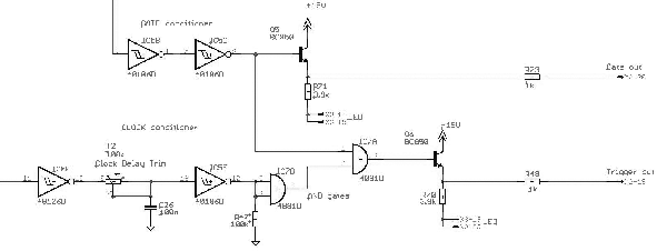

sorry, if i tell you things that have already been covered, i just did not read the complete thread.
so this is what i did to get triggers from a 4017 sequencer:
i just used an AND gate to combine the gates from the 4017 with the incoming clock.
unfortunately it was not that simple, since sometime double triggers occured. this was due to the propagation delay of the ICs used for the actual sequencer.
so i added a delay to incoming clock right before the AND gate to get rid of this.
below you see the schematic of what i currently have (4017 gates from above, original clock from left). BTW you might get away with just one AND gate, i think the 1st one with the pull down resistor is a leftover from earlier stages of the development. it might not be needed (but hey, there are more than just one AND gate on these CMOS ICs anyways...)
 Filesize:  98.8 KB

Delaying the clock seems like a viable solution to this. I'm sure it will assist others who face this problem. Thanks for enlightening us Fonik. Very Happy

I'll give this a shot. I also came up with a neatly symmetric way to put the trigger conditioning from Ken Stone onto stripboard in a compact fashion, but I could do with not using up all those diodes....
Is there anything special about the BC850? Or should I be able to get by with any of the various NPN transistors I have?
PostPosted: Sat Mar 09, 2013 7:49 pm    Post subject: Reply with quote  Mark this post and the followings unread
Hurm. Conditioning the gate actually *extends* the drop off, for me.
I can see the clock delay (though I had to increase the cap to 220nF to get it to a point where there was almost no overlap...possibly a bigger trimmer would have done it too though). But I was still getting double triggers, even putting the gate back to directly into the AND gate.
But... As soon as I placed my scope across the gate to ground, suddenly the problem went away. SO I put 100K from the gate input into ground, and now it's working.
So maybe all those pull ups and pull downs are why yours is working, minus Very Happy
To be clear:
What's working is a clock delay per Fonik's schematic, gate directly into the AND with 100K to ground at that point.
Now I just have to get this onto the stripboard--shouldn't be a huge problem, there's space left Smile
I'm just a little disappointed I didn't get to use my fancy trigger conditioning though Razz
4 trigger conditioning circuits into two common busses (which would have been joined into one had I completed this). Thankfully, none of that is actually soldered in, I was just trying to see how well it would fit....
 Filesize:  108.73 KB
 Viewed:  885 Time(s)

Excellent news! Very Happy I might have to do a stripboard diagram at some point for a trigger sequencer.
I've been thinking about building the Thomas Henry Superseque for some time. I'll probably incorporate this valuable research into the design so I can trigger drums too.
I think those pull down resistors were a result of too much time in the Lunetta forum. Laughing The resistors I have on the CLOCK input to the NAND gates aren't needed, but maybe the ones coming from the switches are. If the switches in a channel weren't turned on, then surely the NAND input would be left floating? Doesn't matter. It's only a few extra 10K resistors. I'll know where to salvage some from when I run out in the middle of the night!
Anyway, glad it's working for you!
PostPosted: Sat Mar 09, 2013 8:49 pm    Post subject: Reply with quote  Mark this post and the followings unread
And there you have the whole problem in a nutshell. DUR.
Yes, on a step where the gate switch is open, I'm guessing that the diodes on the other connections basically leave the input floating. So of COURSE it is able to let the clock through. As I was testing all this, there were times at other points in the circuit where I'd let an input float and it was always letting the other side of the AND or NAND through at that point.
So I have the 40106 and other circuitry safely ensconced on my stripboard, albeit somewhat ugly thanks to it being added on. And I had to tweak the trimmer for 9V rather than 15V operation. but other than that, it's beautiful.
Thanks very much to you and Fonik for your help Smile

BTW i had not tp use a pulldown at the AND for the 4017 gate, since in my design the hardware toggle switches are replaced by CMOS switches anyways...
