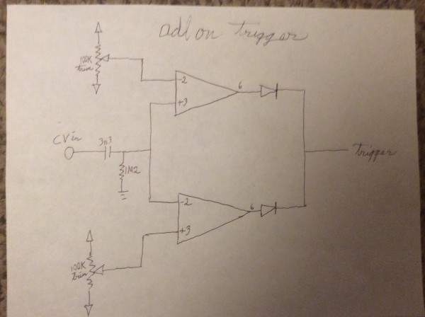

So, experimenting with the yousynth schematic on here has led me to try to add basic trigger to the original schematic that has grown along the way.
Looks like it should work

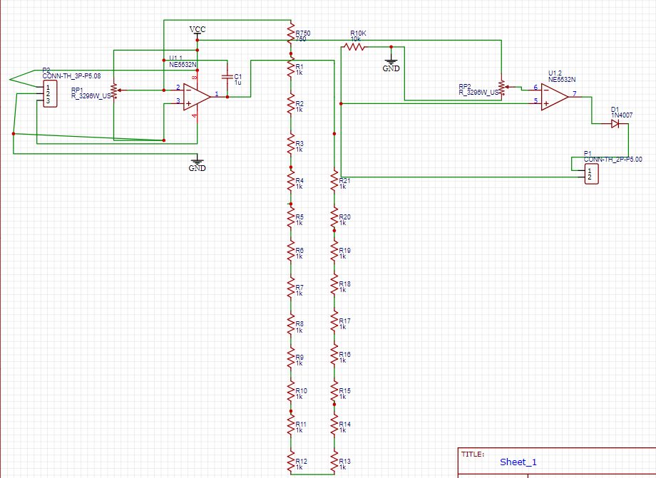

PostPosted: Tue Jun 07, 2022 12:03 pm    Post subject: I wanted to use your circuit for making a stlylophone Reply with quote  Mark this post and the followings unread

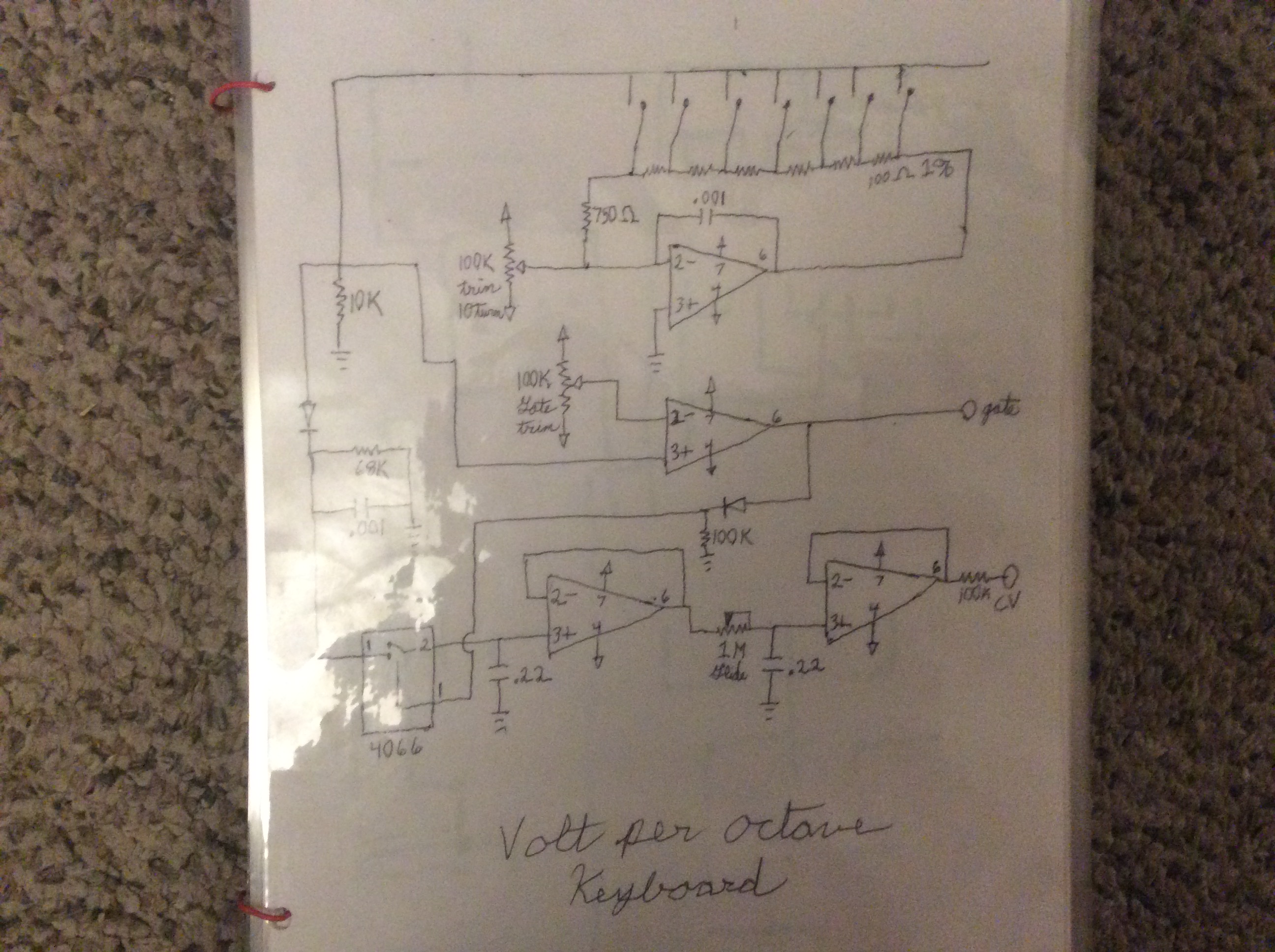

Cfish wrote:
Just in case anyone else was looking for something similar. This is what I finally got working. I'm sure I didn't invent in, but I sure couldn't find an easy solution that worked when I built it.
This works on my bass pedals and a 2 octave keyboard project I did.
(Update) when I tried this with a TL072 it caused an issue. I believe the heat caused by the comparator/gate side of the dual opamp caused a temperature drift issue in the voltage control side of the IC. I couldn't keep the span in adjustment.
(Another update) I have used this circuit all winter long in a set of bass pedals and a 2 octave controller with no problems. Turns out the radiant heat in my house is very stable at 72 degrees. Spring is here and the house got up to 78. And the span drifted substantially.
I have ordered some opamps with better drift ratings to try. I will post back with results.
I have high hopes for the OP177 op-amp. At first glance it appears it may go right in the IC socket and has much better temperature drift ratings.
I spent a couple of hours fighting that new TL072 circuit before I finally realized I wasn't trying the other circuits when it was that warm in the house.
(Update) OP 177 opamp cleared up the temperature issues.
Great thing is you can build this with IC sockets, try it out with TL071's, or something you have, and buy the pricier OP177s if you need the accuracy.
I believe the OP177s were about 2$ each American at Digikey.

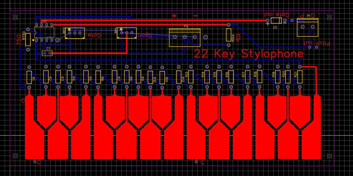

I used a single TL072 because I don't need to much accuracy and I could change it with two TL071s if needed. The keyboard has 22 keys, I solder plated them for protecting copper. Only problem is I can't get it tuned for outputting positive voltages. It can be tuned for negative voltages and I can get 1V per octave but it gets closer to zero from -8 for example from right to left. I wanted to ask if that was normal or I messed up with my PCB design. Positive voltages require me to turn the pot to almost one side and I don't get much range. Also the Op Amp requires +/-12V right, if I only use 12V positive and ground the negative input I can get positive voltages set but can't get accurate results between notes. I can also share .gerber files for anyone interested.
ignore the easy eda glitch at the negative voltage connection of the op amp. I used a sire to connect it to the connector.
