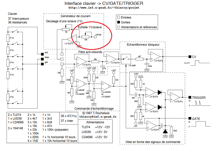

PostPosted: Thu Oct 27, 2016 4:09 pm    Post subject: Reply with quote  Mark this post and the followings unread
Thanks grumble
I know the LM3399 is a comparator IC. I'm trying to understand if there is a good reason to use a designated comparator, instead of just using an opamp.
Not just in this schematic, that was more of an in general question.
I'm sure the much more educated person who designed this circuit had some reason for choosing the LM339. I'm just trying to figure out what that reason is.
Seeing the circuit is a dual power supply circuit, having a single supply comparator is not an advantage that I am seeing.
Im sure once I have built it as drawn and experimented with it, it may become clear.

PostPosted: Fri Oct 28, 2016 12:28 pm    Post subject: Reply with quote  Mark this post and the followings unread
I think grumble was pointing out that if the resistance acros the switch
Is greater. Lowering the value of the 4k7 would make the total resistance the same as design.
Starting at the switch. ( the switch makes contact when there is a gate signal from a key press) the tone signal passes through the switch, through the 4k7 and charges the capicitor to ground to the corisponding voltage. The opamp is then acting as a buffer.
When a key is released the switch opens, but the charge of the capicitor holds the reference voltage to the output opamp. So the opamp continues to output the voltage of the last key pressed. (Sample and hold)
The output opamp buffer setup I believe is called a unity gain follower. No gain is achieved from the opamp. However adding resistance before it will reduce the span of the output.
I have played with the beginning of this circuit already and it can produce close to 2 volt per octave of shift. So it shouldn't be a problem to leave the 4k7 as is.
There seems to be plenty of adjustment there already to take care of it.
Posts: 1320
PostPosted: Fri Oct 28, 2016 2:41 pm    Post subject: Reply with quote  Mark this post and the followings unread
That is part of what I meant: The capacitor is charged and discharged via the 4k7 resistor, the R-on of the 4066 (or 4016) and the R-out of the opamp, and because all the resistances are in series (added), the charge/discharge current of the capacitor is limited by this resistance, resulting in a slope of the voltage at the output of the follower. So not the span is limited by this resistor, but the slope!
Like what is used when you build a glide for a control voltage, there the slope is intentional

PostPosted: Sat Oct 29, 2016 5:26 am    Post subject: Reply with quote  Mark this post and the followings unread
Thanks grumble
Your knowledge is greatly appriciated.
I am however curious as to why you would want to induce any slope at that point.
The 10k and what looks like 4.7n between the 2 buffer op amps before the switch, would slow the voltage change, to give time for the comparator to close the switch. (Same problem I ran in to trying to add sample and hold to other circuits)
I'm missing why you would want additional slope after that.
There is almost always a reason I am just overlooking.
Would appriciate any input on this
Posts: 1320
PostPosted: Sat Oct 29, 2016 11:45 am    Post subject: Reply with quote  Mark this post and the followings unread
I don't want to induce a slope, the 4k7 resistor together with the capacitor following that create a slope and I thought that you want the same slope as the original schematicks where they use a 4066

PostPosted: Tue Nov 08, 2016 12:25 pm    Post subject: Reply with quote  Mark this post and the followings unread
thanks Grumble and Cfish !
do any of you have an idea as to how rise the voltage from -12 to -10 volts in the highlighted section ?
i ve been thinking to employ a voltage regulator with a LM 317. is it gonna make the job? cheers ! Cool
voltage regulator needed
 Filesize:  46.94 KB
 Viewed:  724 Time(s)
Posts: 1320
PostPosted: Tue Nov 08, 2016 1:12 pm    Post subject: Reply with quote  Mark this post and the followings unread
Hi Alan,
You need an LM137 or LM337 or something like it, those are neg. voltage regulators.
But maybe those are not stable enough, so you should probably look into negative voltage reference circuits.

PostPosted: Tue Nov 08, 2016 4:42 pm    Post subject: Reply with quote  Mark this post and the followings unread
Hi Alanwilder81
I'm not sure how steady the -10v reference needs to be. But a 100k trimmer with the outer legs tied to ground and -12v then sweep the trimmer till you get -10 out the center leg. Quick adjustable voltage divider.
Will get you a -10 reference untill you can get the right regulator
Not sure what the current draw would be there seeing it is not just reference voltage for an opamp
Posts: 1320
PostPosted: Tue Nov 08, 2016 4:59 pm    Post subject: Reply with quote  Mark this post and the followings unread
Current draw depends solely on the position of the wiper of the Echelle/1v per octave potmeter since the - input of the opamp following this potmeter is at virtual gnd level.
A better solution would be a resistor of say 10k with a trimmer of 5k of which the runner goes into a buffer which is set to output -10volt.

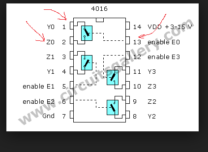

alanwilder81
Joined: Sep 03, 2016
Posts: 310
Location: italy
PostPosted: Tue Nov 08, 2016 11:27 pm    Post subject: Reply with quote  Mark this post and the followings unread
sorry folks for another dumb question, but bear with me, i've never used the CD 4016 nor CD 4066. i attached the 4016 pinout diagram below.
In regard to the keyboard circuit,should i connect the pins 1,2, and 13 ?
as well as the pin 7 (ground) and pin 14 (positive)
thanks !

Posts: 1320
PostPosted: Wed Nov 09, 2016 1:19 am    Post subject: Reply with quote  Mark this post and the followings unread
alanwilder81 wrote:
what does reference voltage mean ?
Using opamps and power them from say an LM7805 that's totally exceptable, even if the voltage coming from the LM7805 is (kind of) noisy, temperature dependent and not really accurate in terms of absolute voltage because an opamp has what is called a Power Supply Rejection Ratio what in short means that variations in the supply voltage wil cause a minimal effect in the (amplified) output voltage, this is usually expressed in dB.
But if you want to use this voltage as a reference voltage in e.g. a Digital to Analog Converter where the output voltage (or in the above posts where the accuracy of the 1V/oct circuit) behavior depends on the accuracy of this voltage you need a more constant, noise free and accurate voltage.
If an OUTPUT voltage of a circuit is REFERRED to a (constant) input voltage, this is called a Reference Voltage.
Compare the datasheet of a REF02 (5v reference circuit) and the datasheet of an LM7805 (5 volt power supply IC)
Posts: 1320
PostPosted: Wed Nov 09, 2016 1:22 am    Post subject: Reply with quote  Mark this post and the followings unread
thanks !
This is correct! Be sure to keep the voltage to pins 1 and 2 within the power supply voltage (between pin 14 and pin 7) or else the switch will behave very nonlinear.

Hi alanwilder81.
Yes, you hook up the power and ground pins 7 and 14 on the switch IC.
