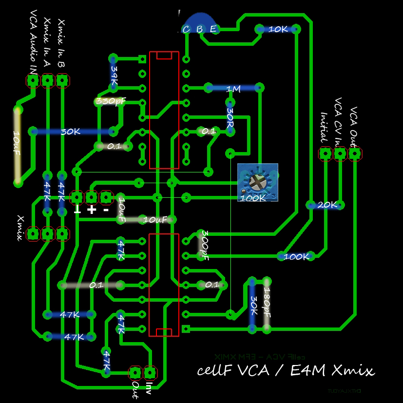

This is Xmix and VCA from CellF NLC schematic , prolly the same Sims VCA posted here , in aaddition to the vca i added the xmix 2 channel mixer from wildcat from EFM , pcb is tested and working , should work prolly better on 12V and the VCA performance is so-so ..comparing to other VCA's i've built , so i don't know why i share it when it's not the best vca , i built it so here it is

Can anyone help me identify the IC's on this layout? Itching to get etching!
I have looked at the schematics referred to but they are the basis from which Vladosh has tailored the circuit himself.
Are these LM13700 and TL074?
Thanks for your help Very Happy

yes the IC facing down is TL074 ,i've built this VCA but was not so happy with it ,there were some clicking ,maybe because it was designed for 12V and i used 15V ,it's working but i like MFOS vcas better

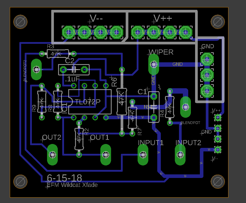

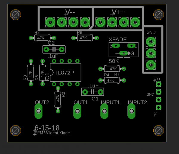

Hi again, I whipped up an eagle design for this.
As I said, it's not tested, but this is one of those "I can't see why it won't work" situations.
The ZIP file contains eagle 9.x brd and schem and the gerbers.
If anyone actually prints up the gerbers let me know if it works and I can make adjustments. I may run this the next time I do an easyeda run (it'd be $5 for 10 boards...) and if I get it working I'll post.
About the quickee layout: The xfade pot is 50K linear and to make this faster to conjure up in eagle I used a trimmer package, but you won't want to use a trimmer in real life, instead please solder your 3 pot wires to there (or you could wire in a VCA that passes DC if you want to "automate" this).
I could also do an eagle variation that uses a PCB mounted pot (you can get these cheap from small bear but it assumes certain front panel space requirements that may not work for you) if there is interest.
I image all the 47K resistors and 50K can be any value but should all be matched to at least 2% or better except the pot. Just a guess.
